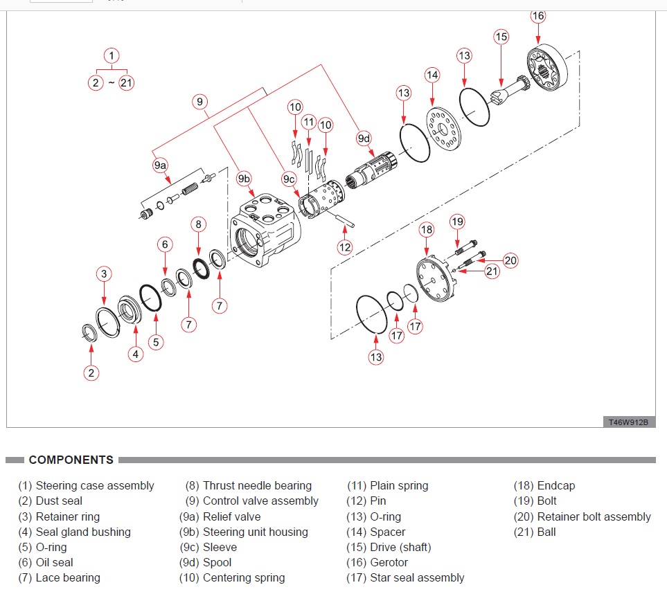

Thank you so much for your advice. I lost about 2 gals. of fluid traveling back to my garage to take the tractor apart. I got the steering column out by removing the steering column support. It looks like you are correct about the replacement of the seals on the power steering unit. The steering shaft assembly looks like it has been holding water for years and eroded some of the steel inside. The grease was solidified and there was only some remnants of ball bearings.
I'll pull the power steering unit out and, I think I will try to rebuild what looks necessary. I have a shop manual on CD for the DK 35 & 45 tractors but it there are no parts breakdown. Do you know of a place on the web I can download it? Thanks again.

But for the sake of helping a bit, heres a screenshot of the steering pump, exploded.
