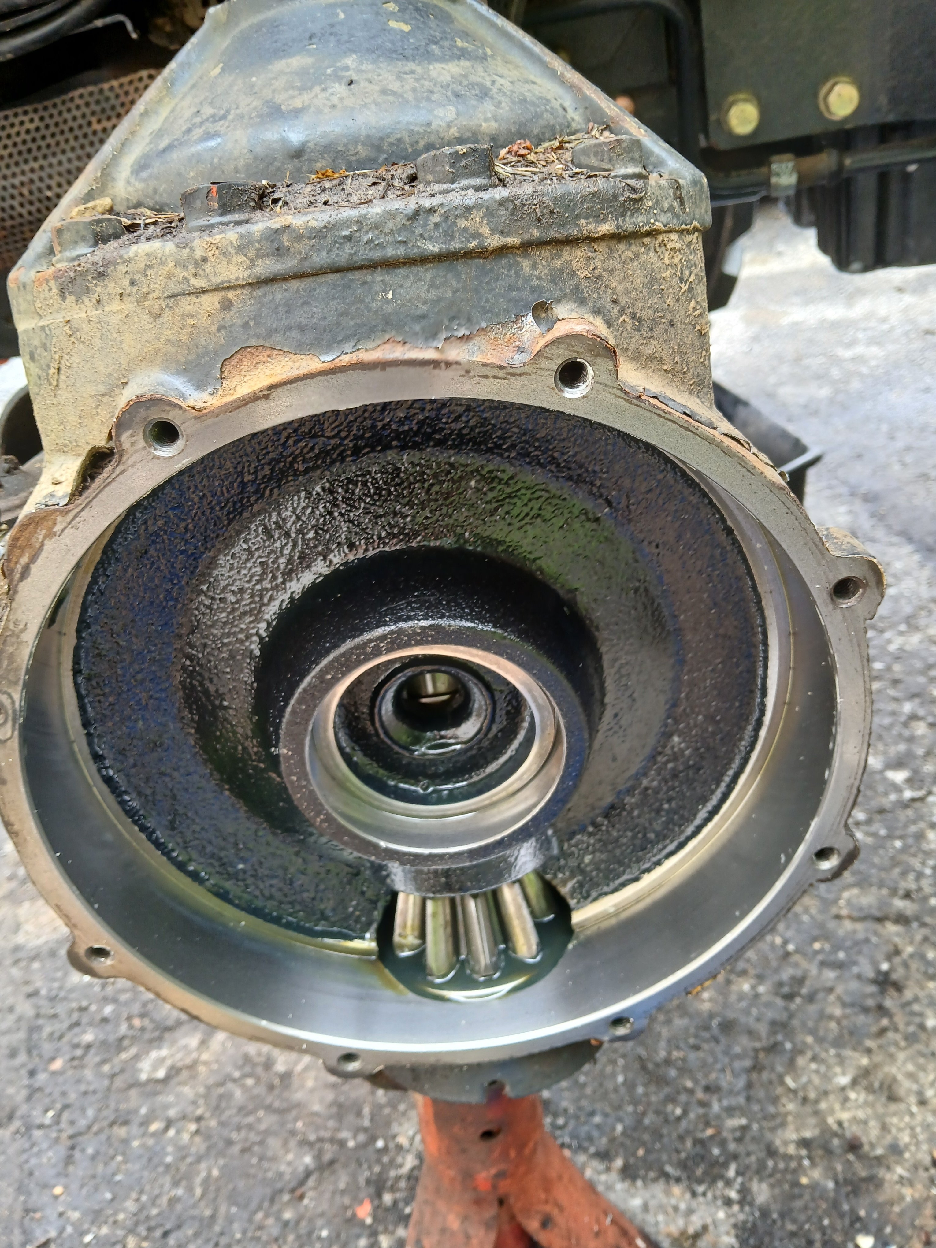

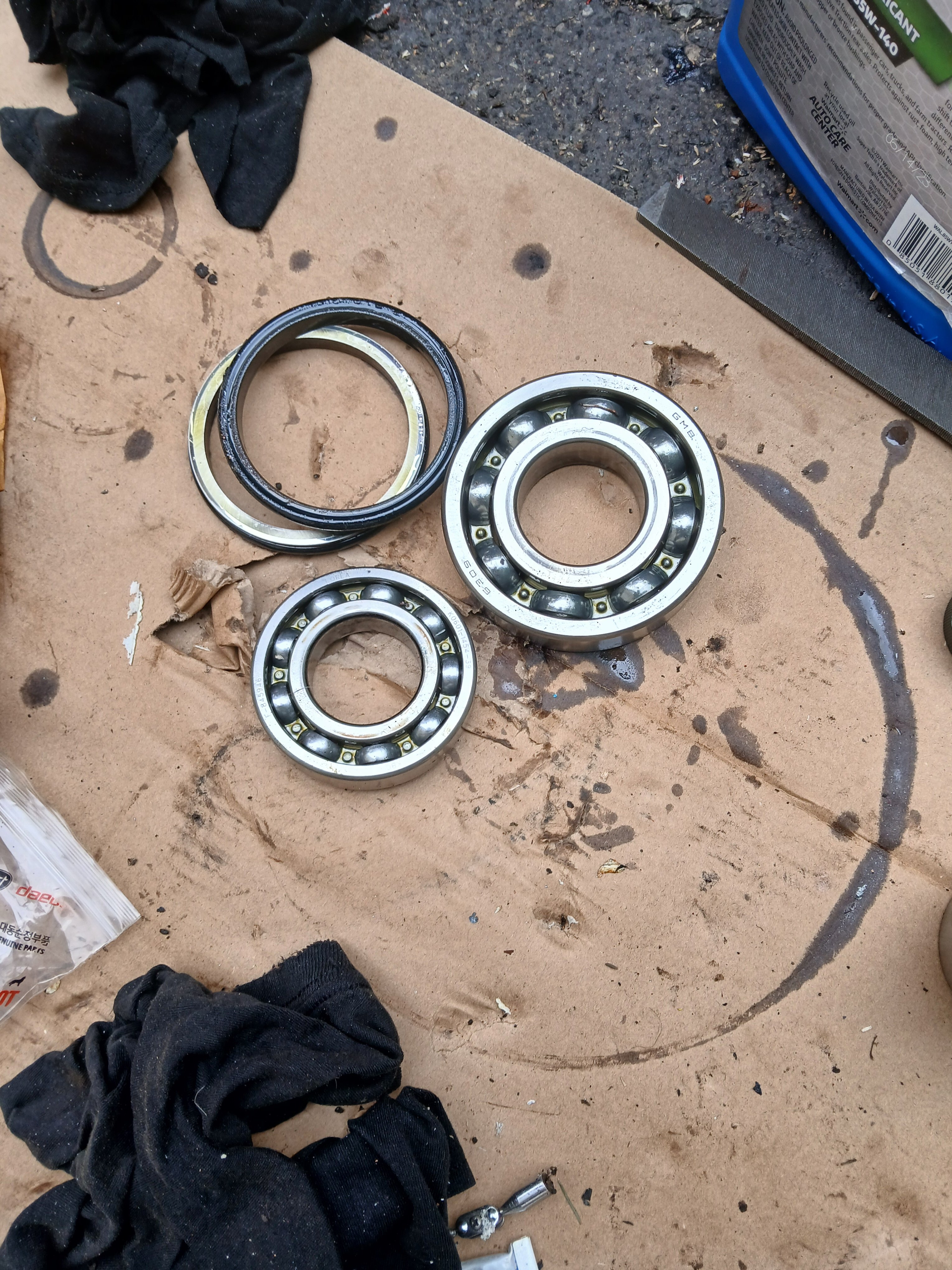

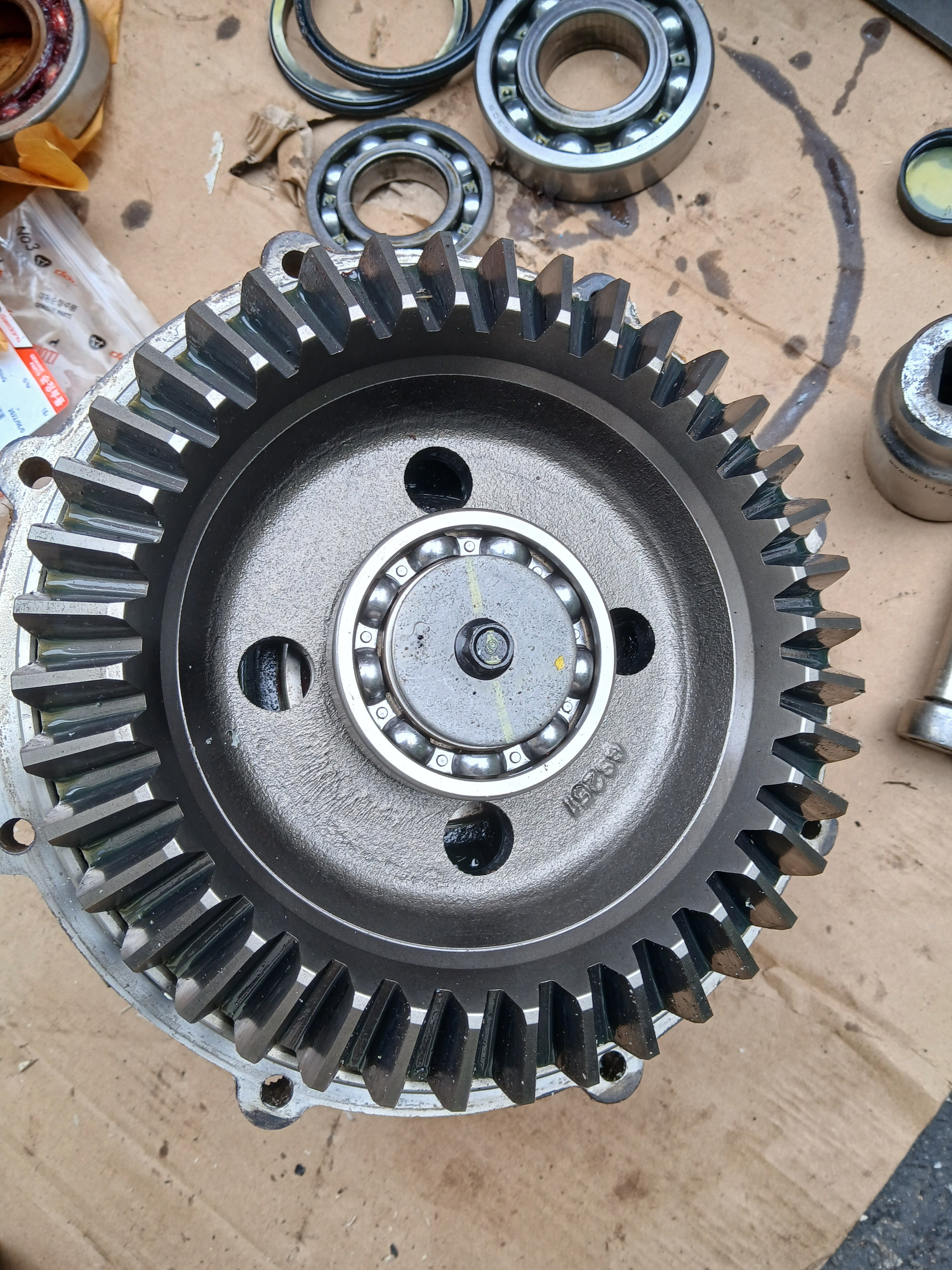

I have had a slightly weeping left front wheel seal for about a year on my NX4510HST that has 1765 hours on it. When I say weeping, that is what I mean. That wheel had no bearing play in it at all. I ordered up all the parts and changed the left side only for now. The bearings had no play in them when removed. This was a simple swap out the bearings and two seal halves and install the assembly. I'm not sure as to why a wheel with no up and down play would leak at the hub. There is a common bearing that you can use instead of the high priced Kioti bearings. I believe the outer is a 6309 and the inner is a HC6208. I will have to check to be sure if anyone wants to know. These bearings are deep groove bearings. I found two new SKF 6309's on Ebay for just under $40 shipped. I found two new Kioti inner bearings on Ebay. One was just over $50 shipped. The other was $23 shipped. The seal kits were $186 shipped. Total cost was less than 50% of dealer parts.
