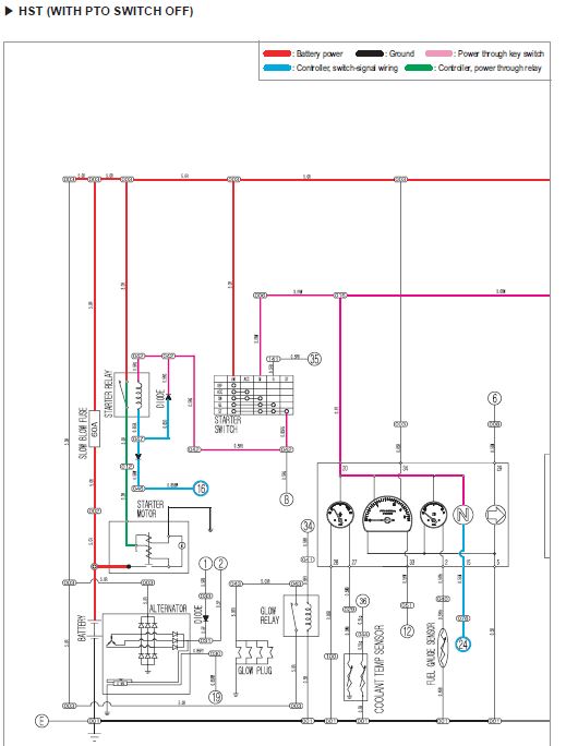

Look at these pictures. and get back with us.

Negative, there is a 3 range selector on the left that has to bee in Nuetral for a start to occur. It has a bellcrank on it that rotates a potentiometer that has +5 volts on one side of the pot and ground on the low side. The wiper of the pot that is connected to the bellcrank then sends a varying voltage to the cruise module. The cruise module detects that voltage and decides what position the range selector lever is in. If it is in one of the 2 neutral positions, it will throw a ground out to the low side of the start relay thru a diode.
