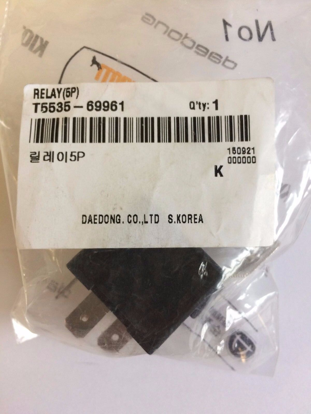

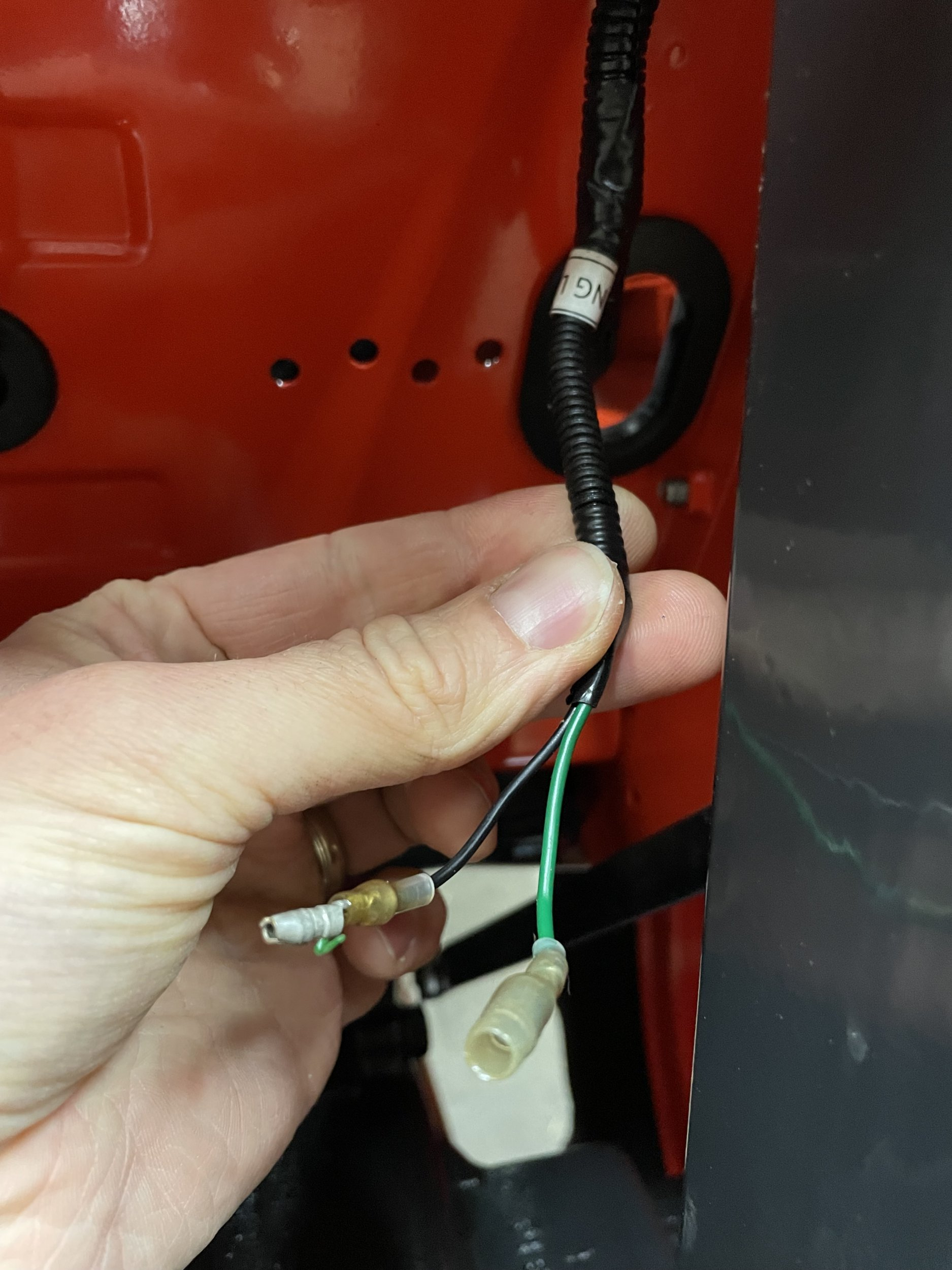

  • There is a set of green and black wires tucked up on the far right and far left at the back of the tractor labeled "work lamps".

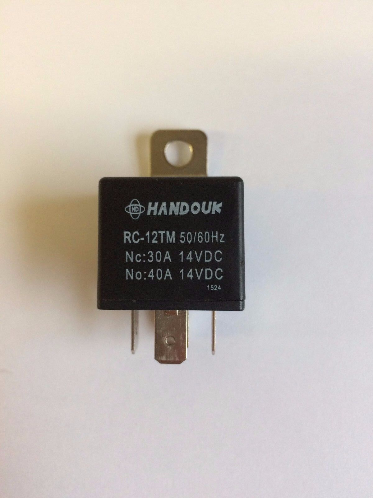

  • These are referred to in the manual as Rear Working Lamp L & R. You'll need a 5 pin relay added to your fuse box per the earlier photos. I didn't confirm but you'll probably need a switch.
  • See photos on the relay you'll need, but any 5 pin should work. I'd just match the 14V rating and get one rated 40A normally open, and 30A normally closed which matches the Kioti version. The Kioti version is ~$25 on Ebay from some of the Kioti dealers with an Ebay store.

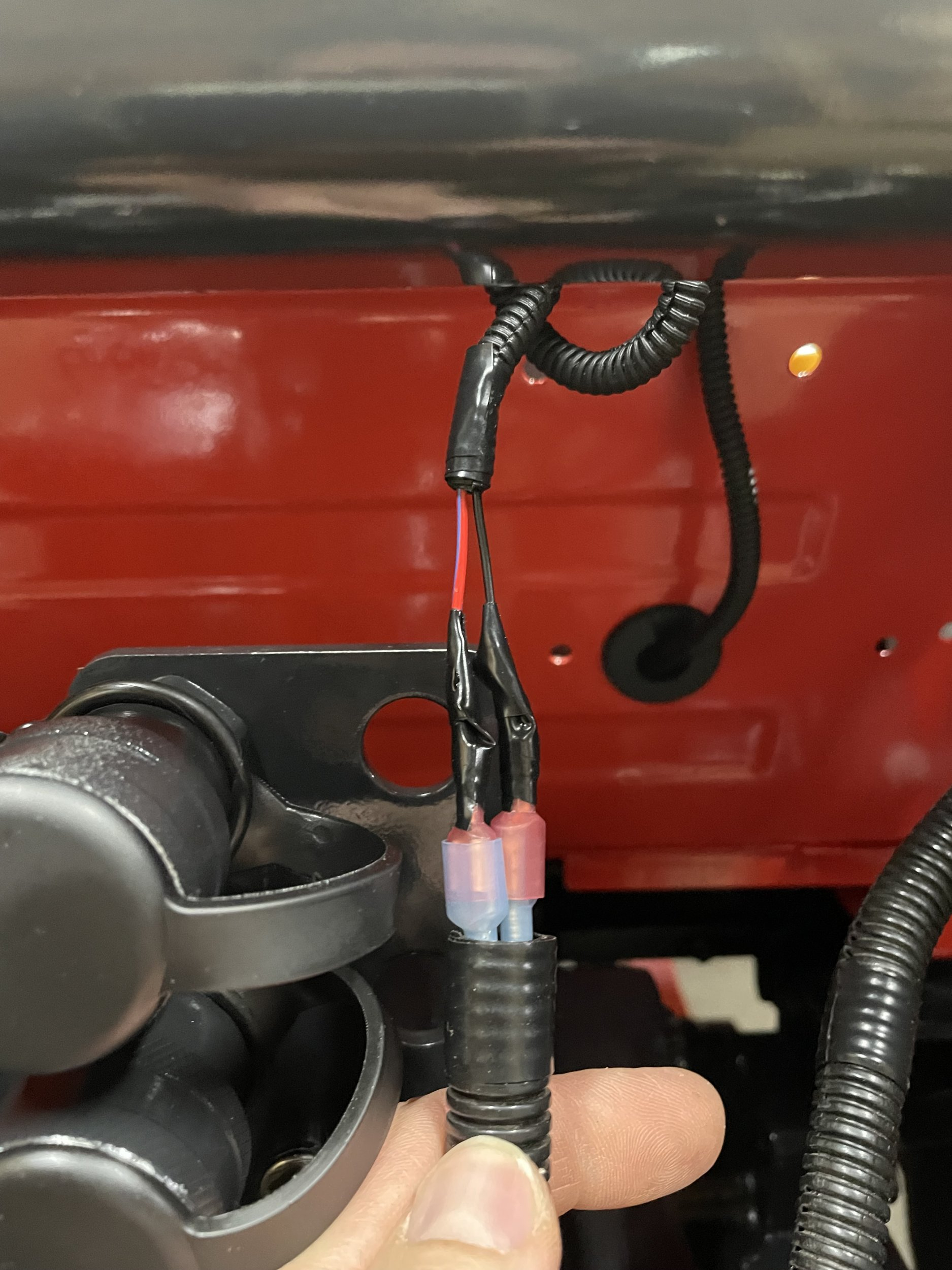

  • There is a set of red/blue and black wires tucked up in the center at the back of the tractor. No label on these, but per the manual they're referred to as Front Working Lamp.
  • You do not need a relay for these. They are energized with key on.
  • My light bar is mounted on the ROPs, so I ran the wiring up the inside of the ROPS with cable ties.
  • I added a switch on the wire run up ROPS bar. It's not mounted to the ROPS, just lies against the bar with cable ties. I didn't want to drill the dash or anything. Search for inline switch if interested. I found a wire harness meant for a 12V sprayer tank, and just cut the end connectors and spliced it in between my light and these wires on the back of the Kioti.
