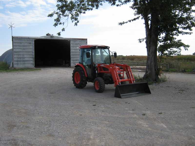

Ok we have 120 hours on our new DK45 cab that is hydrostatic. Its been in for her service at 50 hours with the dealer. As of late the tractor has been a little difficult to operate. I am sure it is just a small adjustment but I do not know where. I am a handy guy and don't really want to bother the dealer if it is a simple fix.
Problem is the tractor just started to be difficult at idle to go into gear. I find that if I just touch the forward peddle it will slip into gear easy. With out touching the peddle the Low,Med,High selector shifter has to be used with great force.
Once in gear even at idle the tractor wants to move in reverse on its own with out touching the peddle. Reverse with great power even at idle. If RPMs are up it will move quite well in reverse on it own. It all so seems to be able to go in reverse faster at full peddle then in forwards at full peddle at the same RPM.
To me it is in the hydrostatic peddle adjustments and I need to readjust for neutral. Can anyone walk me through it with pictures and very good descriptive writing?
Cheers Don.

For some reason your linkage is out of adjustment to say it on the simple side. You might find that there is something internal leaking to have your reverse activated with still having the rest of the transmission in neutral if the linkage is still adjusted correctly. I'd have it to a dealer if you can find that you have no dent linkages or out of place.

It does kind of sound like the linkages for the reverse pedal is too short, perhaps one of the rods did get bent. If no damage, you could try lengthening the linkages by loosening the jam nuts and lengthening a shaft by a few turns. Just don't over do it and forget what adjustments you've made, you don't want to foul it up so badly you can't drive the tractor onto a trailer to get it to the dealer!
   / DK45 Cab hydrostatic. #5
It might be just sticky pivot(s) on the pedal or linkage. Spray all the linkage with some type of good lubricant and work the pedal a few times with engine off then try it before adjusting any linkage.

SSdoxie I am with you on that. It needs to be something simple or that is needed to be adjusted after these are run for a bit. I am thinking that with out front fenders there is dirt up in that area from running the gravel road.

First, don't force it into gear, as you stated you need to do if you don't engage a f or r pedal first. Sounds like you need to inspect, clean and possibly lube before you do any linkage adjustments.
Check the areas under the tractor where something might have caught a linkage, like dirt, rock, stick, etc. Have someone move the range selector, ( H M L) through it's full range, with the engine OFF, while you check to see that it moves freely. There is a neutral lockout 'switch' under the range selector lever, which should not be hampering the range selector movements.
Personally I find my range selector may sometimes not want to go into a particular gear and I let off trying to force it and allow the tractor to coast a few inches forward or backward depending on where the tractor is inclined to want to go via gravity and then the selector will go right into gear, OR I can press one of the pedals and effect the same thing. Your situation sounds a little more complex because of the reverse movement, but not something that can't be solved fairly easily. Check what has been suggested to date and post back results. I also suggest buying a service manual.

The range selector works totally free when tractor is off. Nice and smooth. When tractor running is when it is difficult like the trans is getting pressure from the hydrostat controls. When just easy pressing the forward motion peddle the range selector move gear to gear smooth with the tractor running.
We will give her a good lube and look over and post back. I know 99% of the time trouble shooting is something very very simple.

Well it seems to be much better after hosing the linkage with some WD40. One of the arms must have been hanging and the spring would not return it all the way. With only 120 hours on it I am thinking it has to do with the cold weather and all the new paint on the parts. I think in time it will come around. Put some fluid film on it as well to keep water out and we will see how she comes around. Its a 2012 model so it had to be something simple.
