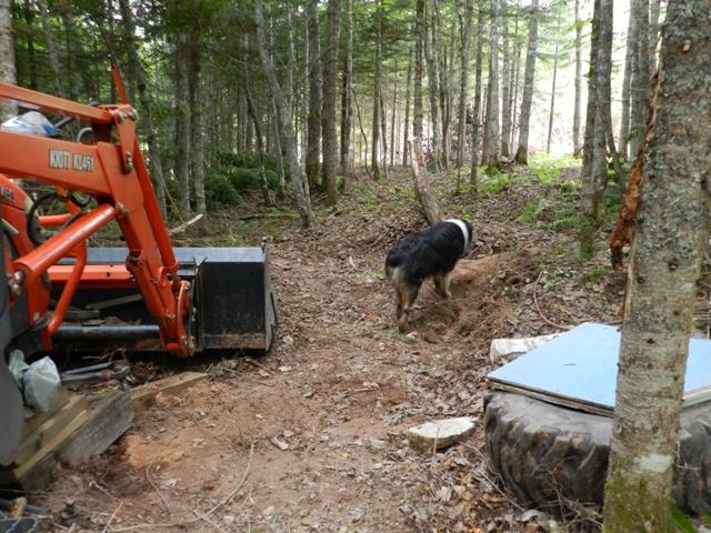

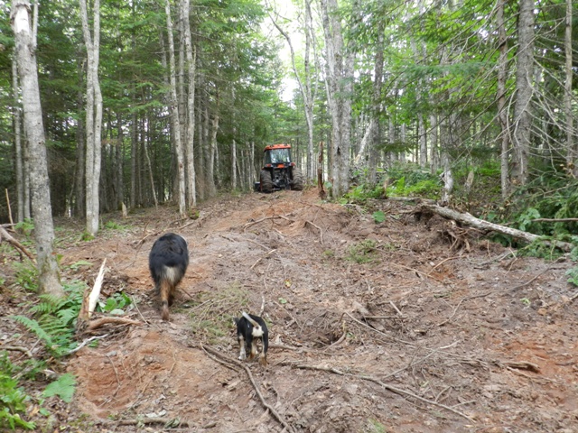

Here is a picture of the trail I was working on:
And in this picture, you can see the tree that defeated me (a maple; the bole is now standing/leaning off to the left and the remaining stump [I sawed off the leaner in revenge!] is just behind the dog):
I have only about 20 meters to go to reach a road on a neighboring property...but you can bet I'll be working more gingerly, and with my fingers crossed,... for the first little while, anyway. I hope to have it all put back together in a week or two, depending on how long it takes to get the parts in.

I've been doing some armchair diagnosis of this failure. :laughing: The trail doesn't look that rough, so I have other suspicions.
Were you trying to push out the tree with the FEL bucket? If so, you are probably in 4wd and pushing and lifting with the FEL while trying to go forward. That would put quite a bit down pressure on the front wheels making it more difficult for the tire to spin in place. If the tire can't break free, or it takes a lot of force for it to break free--the wheel does jerky creeps now and then maybe, then the entire front drive line is under a lot of stress and nothing is giving.
A gear tractor would probably lug down and stall in that situation if the clutch isn't pushed in. I have no idea what happens in a hydrostatic.

Dave, I was pushing on a maple tree. Most of the time, I can push a tree over then start pulling up on the root ball. This one got hung up in a neighboring tree and didn't want to come down. While I can visualize how anchoring both front wheels with lots of extra weight/down force could cause gears to strip, the axle to shear or the tractor to stall, I'm at a loss as to why this would cause the bevel gear case to crack in half. Neverthless, I'd be the last to blame the tractor (I see no evidence of defective parts here); I push it pretty hard when I'm in the woods and can only kick myself (and open my wallet!) when I push past some limit.

Have you looked to see if the housing looks stress cracked or cracked from an impact, say with a rock or similar?

Just saying that is a really high-stress moment. Hard to say if the casting cracked first, or as a result of the parts inside having enough play to put some bind, twist or prying motion on it?
Another poster mentioned having lost both front wheels. Maybe that is a Kioti weak spot, whereas New Hollands tend to break in half around the bell-housing transmission area.

I didn't see any obvious external/impact damage on the bevel gear casing, but it is always possible that the internal stuff broke first; the mechanic suggested the casing broke first and the separation caused the bevel shaft to shear, but I couldn't really differentiate the sources of the clunks I heard.
