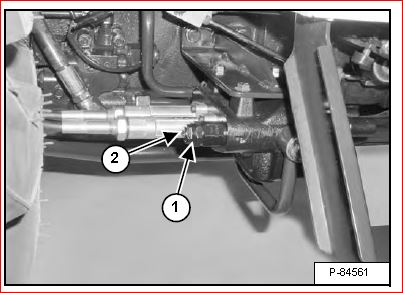

The relief valve is in the FEL control valve by the inlet pipe. It has an adjustment screw with a jam nut. Loosen the jam and turn screw in to increase pressure. Turn it about 1/4 turn at a time then retest pressure until you get correct setting.
Thanks Dennis. I will look around there. But there is not much room to view or adjust if it is located anywhere other than on the bottom of the FEL control valve.
   / DK45 FEL capacity issues? #77
It's on back side/rear of the valve. Easy access.
   / DK45 FEL capacity issues? #79
Perfect. Thanks.
Greg
while you're down there making that adjustment take a look at the metallic pipe coming into the banjo bolt into the side of the valve. This summer I have that bolt loosen up and I lost a couple gallons of fluid in a couple seconds that's the feed coming from the pump check it out And put a wrench on it.
