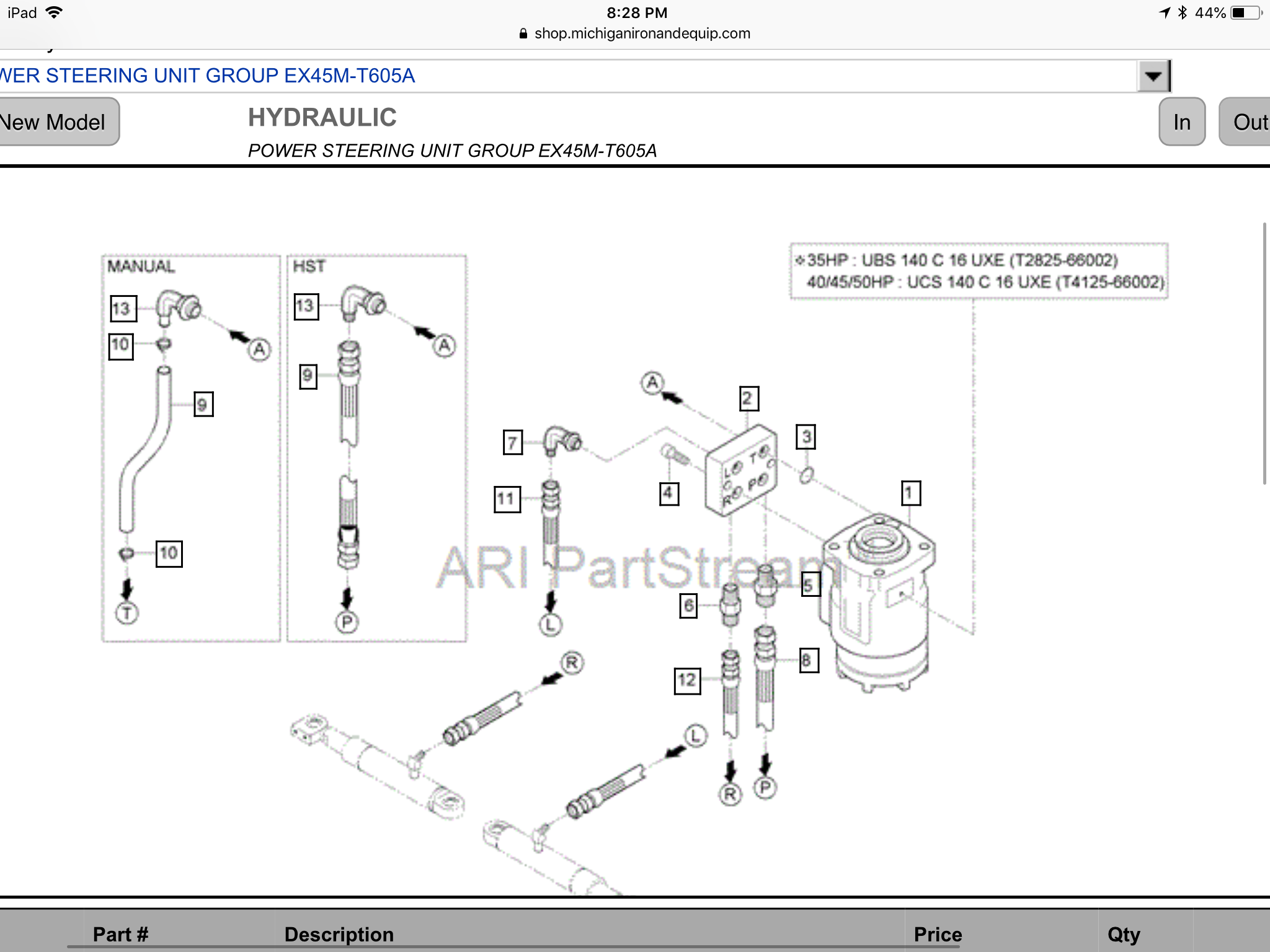

MIE lists the pump for $1160, and it looks easy enough to swap out, anyone know if there is a rebuild option, or rebuild service somewhere?
It looks like only one side is for the steering and the loader and 3ph is on the other, so maybe their?
Any other option? No binding on the tires, it just needs a fast spin, which after reading through the threads it seems that is a key indicator.
This is the parts diagram from MIE
Anything other to try?

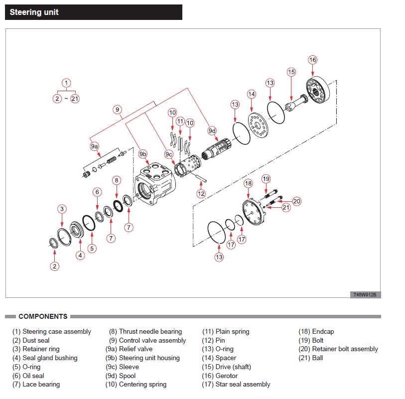

Best I can find is this. But has no part numbers.
Kiotis own workshop manual says to replace the steering unit if there is internal leakage.
Having said that, 20 minutes does not seem long enough to heatsoak the system to the point of steering unit failure, especially with an HST tractor that is underway, as oil is still going through the cooler. Sure the relief valve at the joystick was working overtime because the remotes were engaged

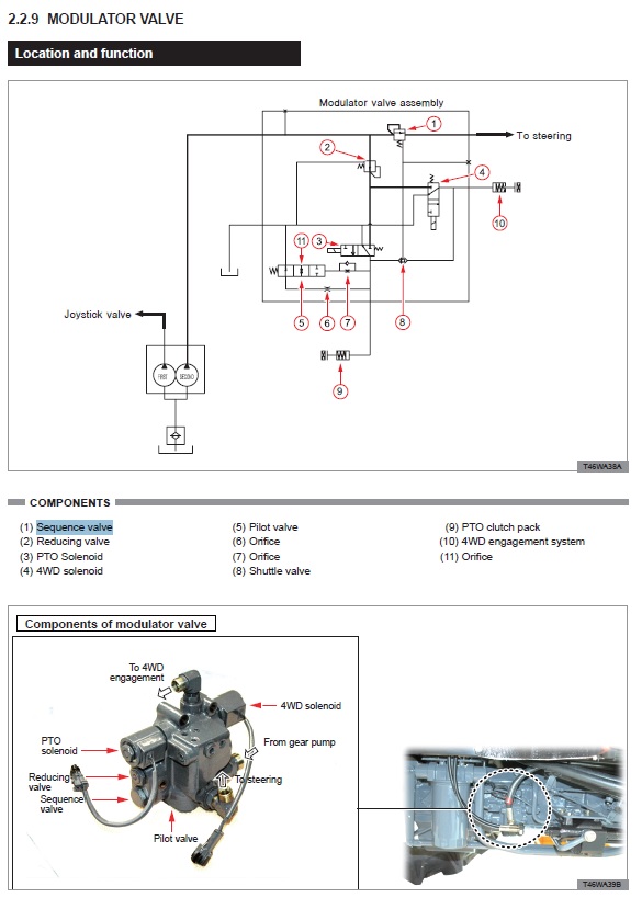

* The modulator valve could be leaking back to the tank, Does the 4wd and PTO still engage correctly and quickly?
* The sequence, or reducing valve inside the modulator could also be faulty/dirty, causing this.
* There is also a chance that the steering relief valve is stuck open.
* A filter change may also be a cheap try.
Here a reference for the modulator valve to help you identify these valves.

The post from xcgreene shows the modulator and sequencing valve, I think that’s where I check first.

Here’s a question. How is the reducing valve or sequence valve removed? It appears they are threaded in from the picture from the manual Can anyone verify?
From noodling over the theory of operation as I understand it (barely), it appears these two are the best places to start, should I remove the entire modulator block first or leave it bolted up?
Assuming release pressure with the tractor off, remove valve, inspect, replace seals if necessary and or replace valves as necessary.
Replace filter and fluid (11 gallons iirc)
