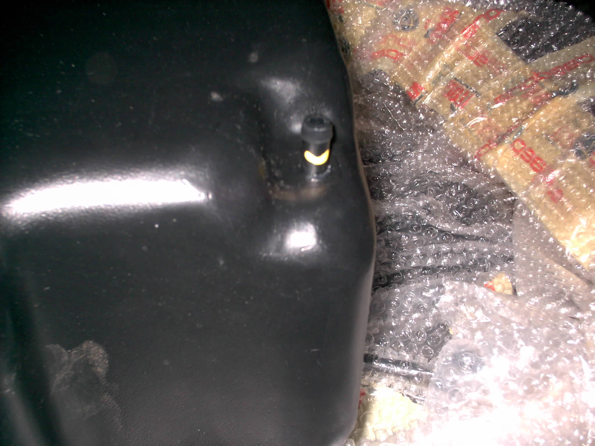

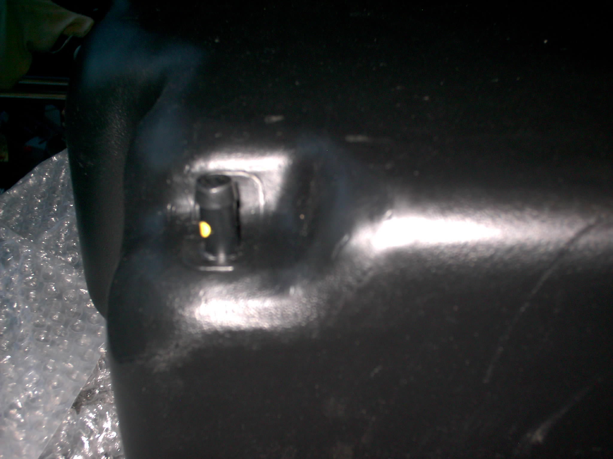

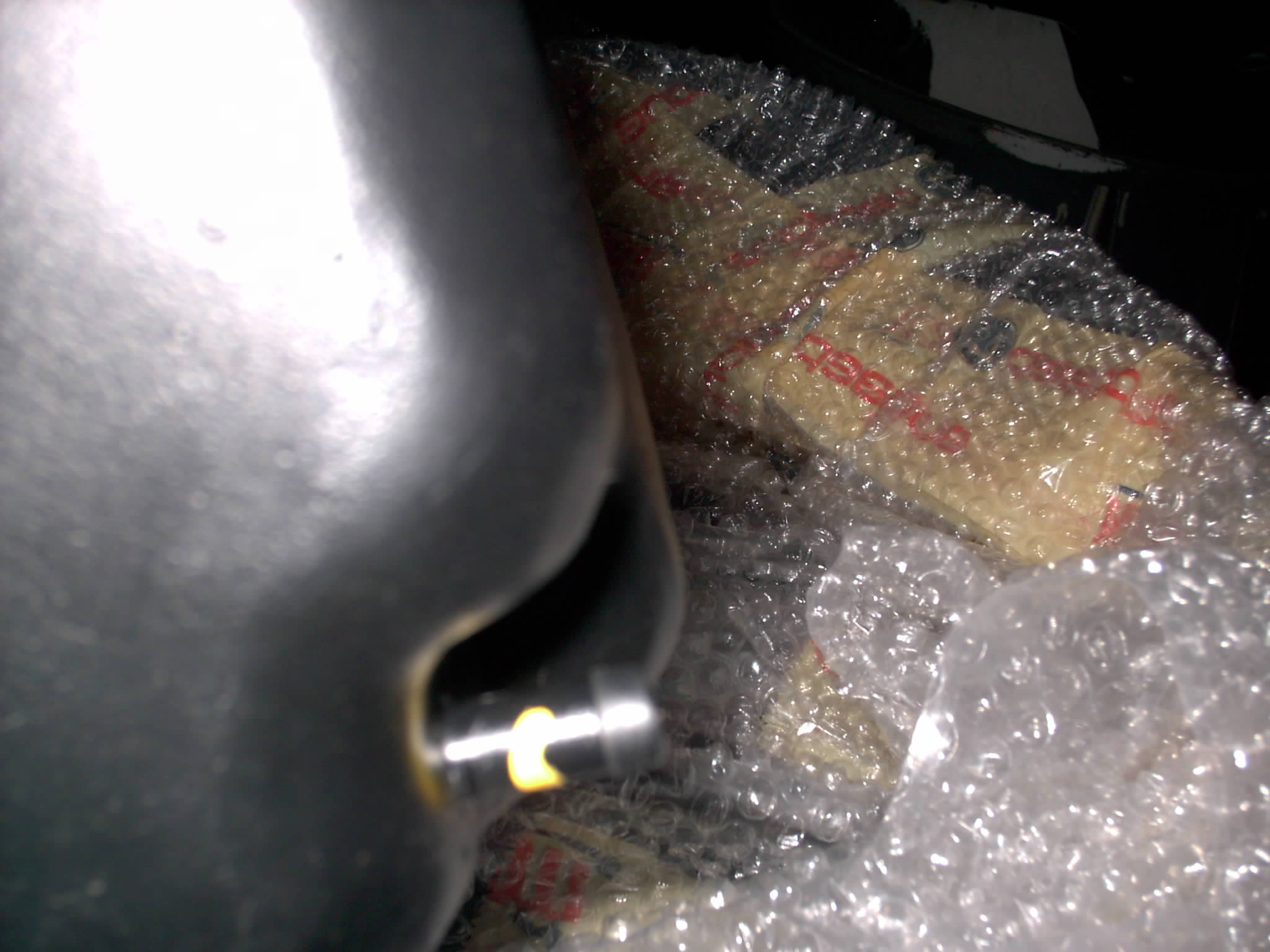

dk fuel leak 001.JPGdk fuel leak 002.JPGdk fuel leak 003.JPGA positive update. I was wrong on my above assumption. Dealer was very helpful/instrumental in getting this issue resolved. Kioti sent me a new tank under a parts only warranty. Obvious that Kioti felt there was a problem as the tank has been redesigned slightly in the fuel pick-up area. Much improved and should stay outta trouble now.001.JPG002.JPG003.JPG

It's nice to see you have a dealer that will work for you when a probable design defect caused it to leak even just out of warranty. Just some work for you but a new free part is definately nice to get you up and running.

Update, Dove into tractor last night and finished tank install. Let me tell you, don't try to shortcut the install as you will just frustrate yourself. Tank must go in with the main support and tank securement strap as an assembly. I tried to see if main frame around tank could be put in and then the tank,no go. Would need about an inch more of clearance which is not there. Unfortunately, I did not take pics for the whole procedure because tractor has been down for 3 weeks waiting on parts, then cooler weather. Anyway, me happy now.
