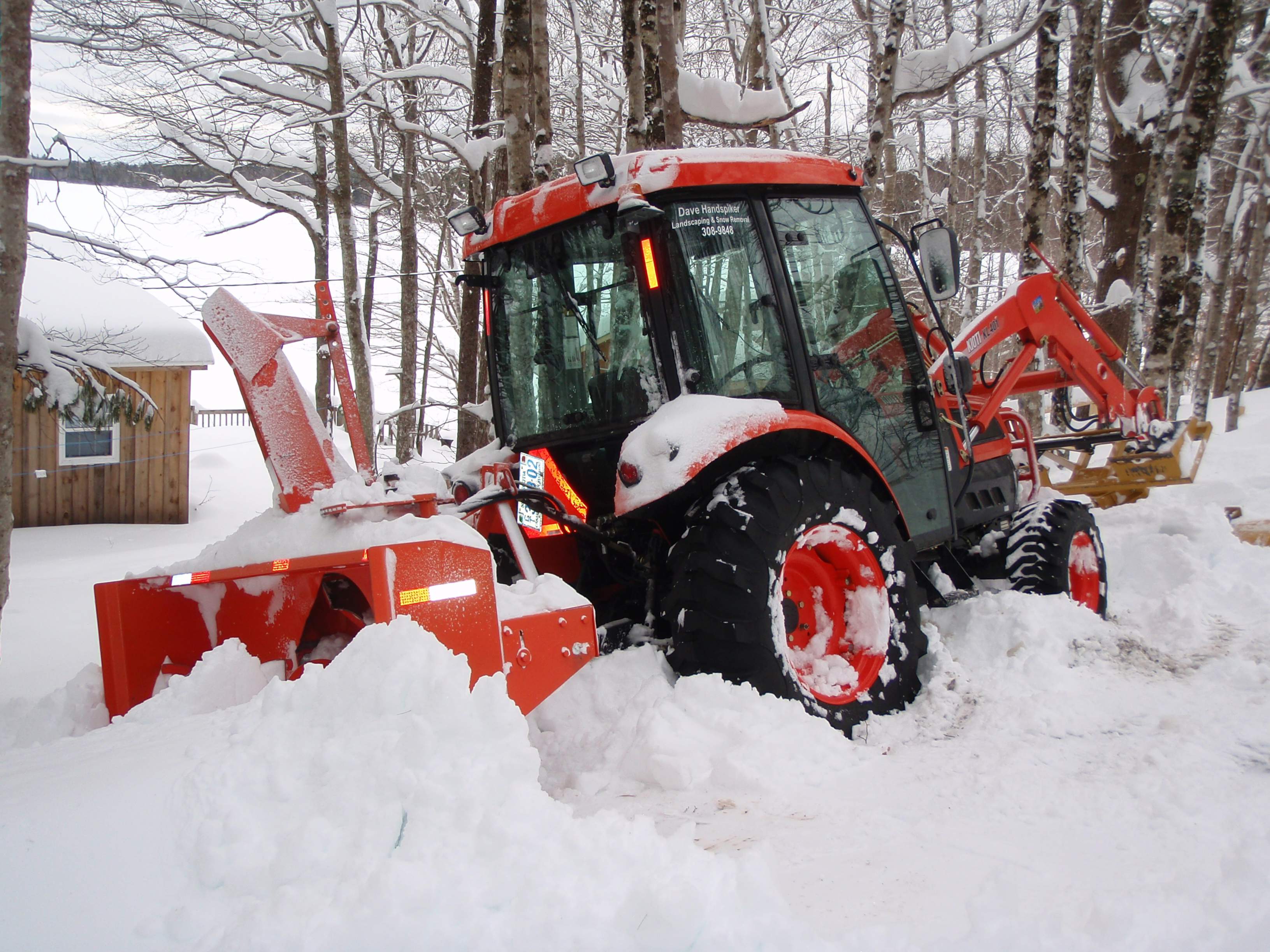

A close friend of mine is on his third Kioti, all with cab. He uses his tractor mostly for snow removal with FEL and blower. His newest DK50se is his first Hydro, the others were gear. His left knee would kill him after a long day of moving snow with the gear tractors. When I decided to buy my DK40se I was already set on Hydo and I have no regrets. Keep in mind the DK45 is only 4 engine hp more than the DK40, same tractor and loader, but more money.
   / DK45SE... Hst or Gear? #10
Bigturk, have you used your DK40SE to snow blow yet? If yes what size blower and how has it worked? The dealer recommended a 6' blower for a DK40SE HST (Cab) I'm looking at.
Thanks.
