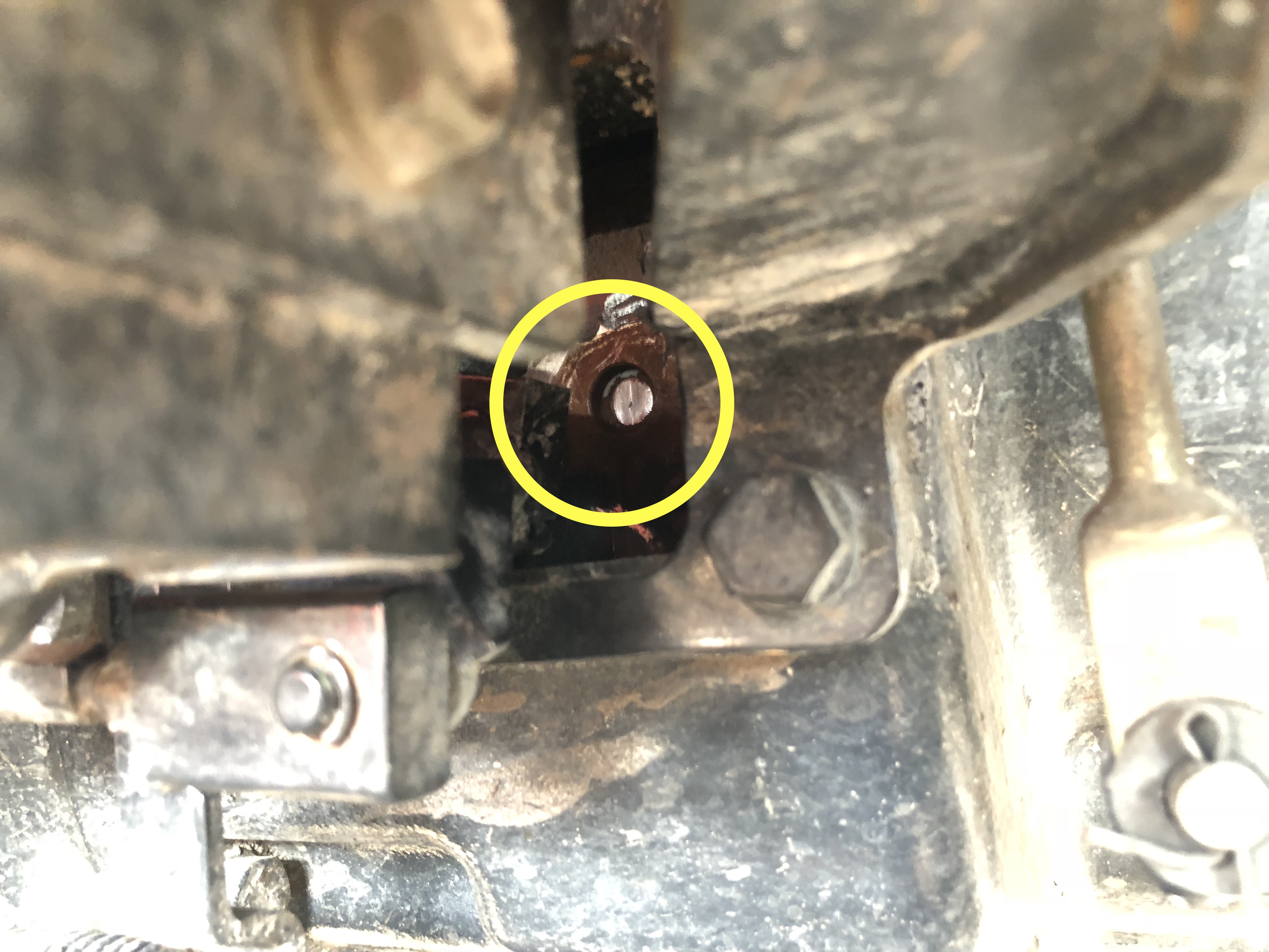

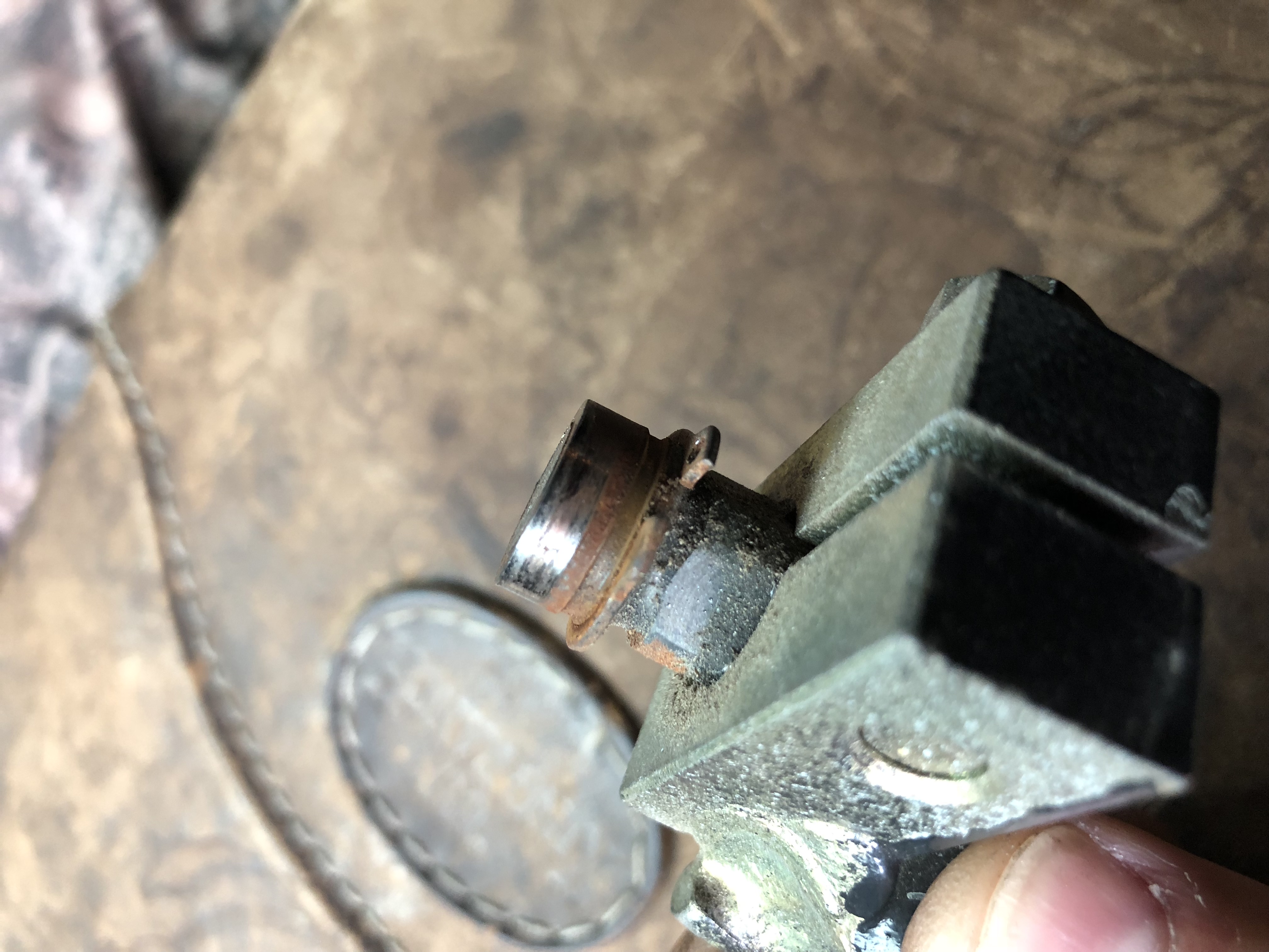

This morning, I was blading some fresh dirt around when after about 15 mins of light use suddenly the tractor became totally unresponsive to the pedal input. The transmission changes gears just fine, the oil had JUST come up to temp, all other functions appeared to work just fine. No matter what I did the pedals were not pumping hydro fluid through the HST. There were no obvious signs of hydro fluid missing anywhere and all levels appeared to be ok.

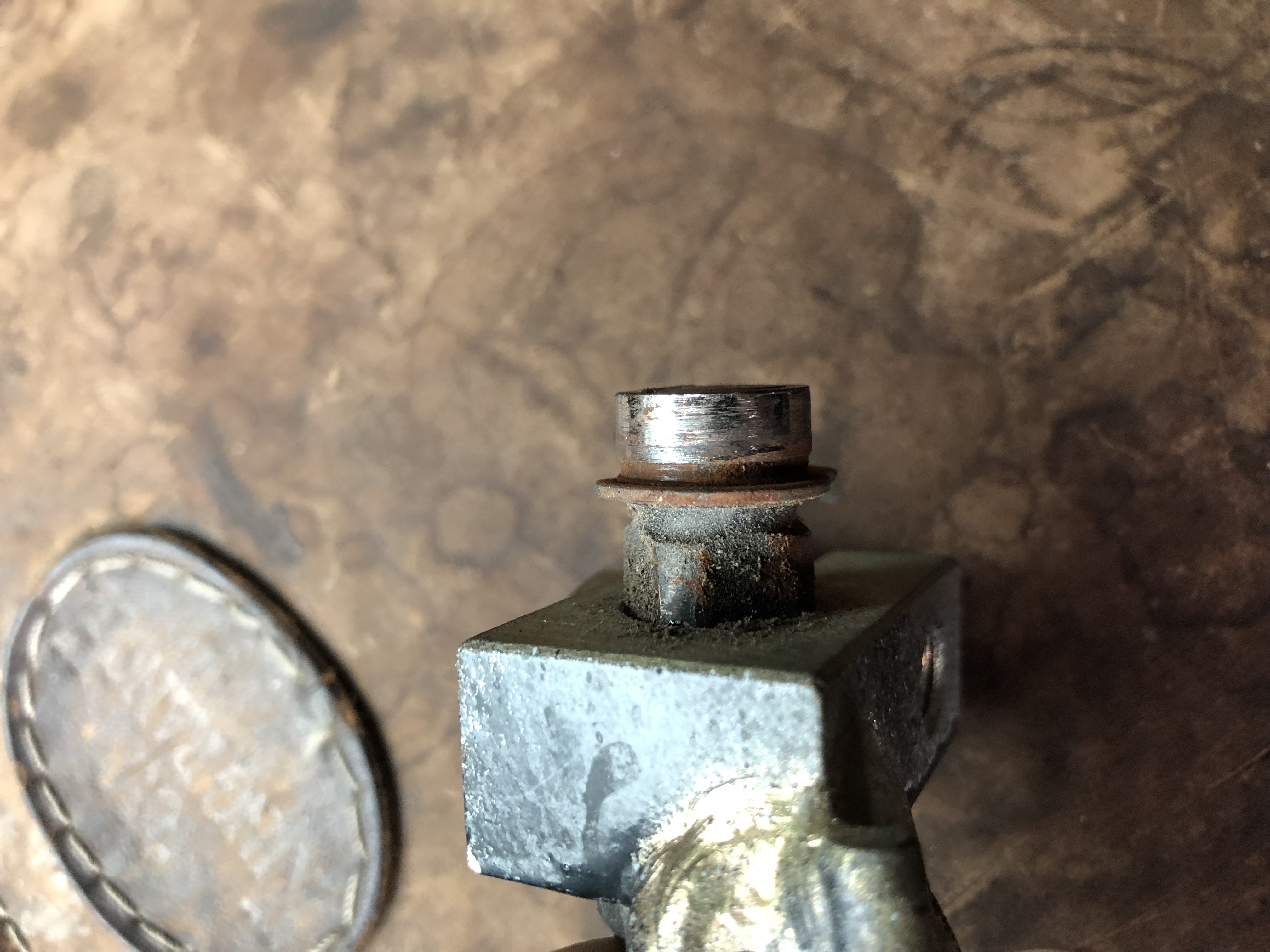

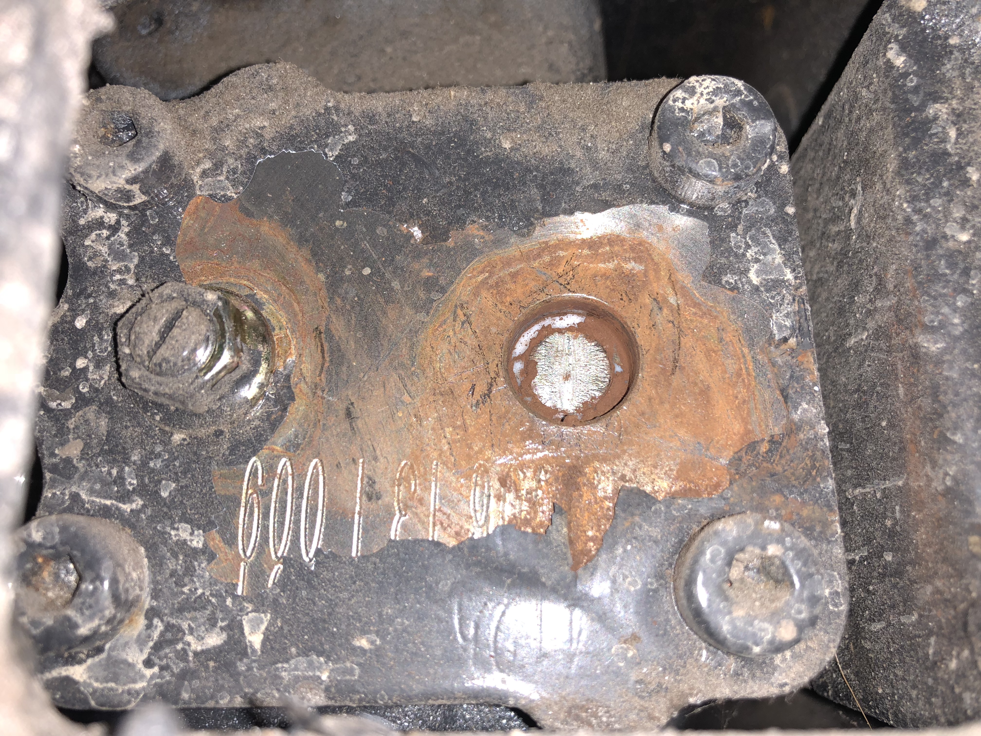

When i got underneath the tractor to start figuring out the problem, I saw that the actuator shaft that goes into the HST had sheared off right at the HST. Has anyone seen this before? What is the course of action for repair? Is there any sort of rigging fix I can do to at least get it up onto the trailer?
Thanks in advance! You guys are awesome
IMG_2026.jpgIMG_2028.jpgIMG_2024.jpgSee attached photos

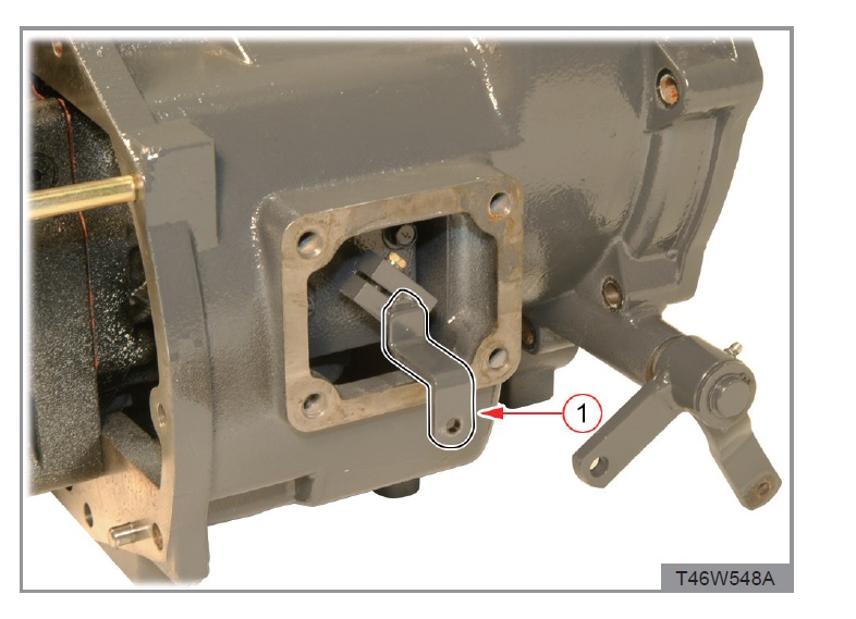

To help determin your linkage adjustment was correct, have a look at this picture. Its from a Kioti EX machine, an Australian version of the DKse series. I have found it to be very accurate on mine. So I have no reason to believe these measurements would be different than yours, but use some common sense when applying these numbers to your rig.

Note that the adjustment arm (#81) of course rotates with your foot pedal, which, in turn, moves the "Power piston" which actuates the swash plate of the HST axial piston pump.
Something to make note of while disassembling would be the spring placement against the fulcrum (item #82) its this brass colored item in the next picture below. Also note where that pin on the end of the adjustment arm (#81) goes into, to make sure you put it back in the correct spot of the power piston.

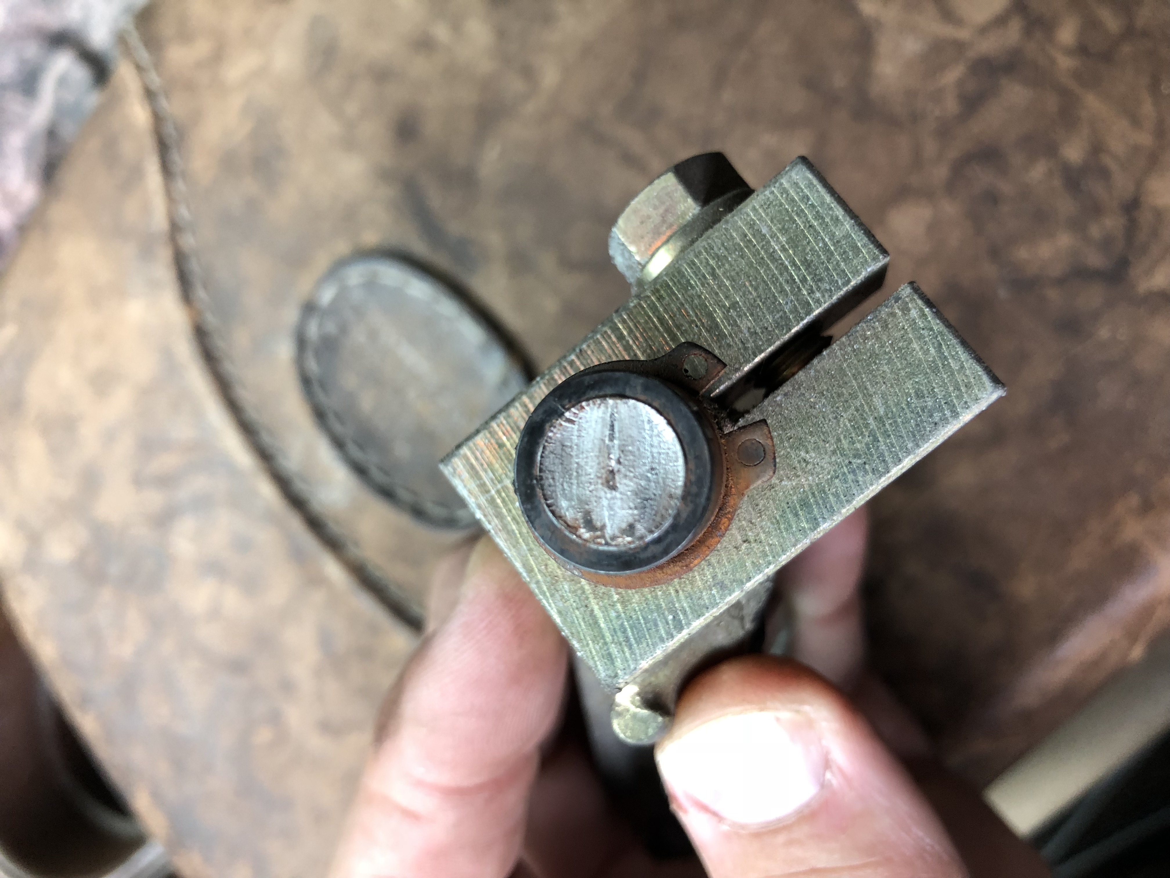

Excellent info. Thank you so much!! I think I found a part of the problem. Poor installation of the snap ring on the output shaft. There was too much tolerance between the case and the ring, allowing it to rock back and forth.IMG_2050.jpgIMG_2056.jpgIMG_2058.jpgIMG_2055.jpg

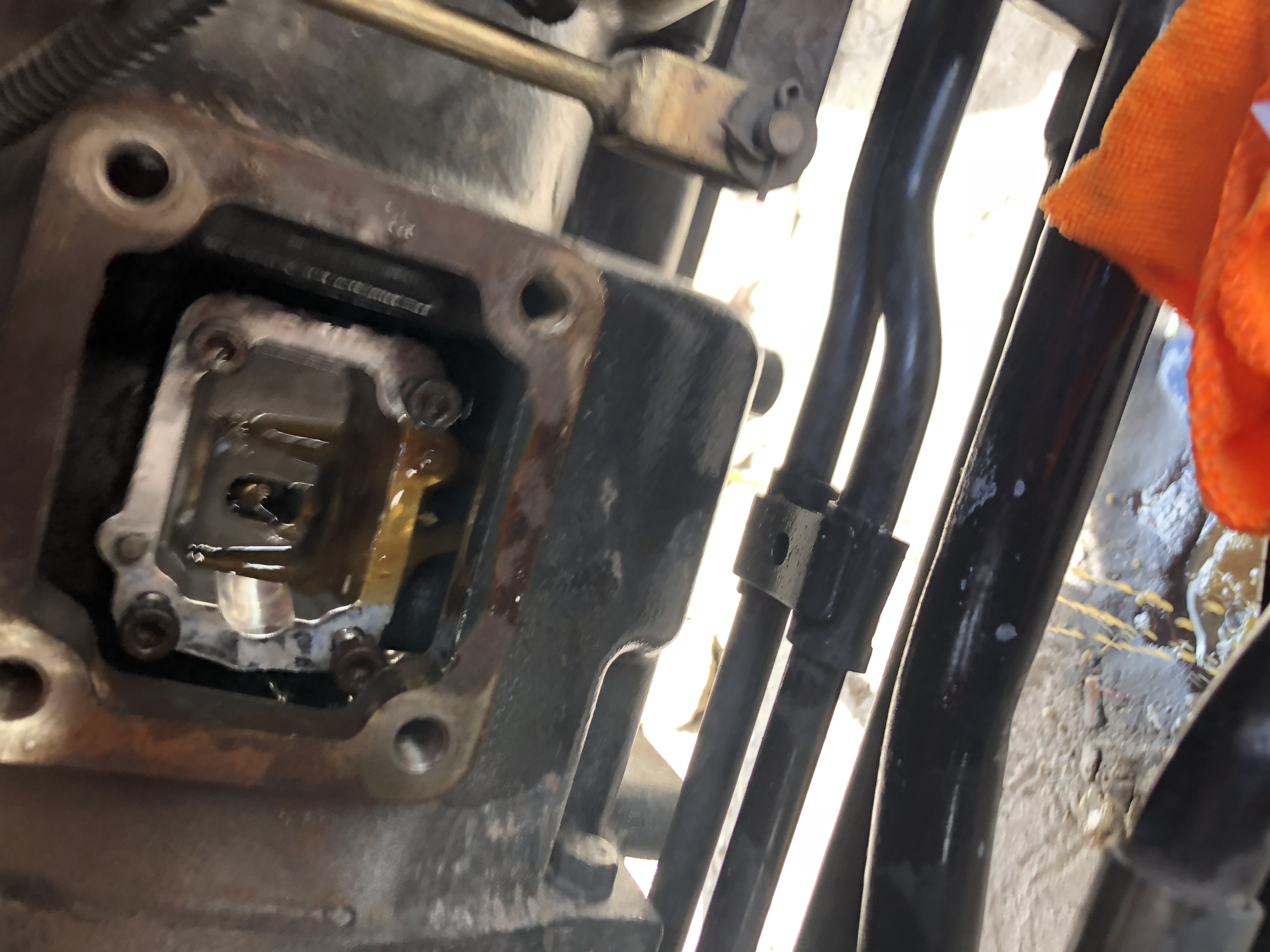

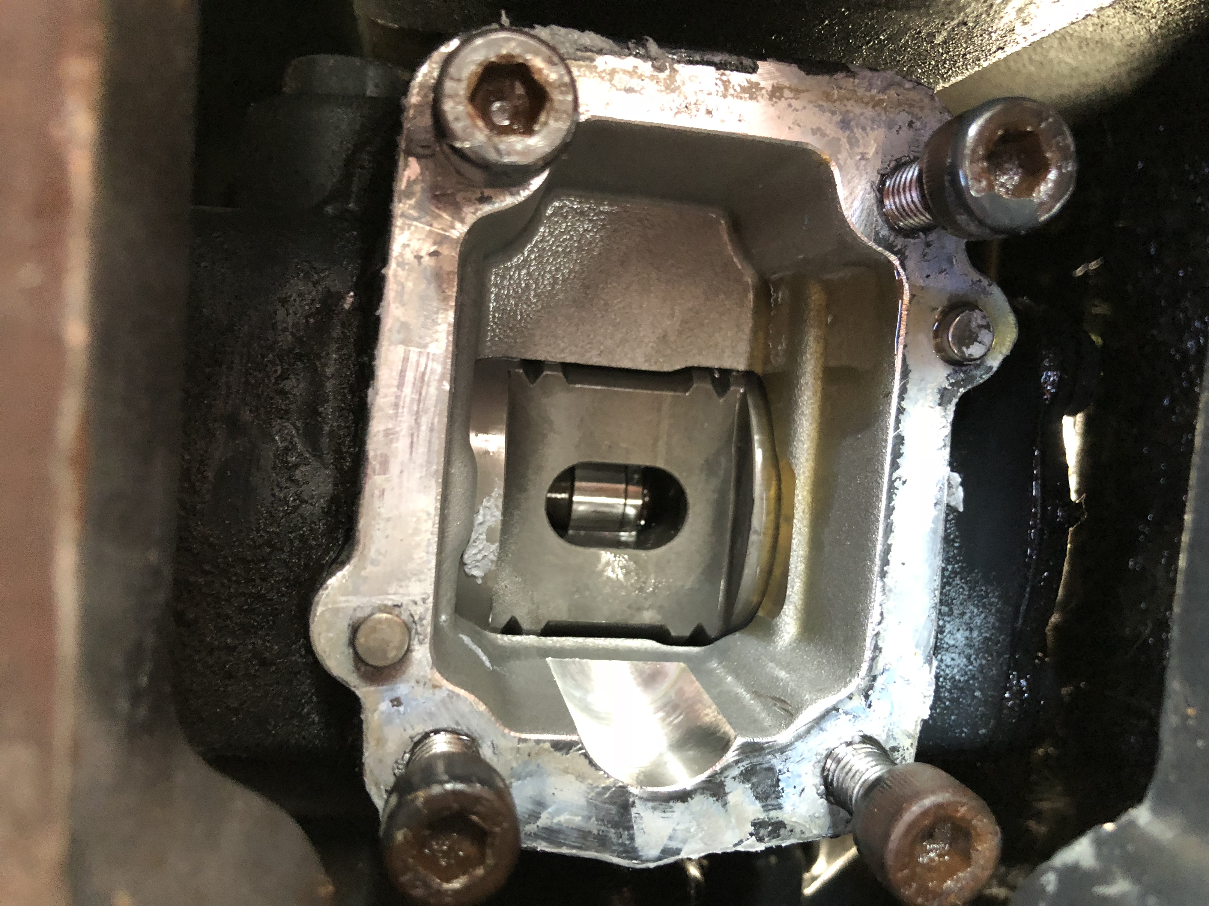

The saga continues.
I repaired the snapped input shaft and during the test re-fit I was hoping to see some positive results be actuating the atm before fully re-assembling with gaskets and the pedal assembly.
I was NOT successful in that dream. Once the cover was re-installed I was unable to move the power piston that the input shaft indexes on. Neither forward or reverse would budge.
I attempted to manually push the piston up and down with a small pry bar and got maybe 1mm of movement. For giggles and grins I started the tractor to see if I was getting oil flow, and it appeared normal as it came from around that piston. Totally confused. Any ideas on how the power piston itself would be seized? Any blow up diagrams, (asides from the parts manual) or advice would be tremendously helpful.
6A027C27-C00B-4275-AA32-BDCBA88B9473.jpeg537FE5BC-AFF4-43DA-B405-7DC7E42BAE02.jpegHelp!

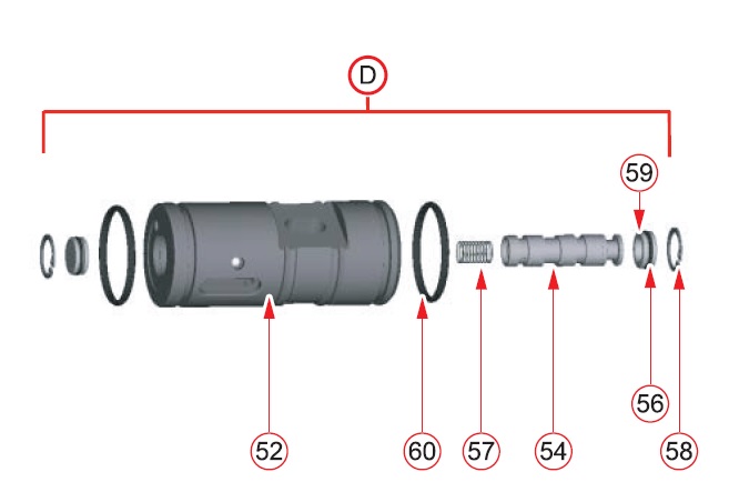

Other than the parts manual as you stated, I have this.
The spool, Item 54 here, is what moves back and fourth inside the power piston assembly to actuate
the axial piston pump swash plate.
If the HST must come out to access this valve, the tractor must be split and hst removed.

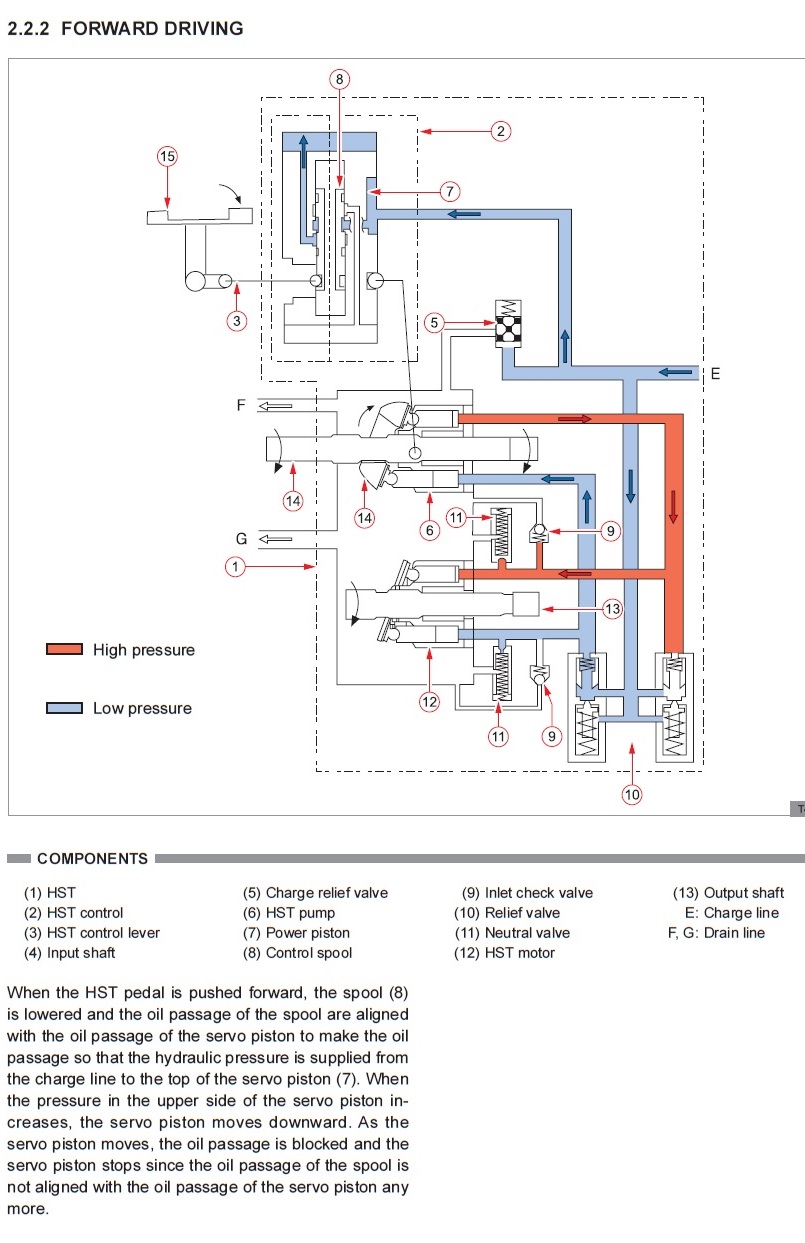

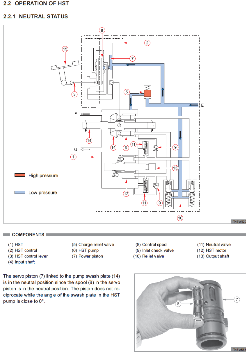

But before you get too far into that, have a look at these two laymen flow diagrams, perhaps they could indicate a different problem with an easier solution.
