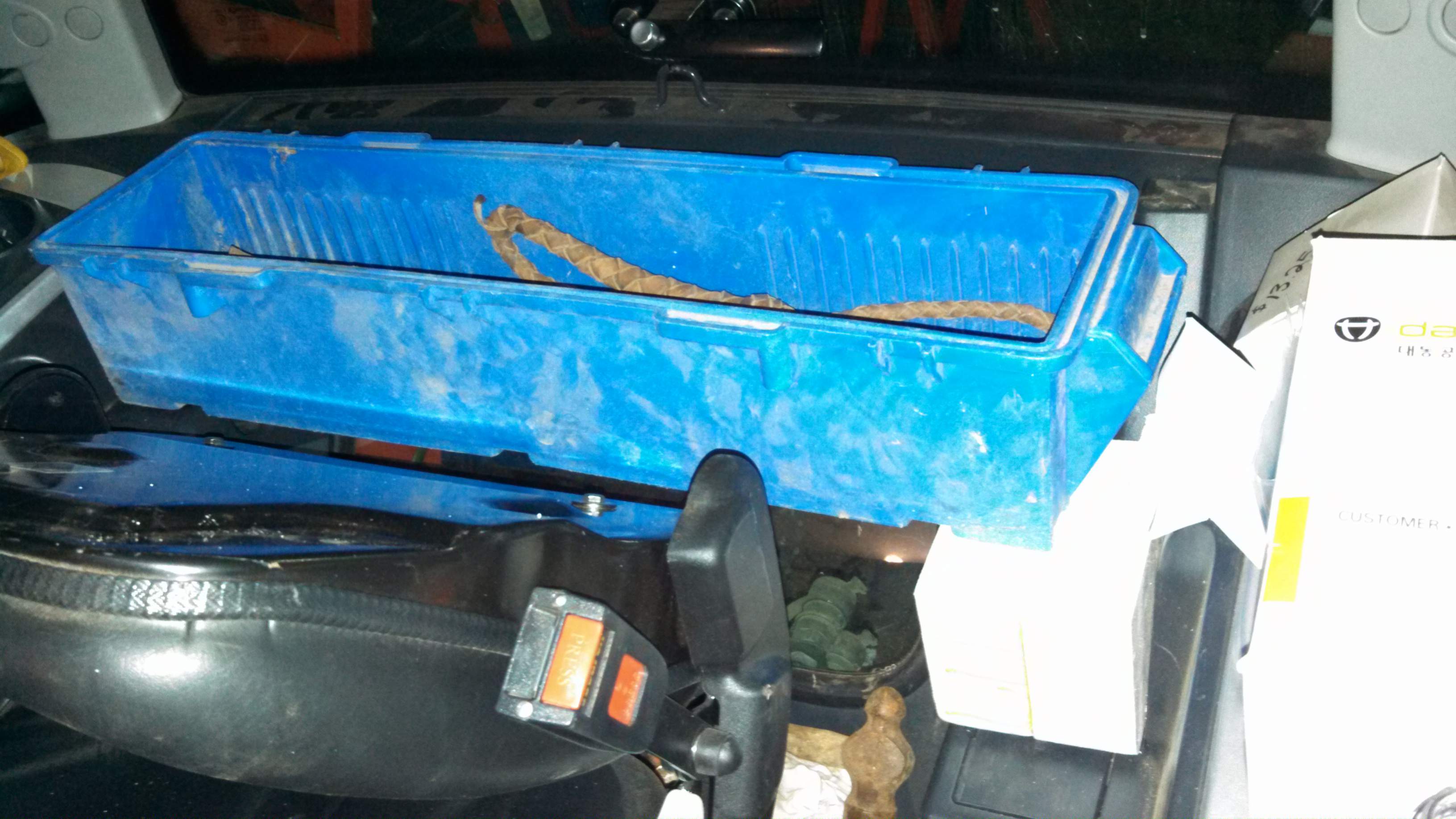

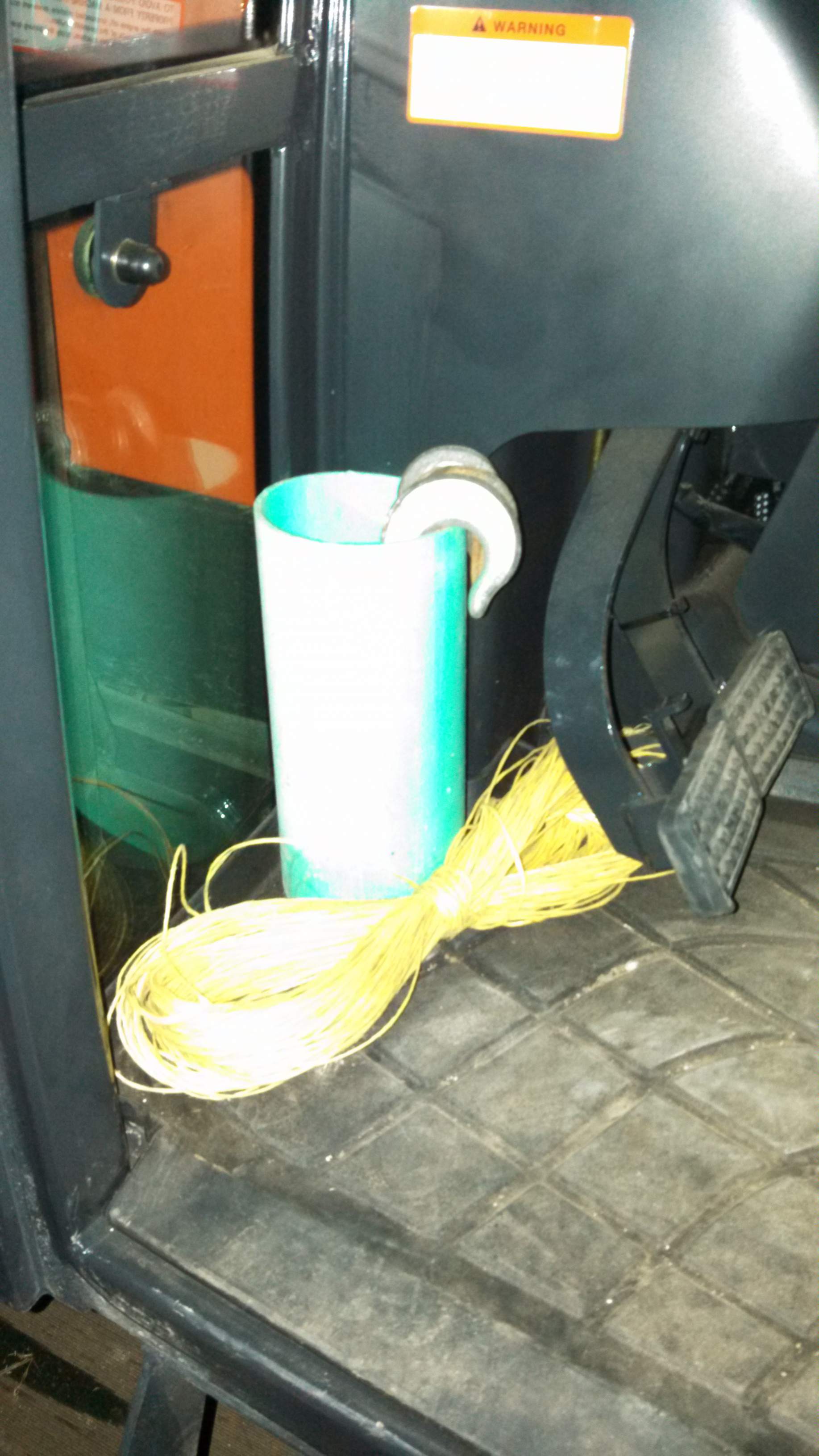

I am trying a few things for my DK45 cab. put a 4 in pipe to hold small chains in front of the brakes, put a 2x4 drilled out to fit over the studs behind the seat so a top tray from a tool box 7in wide and 17in or so long, and found a long plastic tray at a farm sale and with a foam block stretchs across behind the seat.
