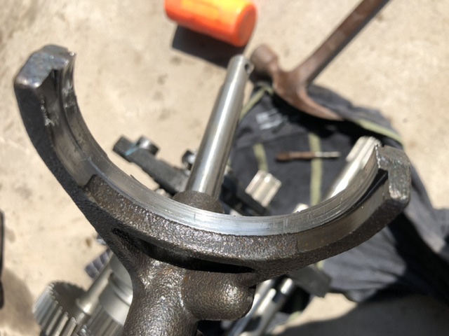

My assumption is that a fork broke, what do yall think? If so, whats the best way to get to it?

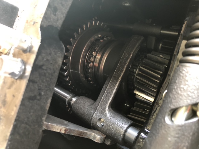

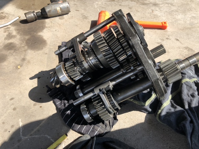

I’ll make sure to post some pictures here when I tear into it!
   / DK50SE stuck in low range #9
Very nice! Maybe something to help us "see" why it's so hard to get the thing into medium range at times. :thumbsup:
9DCD721C-1354-4EED-9C47-F50CF7D96F0A.jpegF76D91BE-3054-4F69-A600-3B41AF548BC8.jpeg0673EC18-B12B-48FB-B665-AFFECBED8E5A.jpegF7FF4AB0-CAE1-40B3-B292-88122A88BBEE.jpeg50F7914D-11F0-45AB-AA16-DC3B3AC24D98.jpeg357A4FD7-FE53-4669-A5F3-5B6E89EEFAB4.jpeg9832E768-9D9B-4231-B52D-8041A9D2CB9E.jpeg

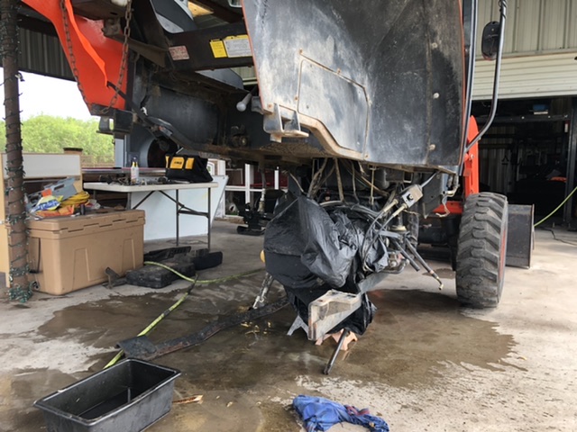

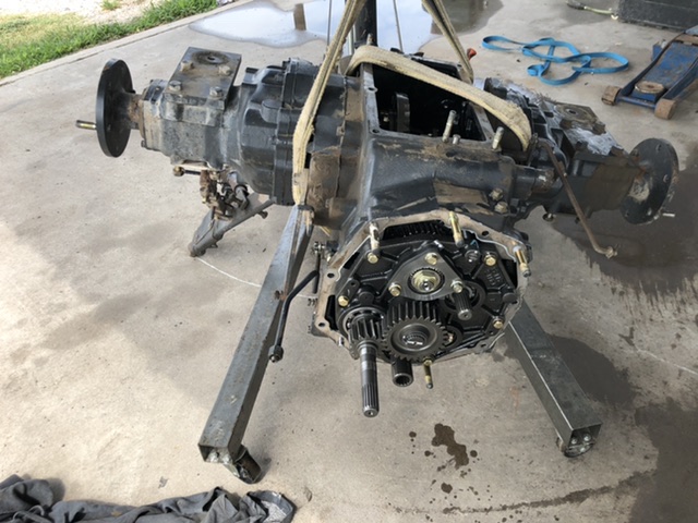

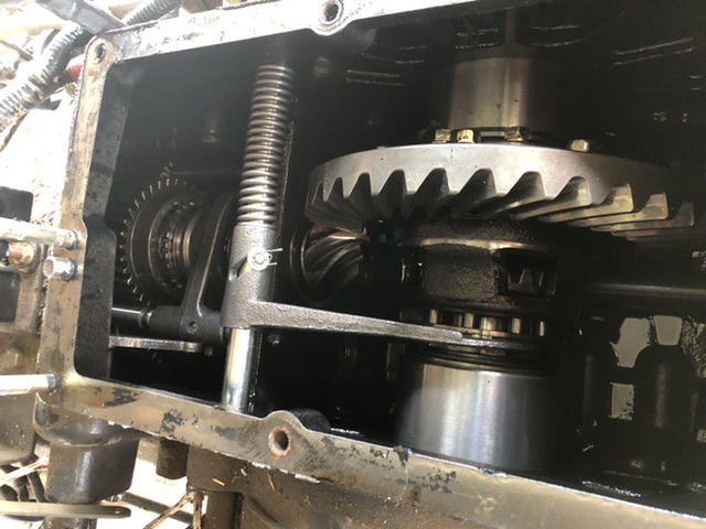

Been meaning to post some progress pics, turned out to be the fork but it wasn’t snapped like I thought it was going to be, it was worn out??
