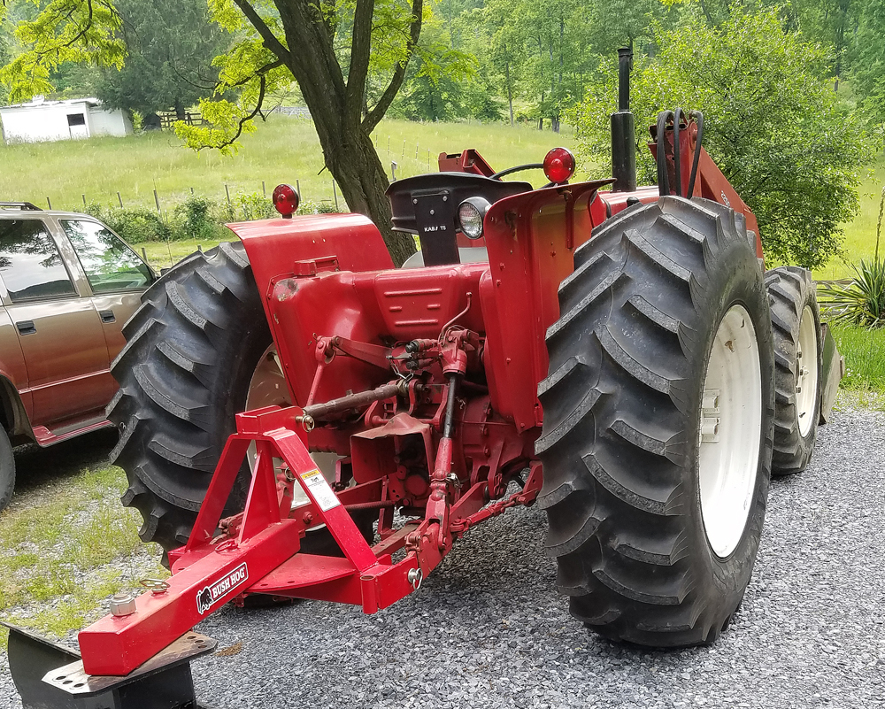

Here is a pic of the tires I had filled.

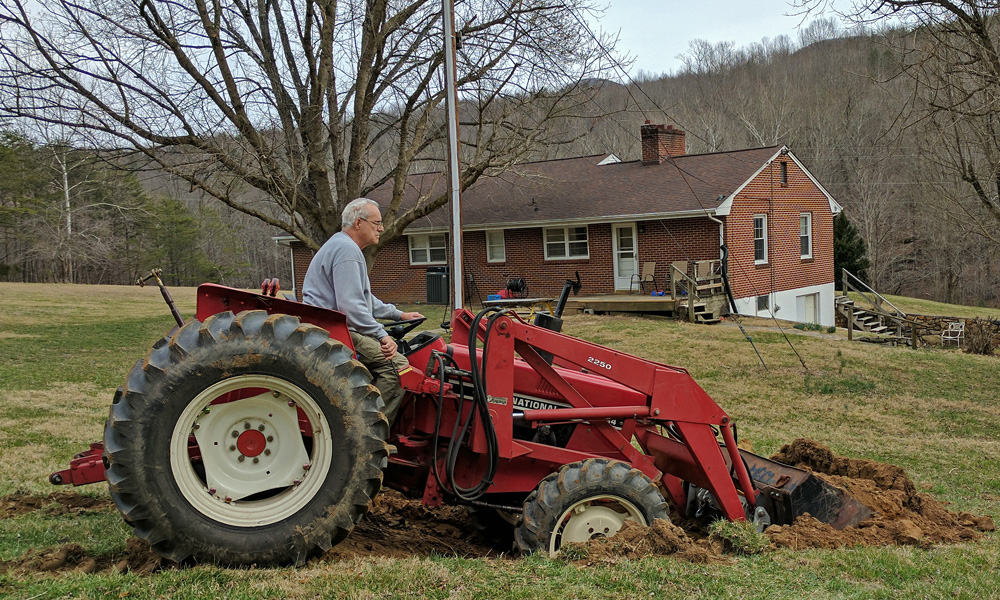

My tractor recommends about 1,000-1,200 lbs. And it's only a CK2510. A rear implement is not sufficient IMO; they don't weigh enough. Also IMO loaded tires do NOTHING as counter weight, ie reducing strain on the front axle. They do help to keep the tires planted but the rear axle is the pivot point for the lever that the tractor becomes when lifting weight i the FEL.
   / Dk5310se ballast question #13
Some tractors simply do not care about using the rear axle as a pivot point,,Spring9.jpg

Some tractors simply do not care about using the rear axle as a pivot point,,View attachment 728042
I do not think that there is a tractor that will not benefit from the addition of a rear ballast. Several times I have witnessed tractors running without rear ballast but that does mean the wear and tear of a heavy load on the front axle could be reduced with the addition of the rear ballast. Also the addition of rear ballast on the tractor in your picture would reduce the need for wheel spinning and the use of the dif lock or brakes to walk back out of the hole that you were digging.
If you watch this video
you will see Mike pick up a cube of block and then without much warning the rear tires start to lift. On a hillside or working around a burn pit this could have be a serious problem. The lifting of the rear tires on a 2 wheel drive or a 4x4 in 2 wheel drive would mean there is no control of the tractor.
Is it a big deal? No most of the time it is no big deal but the chance of a disaster plus the reduction of wear on the front end by simply hanging a box blade or ballast box on the rear seam like a small price to pay for a safe day on the farm.
   / Dk5310se ballast question #16
Your name implies you might be an engineer, or at least more than competent with CAD systems. So you understand levers and leverage. So when you lift that bucket of dirt all that additional weight on the front axle is actually more than the weight of the dirt in the bucket. Because the bucket being out in front of the axle is creating a lever with the pivot point being the front ... wait for it; AXLE! This is why a big load in the FEL can lift the rear tires. Which is why some people load the tires, keeping the rear planted. But still all that stress is concentrated on the front axle.
But you knew that.
You just wanted to post a picture of your tractor doing some amazing digging. It is impressive. Sincerely. My tractor cannot do that unless my 1200 lb BH is on the rear.
