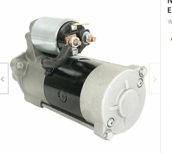

Kioti DK5310se HST won't start. Tractor is hooked to livestock trailer in remote field, and I need to move the animals home tonight.
Turn the key, hear a click, but nothing else. Battery is good. PTO off, seat switch ok, in neutral.
If I jump two big post on solenoid, the starter spins but doesn't engage the fly wheel. Everyone in awhile it will make the fly wheel flinch, but that's it. The starter spins good whenever I jumper it though. Not sure why this is.
I need to get this thing started, any ideas?
I feel lime its a safety switch issue somewhere, but no sure how to override.
good news jumping the large posts should spin the starter, but, not engage the solenoid, so it is doing as expected.
Jump the battery side of the starter to the start post on the solenoid, and you should get spin and engagement.
Make sure the tractor is in neutral, brake set as starter can move the tractor.
Report back findings, and maybe we can provide additional hlep.

I always hate "I think" answers, but.
I don't have your tractor, but, I think this is the starter
Lots of good suggestions here that are getting a little beyond my skill level.
I do have a meter, but am not great with it. I have an electrician friend I will try enlist the help of tomorrow.
The starter solonoid has only two posts on, one is obviously the + side, since it hard a red covered over it, and the other is the black. This is what I have been jumpering across with no luck.
I like the above idea. but I am not quite sure what is what, so a little moire description would be good.
Yes, it is directly mounted, but I only see two wires going into the solenoid. One being an obvious positive from the battery.
There is a relay in the fuse box labeled "Starter" and and also a fuse. There is another relay mounted outside the fuse box directly to the firewall. I am not sure what this relay is.
I have a call to the dealer, but I am not optimistic that they will be of much help. It's all made extra hard by the fact that the tractor is 2 miles down the road in a field.
I hate I think posts, but, I don't have your tractor. In an effort to help, I think this is your starter, the empty large post is from the battery, the empty top blade should be from the ignition, and when supplied with 12 volts should engage the solenoid and spin the starter.
There certainly could be, and probably are issues beyond this (that is why I said report back your findings for additional guidance.
The fuse and relay, are generally in line with the ignition side, not the starter side, if we crank and fire with a jumper from the blade to the battery side, they are pretty good candidates.
Yup, get a meter and test if this doesn't help, looking for a quick test that doesn't require much for tools.
Good luck, let us know,
ed

Thank you all! This gives me some good things to try. I will get back after it tomorrow. I am also going to grab a new "Starter Relay" which is what I assume the one bolted to the firewall is, in addition to the relay labeled "starter" in the fuse box.
Dirttoys, Yes, that looks like my starter. When I jumper the two poles with a screw driver it usually just spins, and sometimes it throws the flywheel for just a second. May I am bumping the small blade post without realizing it?

Just use a screwdriver to short between the positve terminal on starter and the blade. That will tell you if the starter is engaging.
If the starter is OK, then there is either something in the circuit that is preventing the starter relay from activating, or one of the relays in the starter circuit are bad. Really need a circuit schematic to diagnose. With out diagnosis, you are just swapping parts hoping to find the bad one.
