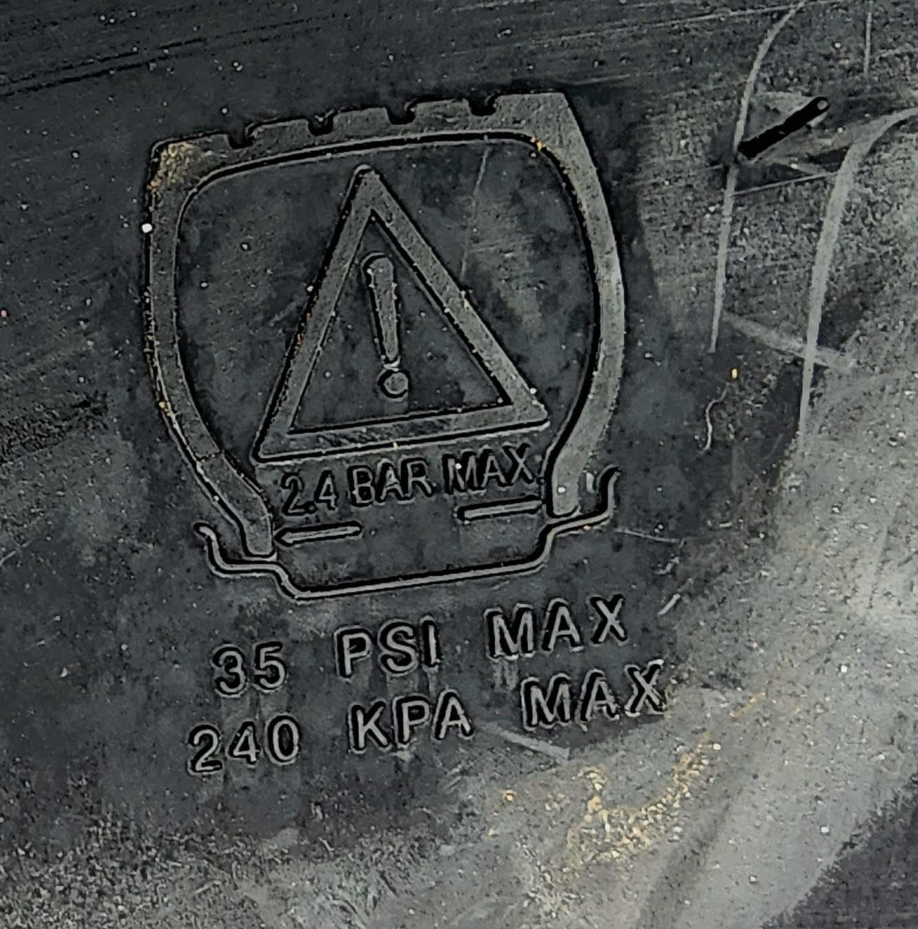

What's the pressure in the other one? A "boom" and a big split seems more like high pressure tire failure? With a 2/3 full loaded tire I'm running like 10-12ish psi in the rear R1's to gets some traction and smoother ride.
The fronts are running 30-35psi but they are R1's and get very distorted with a bucket full of gravel with anything less.

19 on both rears.

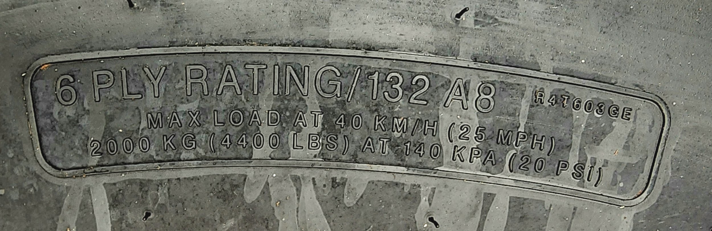

Yeah they should be fine with that, I do like running lower on the rears, for grip and ride. Unless you are roading a lot with something heavy on the 3pt lower is better overall IMO.

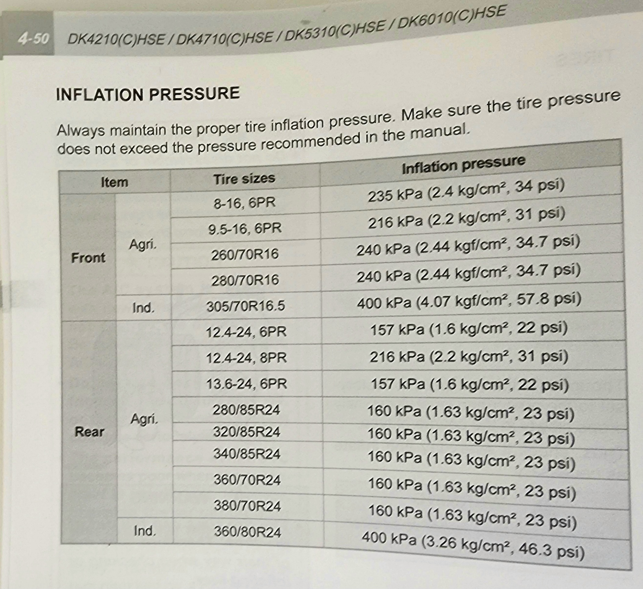

Dealer had them set higher at around 25, sidewall shows 4440 Lbs @ 20 psi with the bead-set max of 35 psi.
I too have been used to 12-15psi on previous machines, but that wad many years ago on R1s; I had dropped them down to 15 when I initially got it, but felt too soft, so took them to 19 and have kept them at that ever since.
The manual doesn't have values for the newer R14's, so I suspect the dealer filled them to old specs. Either way, 19 shouldn't have been an issue, but I'm no tire expert 😅

The rears have plenty of extra load rating then. I think with loaded rears you could go very low as there's only a third of the air in the tire, and so you don't get as much sidewall deformation at a low pressure, as you would with an unloaded tire. Anyways, seems like your blowout was just a rare event, and shouldn't have happened.
