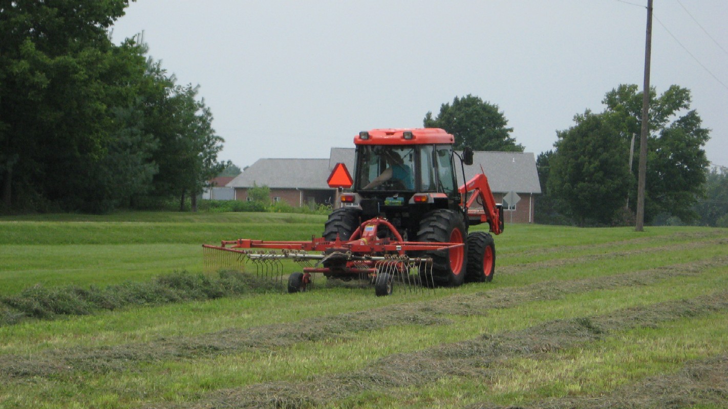

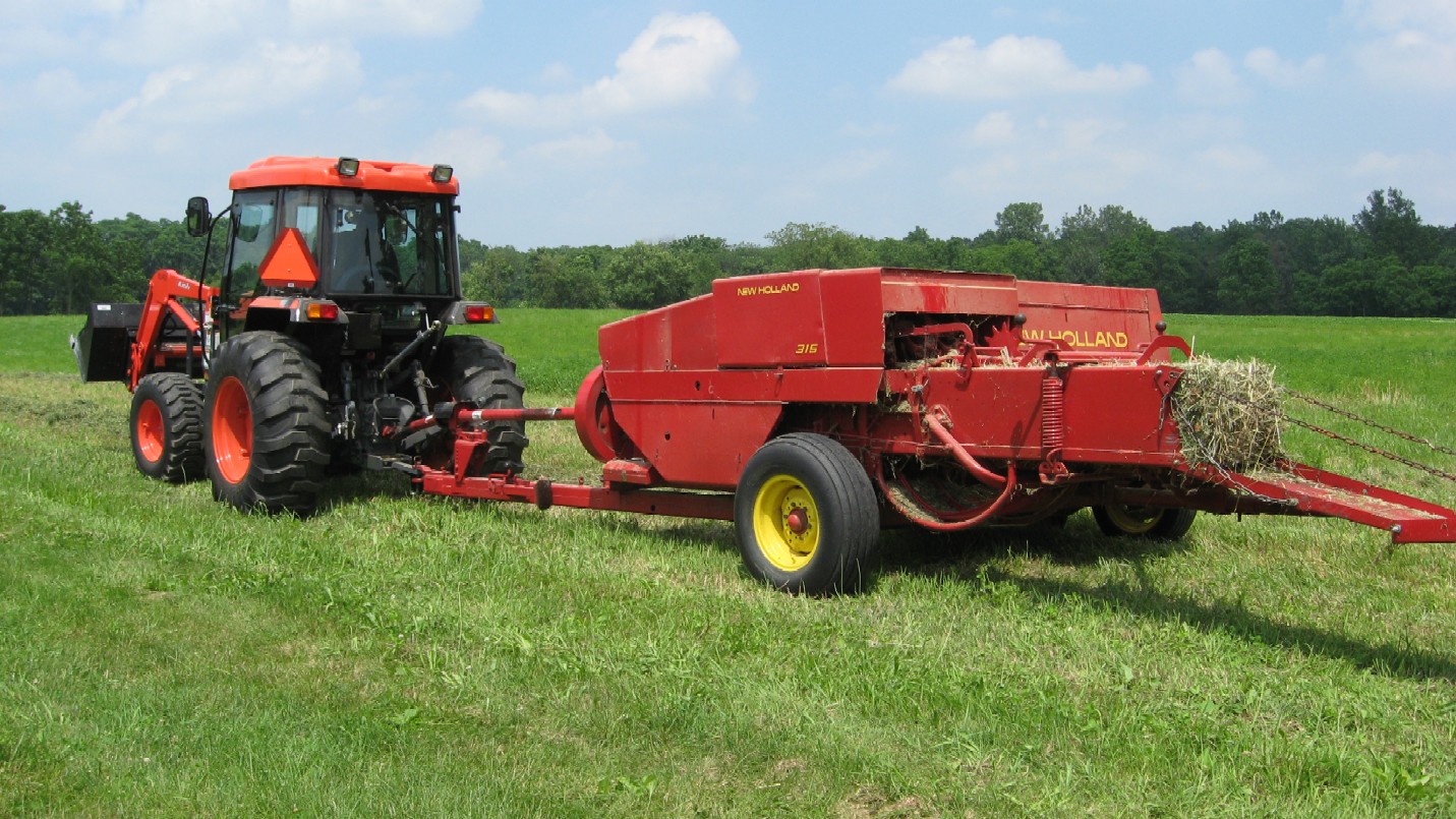

/ DK55 problems - potential purchase #4
I have a 2009 DK45S Cab and it is approaching 100hrs and half of the hrs have been PTO. Running a Kuhn rotary rake and a New Holland 315 Hay Baler. I have not seen any problems.
