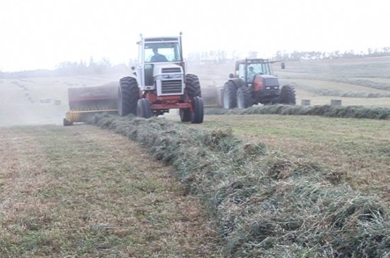

Finding a lower priced JD series like the 6115D peaked my interest as I know a fellow who has one like it. But with JD only offering a 9 speed trans in this series it doesn't leave many field gears once you take off the road gears. JD's other models with the better transmissions are way out of my price range of what I want to spend. Below is the actual JD 9 speed sycro trans chart from their.
I still make around 30,000 every year in sm. squares so we do a lot of baling through out the summer/fall. Right now the main tractor is the Valtra. With its 36 speed trans its great for finding the right speed to feed the balers consitantly.... no reason to make bales too long or too short!! Also whats nice about it is its so quiet in the cab partly because at 540 RPM it only runs at 1540 engine rpm. It's max rpm is only 1900rpm which is what it runs at for 1000 pto.
We also use old Case's (1978) 2090 and the (1974) Case 970 for cutting and raking. Belarus runs the 3pt hitch tedder when needed and other odd jobs. The Cases (12 speeds) have good gearing just sometimes when we are baling double rows at times they can't go quite slow enough. The Belaurs has lots of gears but no shifting on the go and no a/c so its not used for baling. Tedding it isn't too bad as your travelling faster and with the doors open its not too bad.
JD 6115D TRANS mph Chart at rated rpm.
