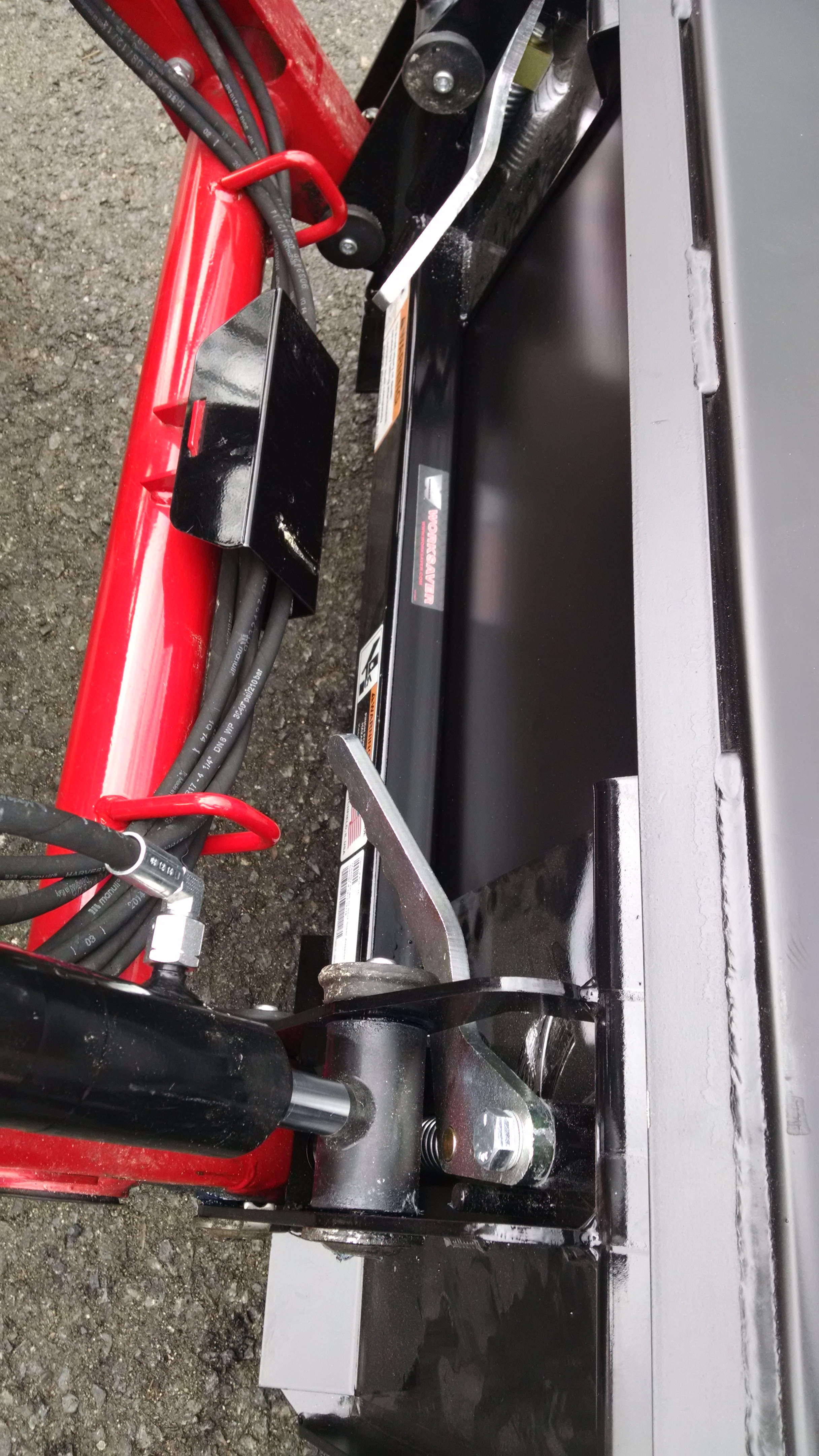

I just found this auction on eBay. Almost Gone!! QUICK ATTACH CONVERSION FOR TRACTOR FRONT END LOADER. Free Ship | eBay After emailing back and forth with them I found the adapter will fit my GC2600 DL100 loader. They have the diagram for the pins that I got from another company that makes an OEM adapter for this loader, and the 3/4 pin size used on the DL100. All for $300 less than Everything Attachments. Still weighs 125lbs, but thanks to another thread on here I bumped lift capacity up 300 lbs over factory if the numbers are right.
Combine this with SSQA plates for $75 on eBay as well and I'll be switching completely to that. Custom light material bucket being built, factory bucket converted over, soon I'll add a HF quick hitch on a plate to move 3ph implements around. Or use my boom lift to reach new heights!

SSQA kit is installed, works great. I did have to mill an extra slot on each bucket adapter plate though. The two original ones did not allow for enough adjustment to match the Massey pin spacing. Took longer to figure out how to clamp them to my table than to cut them though. Once done everything connected right up. I did have to move the included spacers to the inside of the bucket adapters and outside of the loader arms to get the QA spacing right so the bucket didn't slide back and forth a couple inches. Though it wasn't hard to figure out despite the lack of instructions. Definitely worth the price paid! New bucket is perfect for cleaning out the barn and moving compost around. Increase PRV PSI works great too. No noticeable speed decrease.
