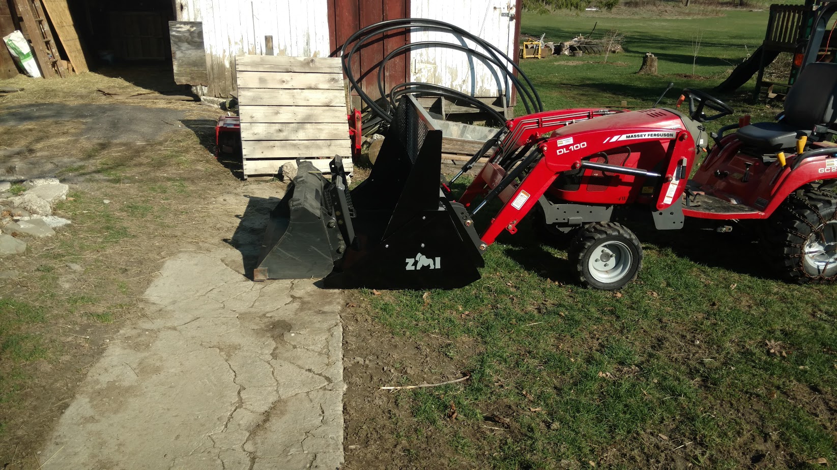

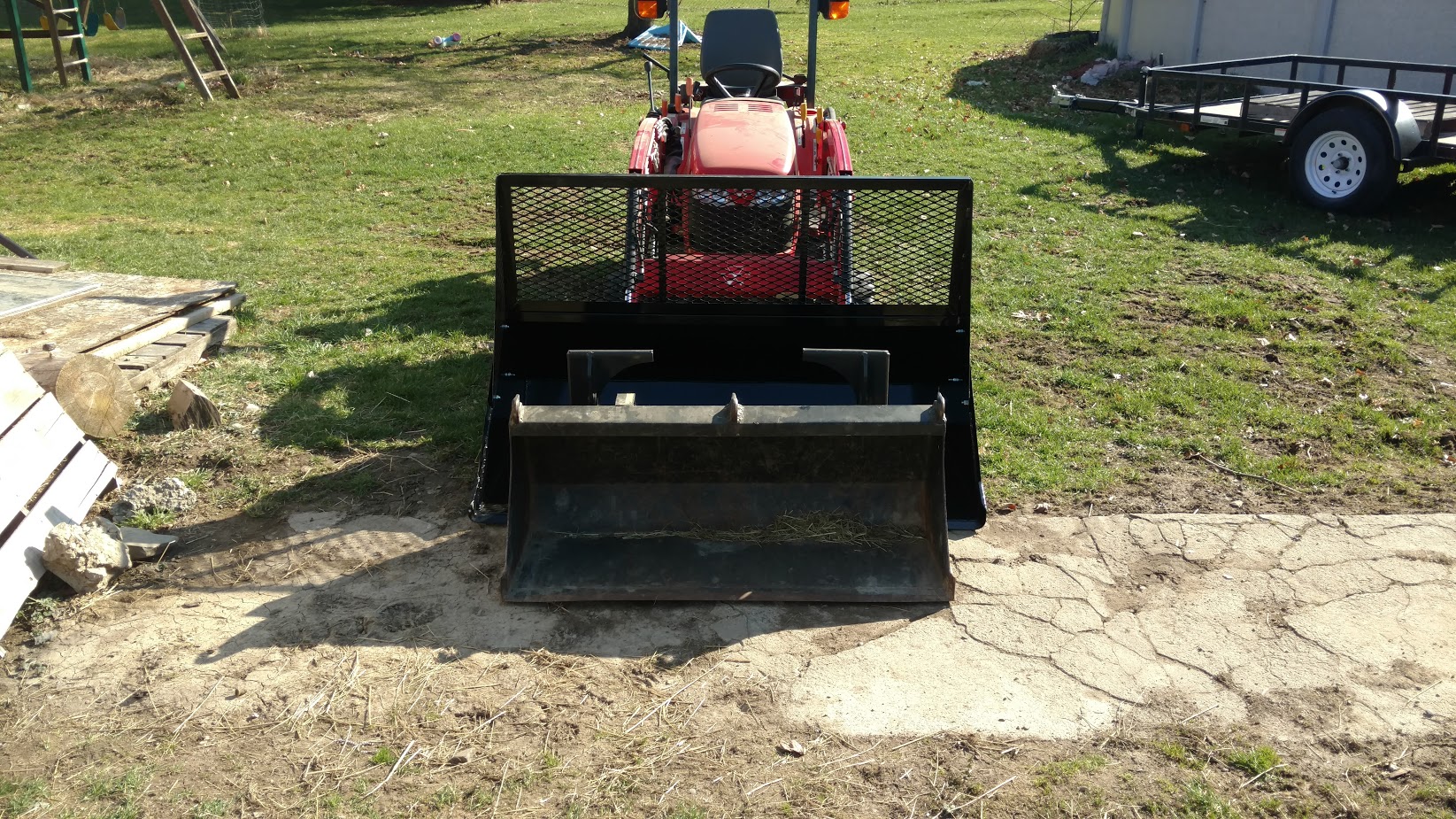

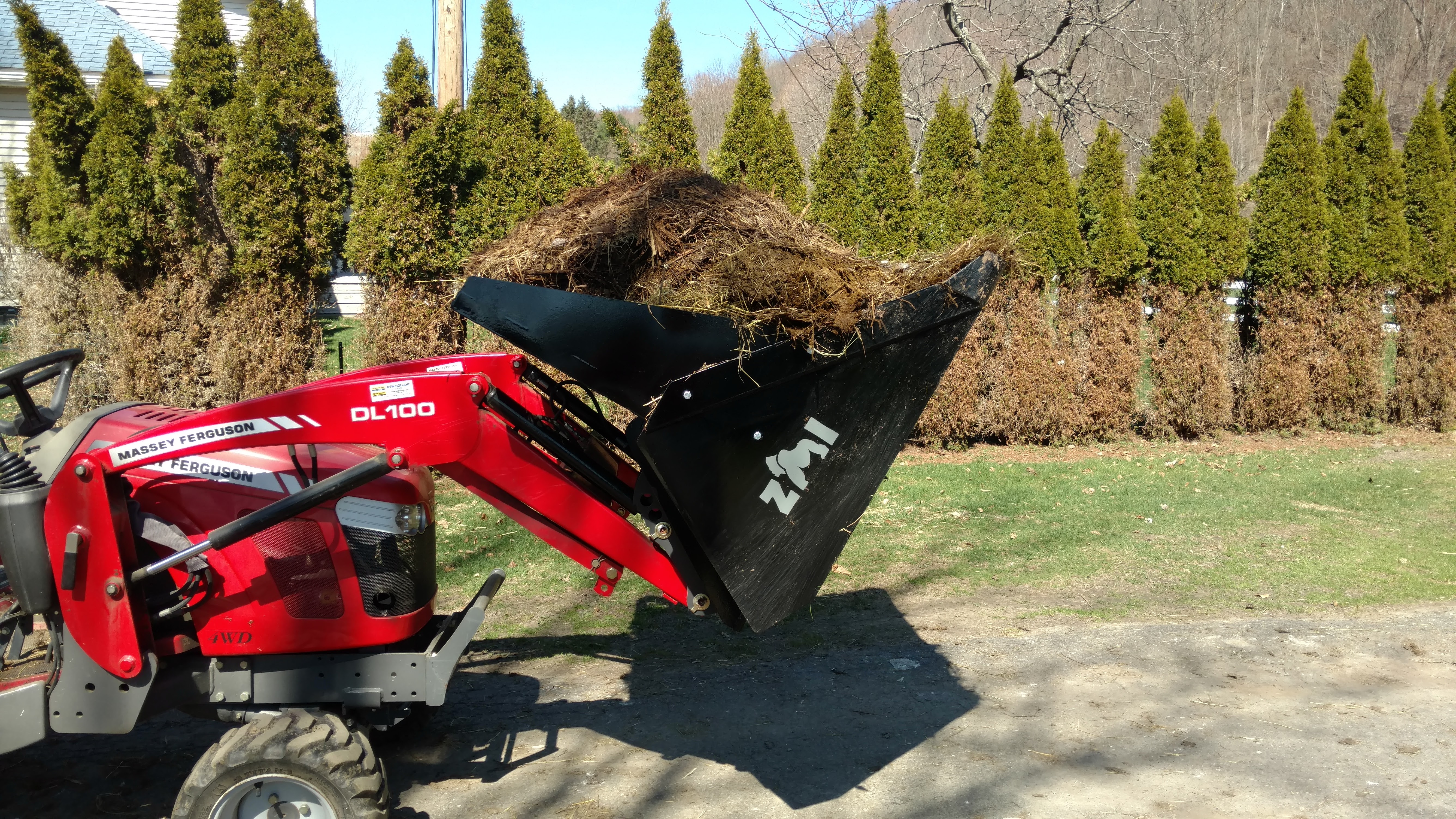

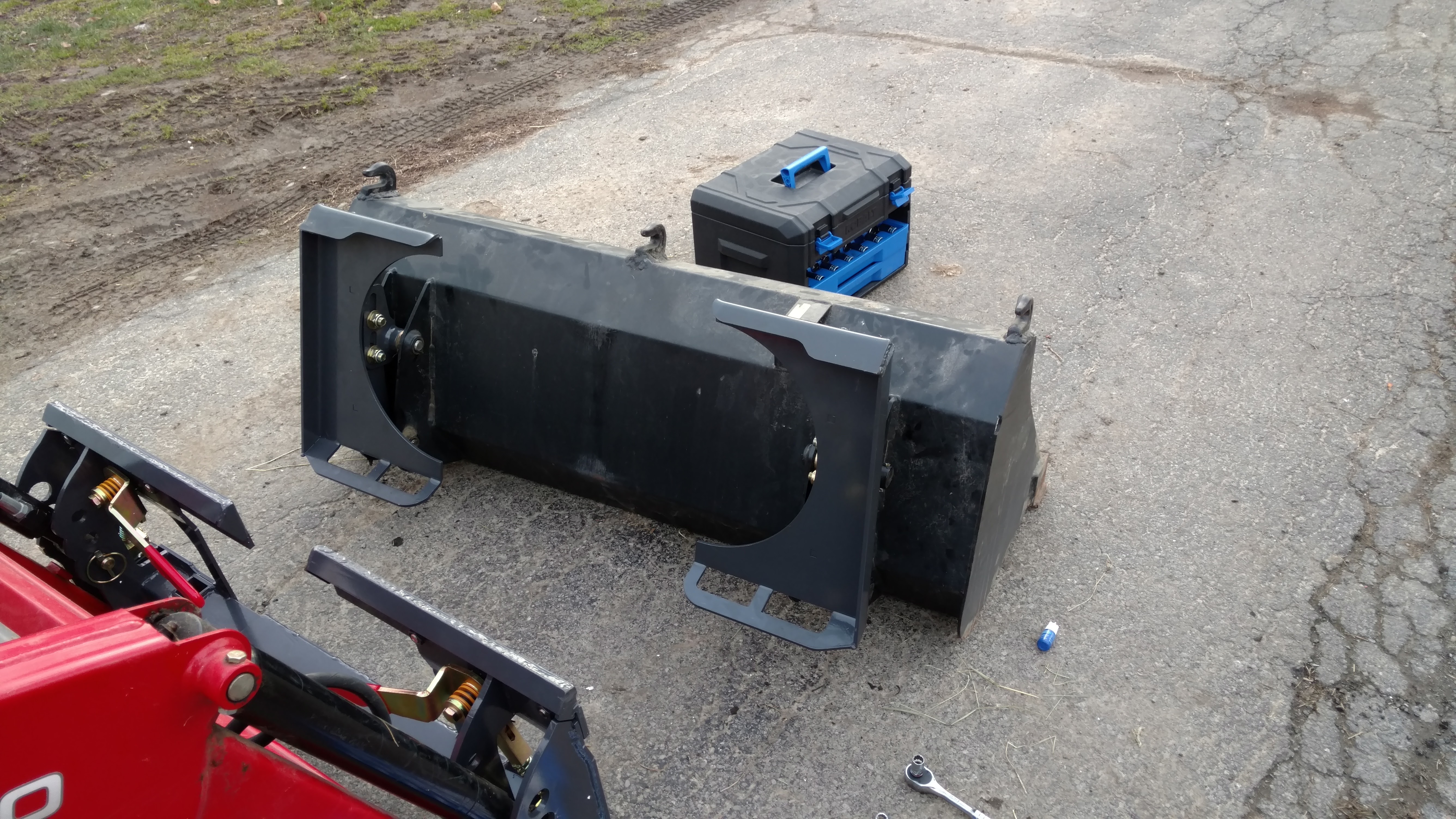

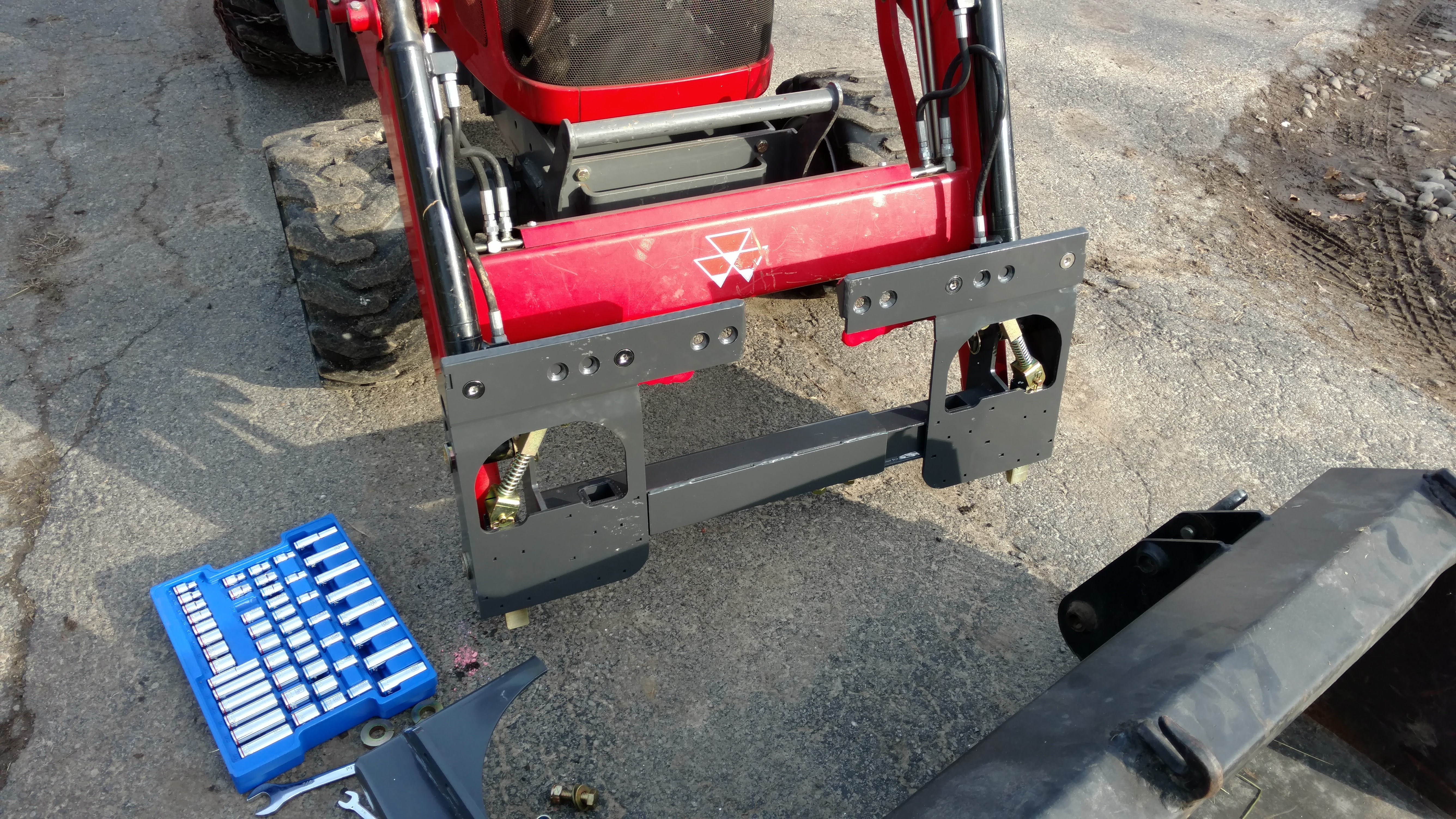

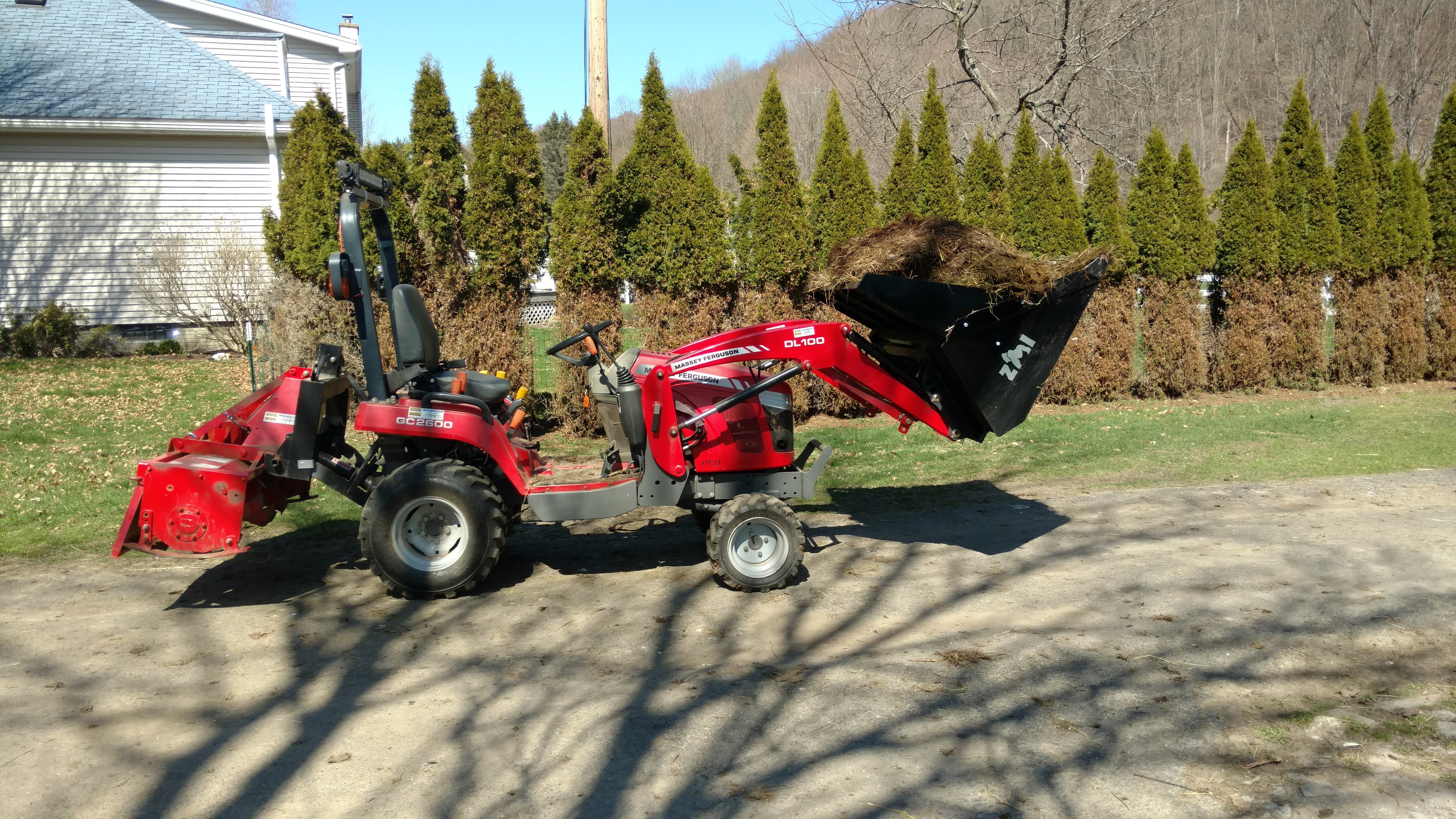

SSQA kit is installed, works great. I did have to mill an extra slot on each bucket adapter plate though. The two original ones did not allow for enough adjustment to match the Massey pin spacing. Took longer to figure out how to clamp them to my table than to cut them though. Once done everything connected right up. I did have to move the included spacers to the inside of the bucket adapters and outside of the loader arms to get the QA spacing right so the bucket didn't slide back and forth a couple inches. Though it wasn't hard to figure out despite the lack of instructions. Definitely worth the price paid! New bucket is perfect for cleaning out the barn and moving compost around. Increase PRV PSI works great too. No noticeable speed decrease.
