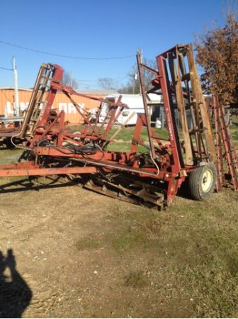

I'm wondering if it would be a Shaw Du-all.

A do all is run after you hip up rows to flatten and prep the bed for the planter. It leaves a flat seed bed and busts up any clods.
Most have a reel looks like a long reel mower.
Behind that are what looked like a drag harrow and last were boards, literally lumber, that left a flat bed.

I would love to have one of those in 12-14 foot wide to drag over the pasture to level out the humps after disking. Those are the best thing for creating a flat level surface that was ever made.
Yeah all the old 4 row and 2 row stuff hard to find.
Price of scrap gets high and folks be broke more dissappears each year.
