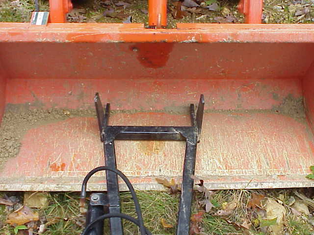

I don't believe that there is a way presently available to mount a Quick Disconnect plow to the loader arms of a BX tractor. considering the weight limitations of the BX, I doubt that it would be commercially viable to manufacture Quick Disconnect appliances to replace the loader bucket such as those that are available to the larger tractors such as the L48. The best solution that I think that is available is the Kubota Quick Disconnect front mount hitch as used with the Snow Plow, Snowblower, Sweeper. This requires the removal of the loader bucket and the front grille guard to install the Quick Disconnect. Just like you won't find the amenities of a Cadillac class car on a Chevette, you won't find they variety of options for a BX as you would the L48 class of tractors.
The best suggestion that I can make for using the loader bucket along with a snow plow is to purchase a 54" or 60" garden tractor snow blade and then weld "ears" onto the bottom of the bucket to hold the plow hitch frame in the bucket. This will allow you to remove it when you don't need it and install it quickly when you do. I have seen this done many times with larger tractors. Just remember that the BX does have its limitations as to how much snow that it can push, even in 4 wheel drive. I refer to the BX as the "Bulldog Xperience" tractor because of the similarity to the Bulldog, however, it isn't ever going to be a Great Pyrenees, no matter how hard we try.

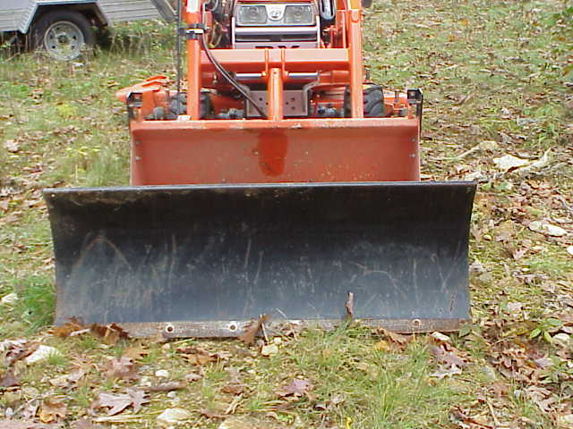

What it would look like on the bucket side ....... you would need to weld in some "ears" to hold the "A" frame in the bucket. This is a Bolens HT20/23 54" snow blade left over from when I used the Bolens to plow snow. It is headed onto e Bay with some other of my Bolens items. Since buying the Kubota BX, I haven't sat in the Bolens except to move it out of the garage.

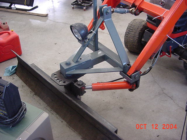

I've installed a 3PH blade to my loader arms and was also worried about hitting something and bending my loader arms. I tried to be as cautious as I could be, but last week, I hit a protruding pin beside my driveway while ploughing the snow. It stopped me quick, and luckily no damage this time. Here's a picture of my set up. I've posted this on another thread earlier. I've used the bucket cylinder to angle my blade, and put in a fixed link to replace the bucket cylinder's original location.

I was trying to find a way to attach it inside the bucket- never thought of doing it the way you did, but your way is very ingenious.
My Snowsport plow has a very thick rubber edge on the bottom that it replaceable. Something like that might make a spring assembly unnecessary.
