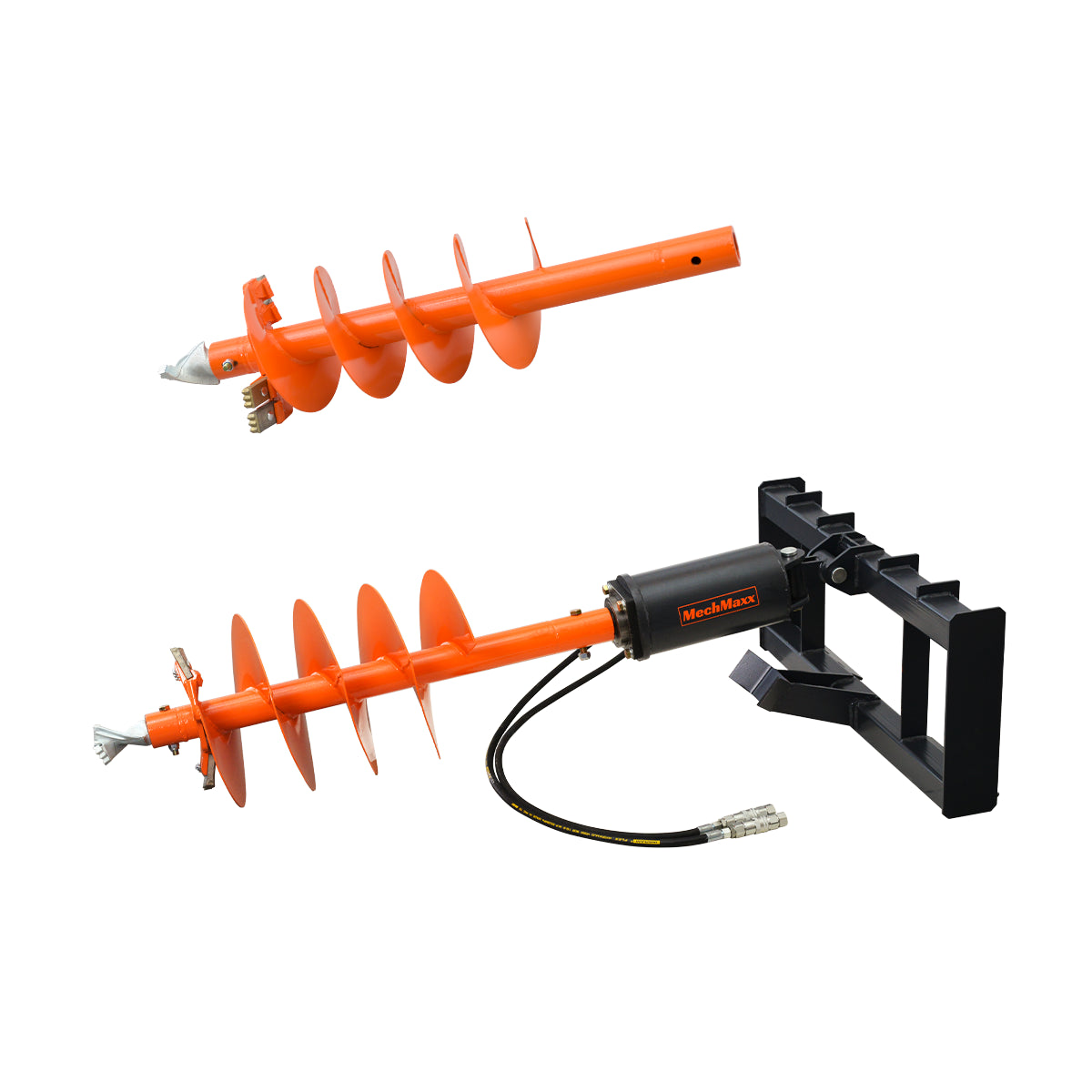

2023KIOTI NS 4710
Assuming the flow is sufficient?
I would figure they do, but there might be some general concerns regarding forces on the loader that wouldn't be present for a skid steer?
looking at this front end auger in particular but asking, really, in general.
this says designed to run on machines rated at 5-17 GPM
would be running on Kioti 4710 (advertised flow rate of 16.5 GPM)
TIA.

Your auxiliary flow rate is considerably less than 16gpm but for an auger it’s not a big deal. It will work just slowly.

Should be able to run the auger, you have adequate flow. SS's have flat faced couplers, not hard to change you just have to buy some Pioneer couplers to make the hook up.

"Rated to 2250". Most tractors run about 2,500psi & skid steers hit 3k. You probably want to avoid that one. Also the offset mount on mine looks funky & wrong. But it means you can see it from the cab instead of it being hidden behind the hood. You have enough problems bumping the machine forward or back to keep the hole vertical as the boom arcs when it raises & lowers.

Yes, is the short answer. An auger isn't going to put any particularly higher than normal stress on a loader, unless you got into some odd situation where the auger was in a hole and the tractor slid sideways or something like that. I would be concerned about the quality of that particular auger, but for occasional homeowner/hobby farm use, it may be fine.

Yes, they will work. That particular one, :cautious: maybe overpriced. They are on FB from 1300 up (Vesta, Great Bear, JCT, etc) May be fine depending on your use. I’d look at Eterra, Digga, etc before deciding.
