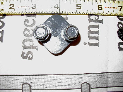

I have a B2150DT. I am looking to hook up a wood splitter, hydraulic top link and other hydraulics behind the tractor. I have read that some have used an optional rear hydraulic outlet block. I looked all over my tractor and cannot find where this block might bolt on. I may not have it I guess. I don't really want to hook into the PB circuit of the loader valve because my loader valve is installed on the loader frame (which can be detached from the tractor). Also, if I had rear hydraulics, I guess it would be open-centered also.

John, I suppose it's possible you don't have that outlet available; however, I suspect that you do. Look on the right side of the "cylinder case assembly". That's the top or cover on the 3-point hitch cylinder under the seat - the part that the lift arms are attached to on each side. When you don't have the optional outlet block installed, there's a cover (they call it a "cap") that's perhaps 2" square, but bolted on with two 10mm bolts so it appears diamond shaped; i.e., the straight edges are not horizontal. It's easiest to see from the rear of the tractor.
Bird
   / Do I have a rear hydraulic outlet block? #3
John, I decided to go out in the shop and see if I guesstimated sizes right, and I did not. The cap that you remove is nearly 2" diagonally and the bolts need a 12mm wrench instead of 10mm. Attached is a picture of the one I took off my tractor (it's laying on a piece of old newspaper with the bolts stuck in the holes).

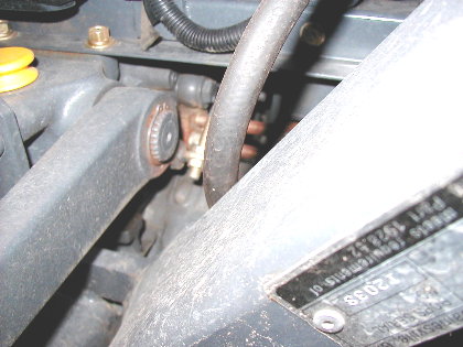

And this was a try for a picture of the outlet block that replaced the cap. It was dark in there, so I didn't do too well, but it's a block, right in front of where the lift arm attaches, and it has two steel tubes that come out to another block that you attach hoses to (all made as one piece)

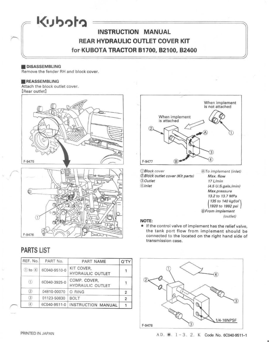

Von & John, I don't know whether the 2150 uses this outlet or not, but since the instruction "manual" (one side of a single 8.5" x 11" sheet of paper) that comes with it says for the B1700, B2100, B2400 and I do know it also works on the B2710/2910, I'm guessing it works on the 2150 (Lots of guesswork, huh?).
And I know less about computers than I know about tractors (if that's possible), but I'm gonna try to scan that "manual" and attach it here and see what happens.
Oops, wrong picture, but at least it's a better picture of the outlet block and hose attachment than the last one (forgot I had this one).

OK, we're gonna try 'er agin for that manual.
Well, I re-sized it from 205k down to a little over 100k and it's still too big, but at least you can see better what it looks like and where it is. The manual says to remove the right rear wheel to install it. That would be a ridiculous waste of time. It can be easily done from the rear without removing the wheel.
