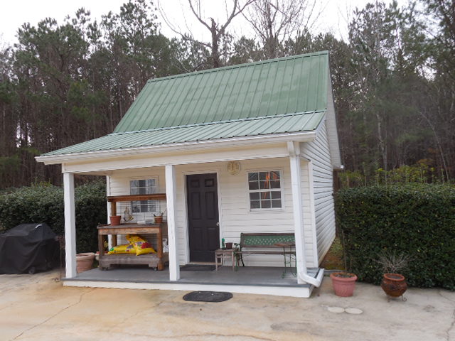

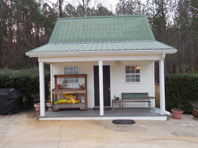

Are your sure you should call this a pump house? Sounds like a large shed to me. :)
yeah, your not kidding about that. When we bought this place back in 2010 we saw pictures of it. Seeing the "Pump House" we though it was some sort of little church or something on the property. Nope - it's a genuine 'pump house'. Here's a picture of it:
