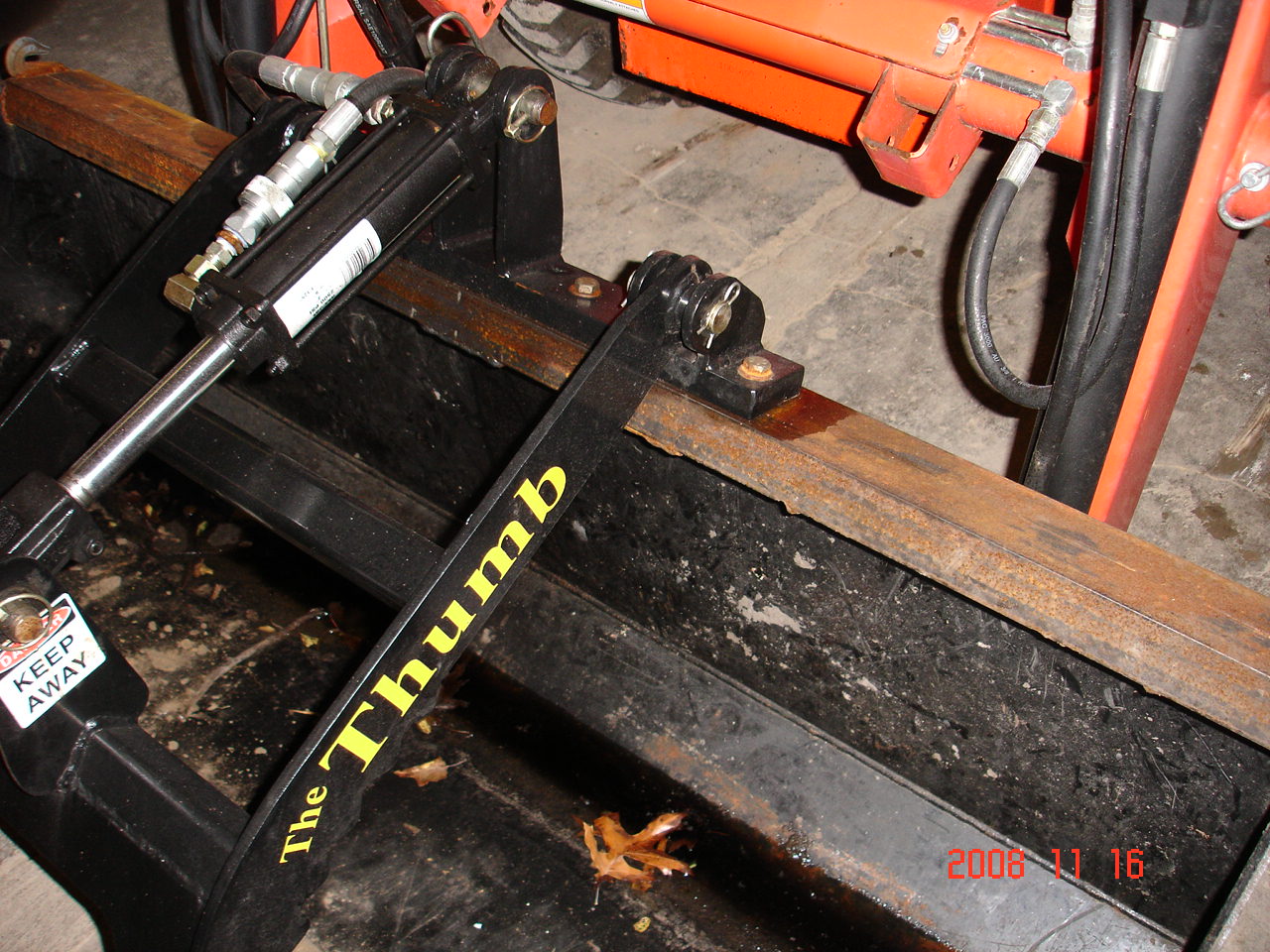

I had this steel so thats what I used . Don't look at the welds, was in a bad mood and had to get it done fast.
Two pieces of angle, with three straps under to back of bucket where the angle iron attaches.

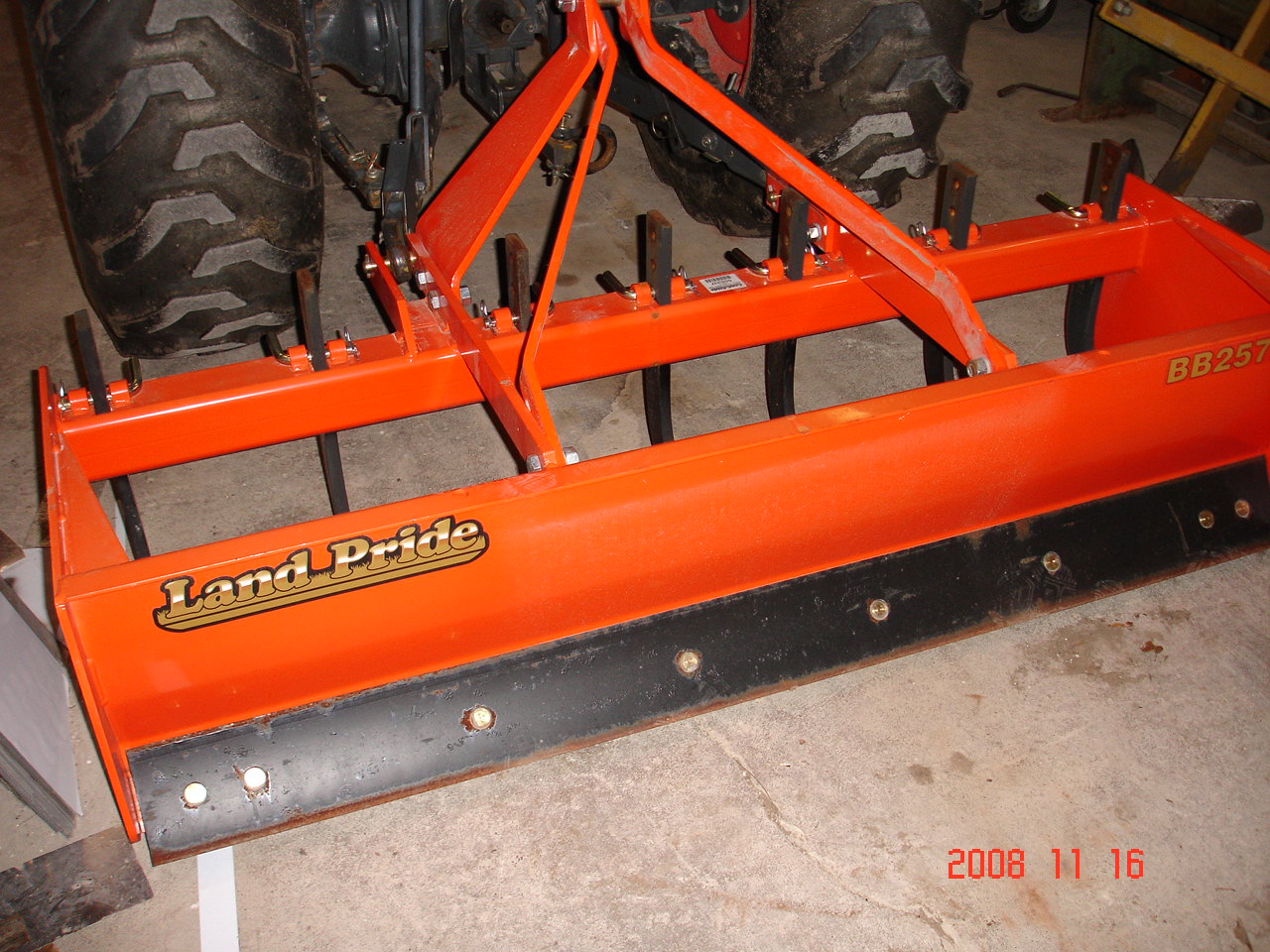

Also a pic of my new Land Pride box scraper, guess they are tied to Kubota Dealers, so you get the Kubota orange.

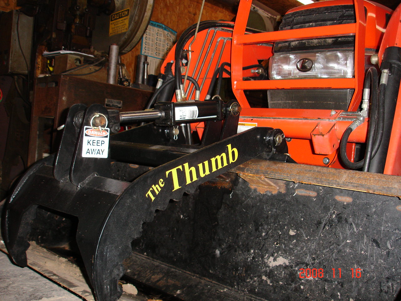

Trust, looks like the Thumb is heavier, shaped better, and John the owner is a great guy. I drove to his shop and picked up mine, would be a good road trip for you Trust!
   / Do I need reinforcement for "the thumb" #18
That looks nice, kind of light, but they say it's for brush.
I use the Thumb for logs, had a whole tree last weedend.
Looks like it's double the cost, but you do get all that steel on the top of the bucket.
