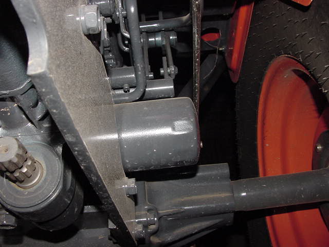

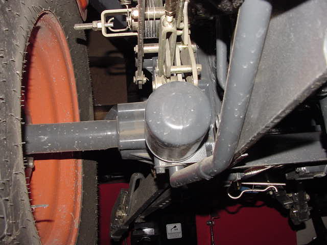

dieznut,
See pictures, if that isn't outside the frame rails I'll eat your hat. :D
   / Do I need to protect hydro oil filters? #14
Gomer said:
dieznut,
Technically you win, I'll give you the two points. I shouldn't have explicitly said "frame". What I meant was there are other things that stick out to about the same degree as the filters. Take the suction filter for example (the one that points forward)... the suction line is pretty much right below it, it would be a miracle if you managed to destroy the filter without trashing that pipe as well.
Two things: (1) The filters don't hang low as on the BX, (2) Typically you'll hit whatever you're going to hit with the front axle first. Occasionally things "pop up" and cause damage but that's the exception not the rule.
