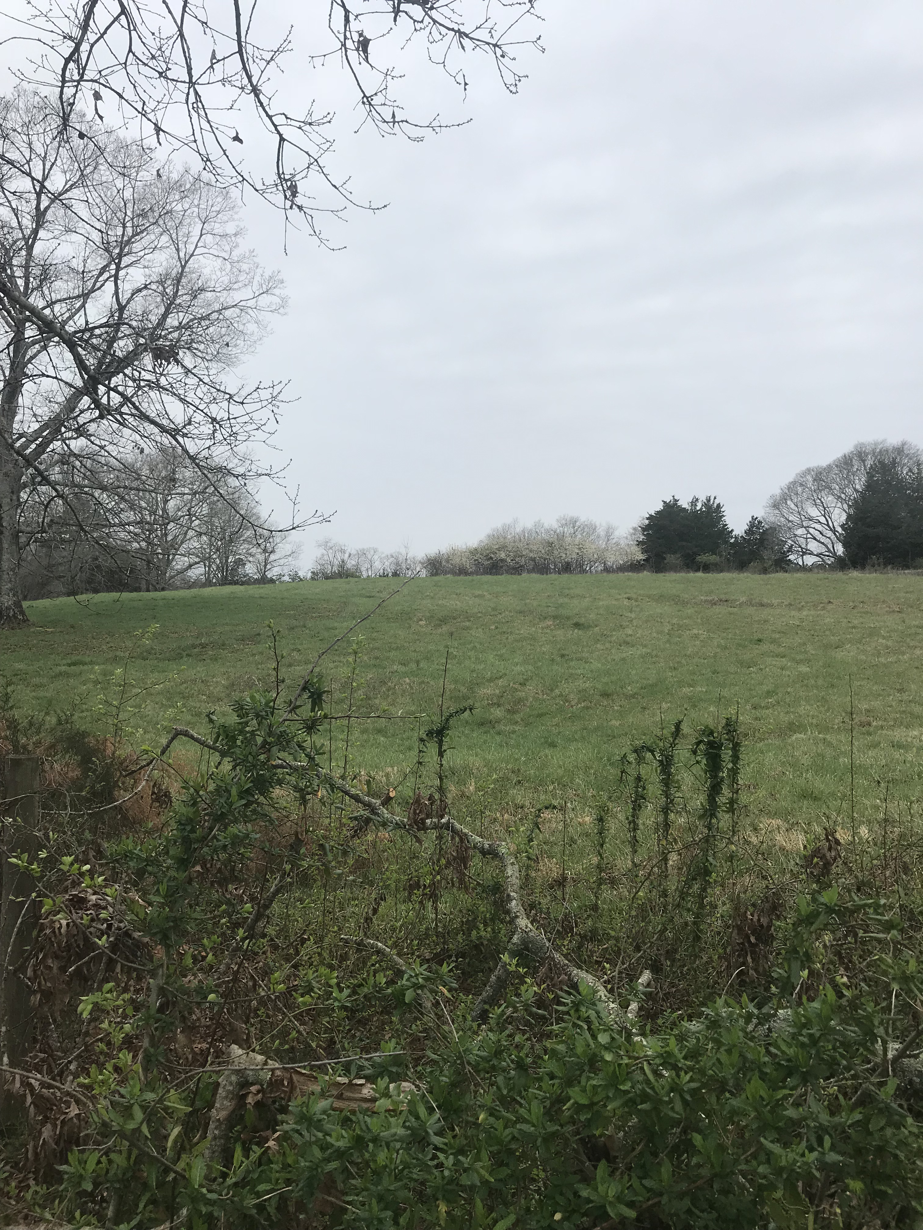

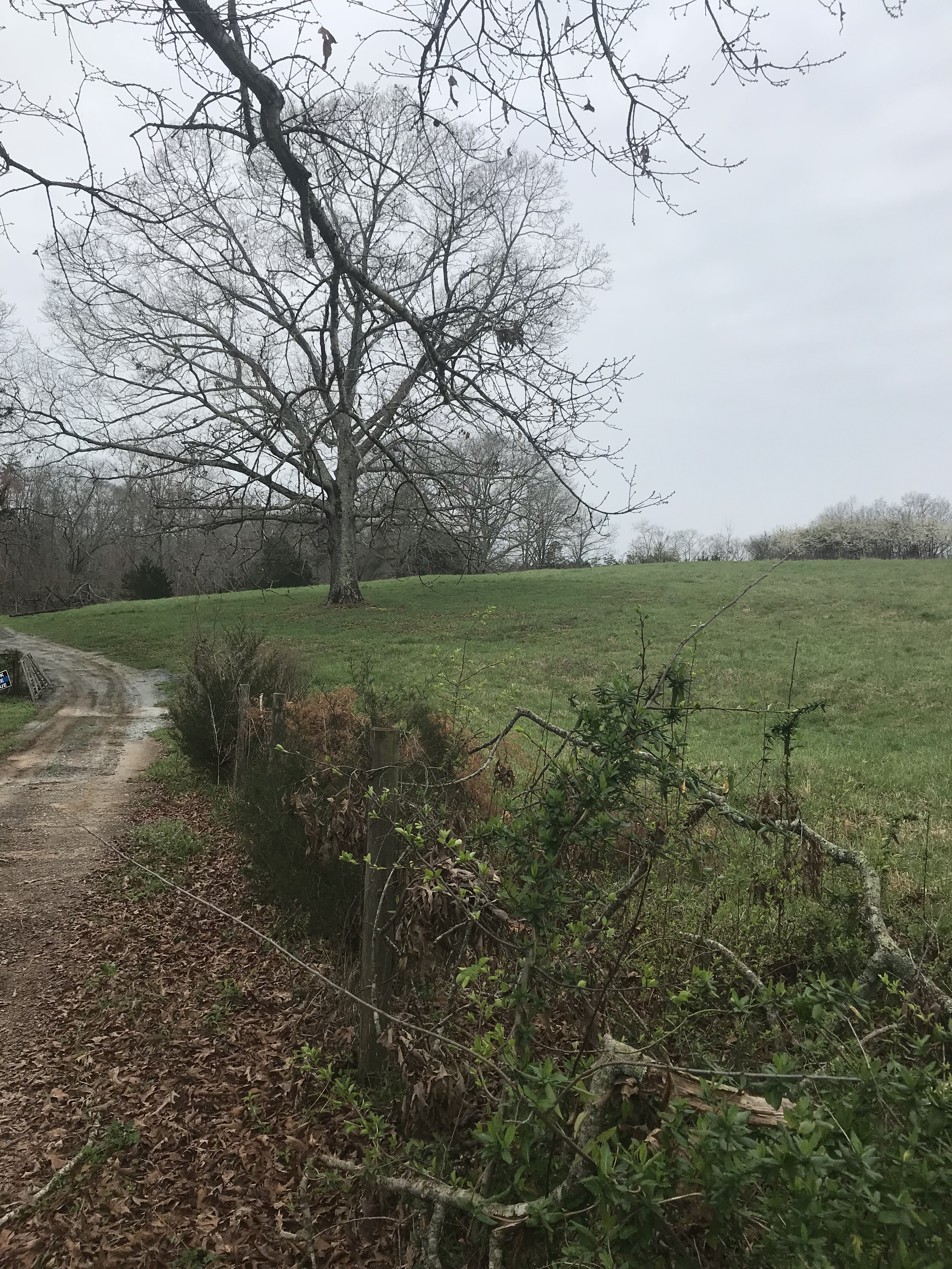

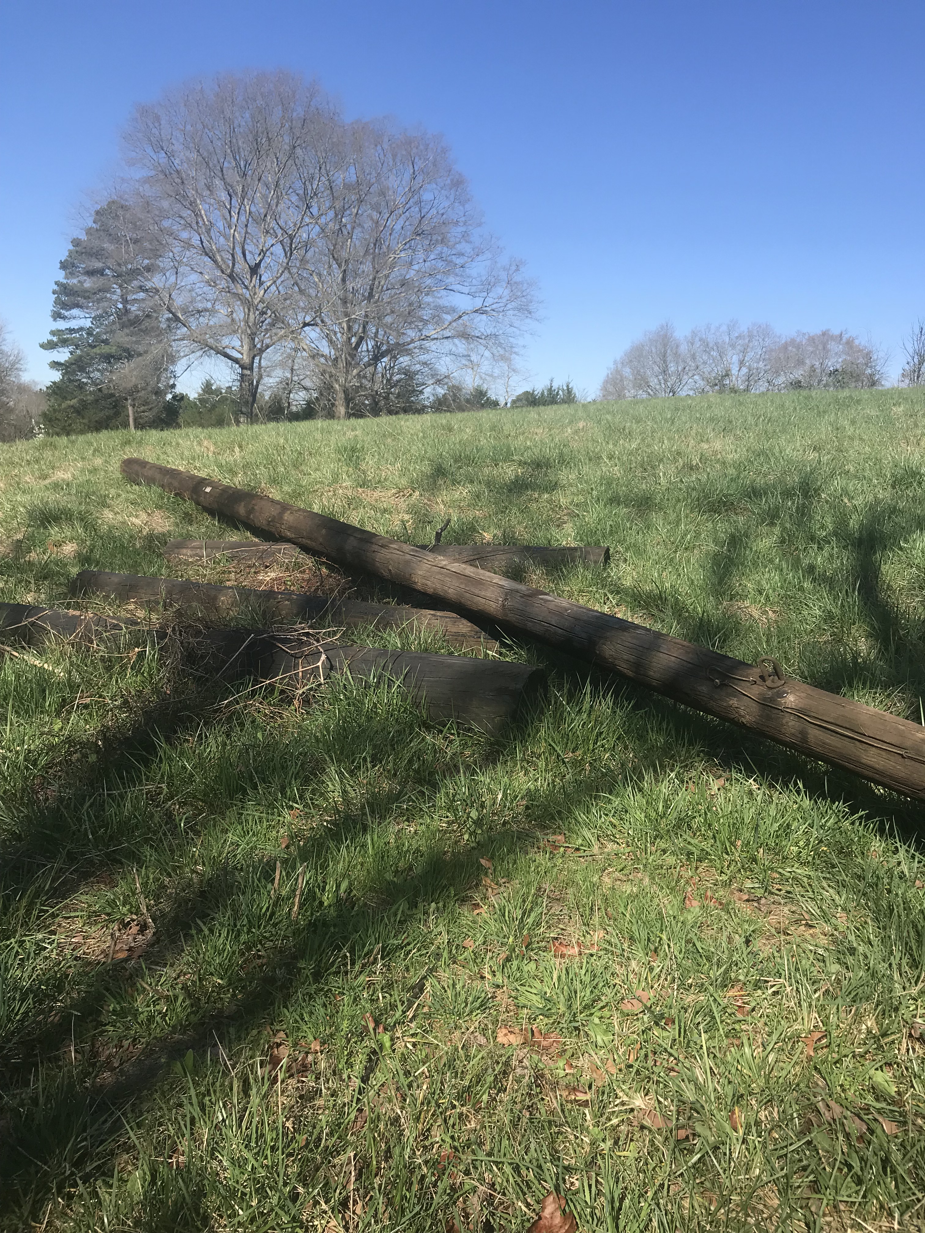

But I still have to deal with my old terraces and hilly ground. Ill throw a few pictures up that might show what kind of land I am talking about... Although these pictures may not show it well... if not Ill take some.
Problem also is that if I buy this thing it kills my budget for a grapple and third function for a little while. And I have to decide what I need most right now. I do still have a lot of stubble in these fields as they were allowed to overgrow for about two - three years and a lot of small saplings of Pine, Cedar and Maple etc where up to about 3" in there. They stand up to about 4" tall in some places. Those have yet to rot out since I just got them all cut this late winter. It might be premature to try a finish mower. I might should tend this another season with the bush hog before I could apply a finish mower? Let those rot out? Hate to let a deal go by but I do also need a grapple for these saplings and limbs and stuff. That would clear even more for the bush hog to get too and to then later apply a finish mower too.

Locking at the photos of your property, I would think a grapple would be your first priority. You already have a Bush hog and a zero torn to do the mowing, but could use another weapon for clearing out brush and debris from the unimproved areas.

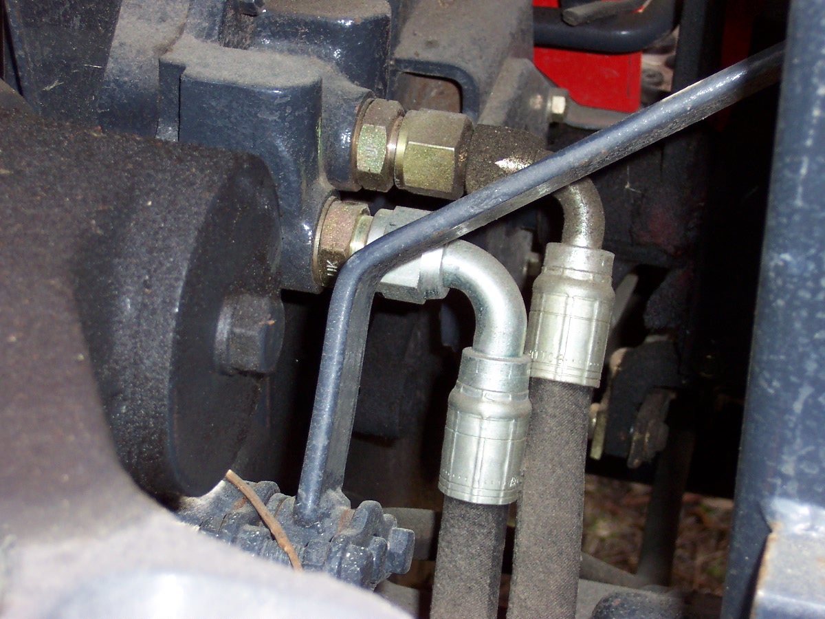

I added rear hydraulics to my 3510 Branson for less than $100.
I added a pressure release fitting to the circuit for safety and when not used on my backhoe I store the hoses/fittings plugged into each other.
