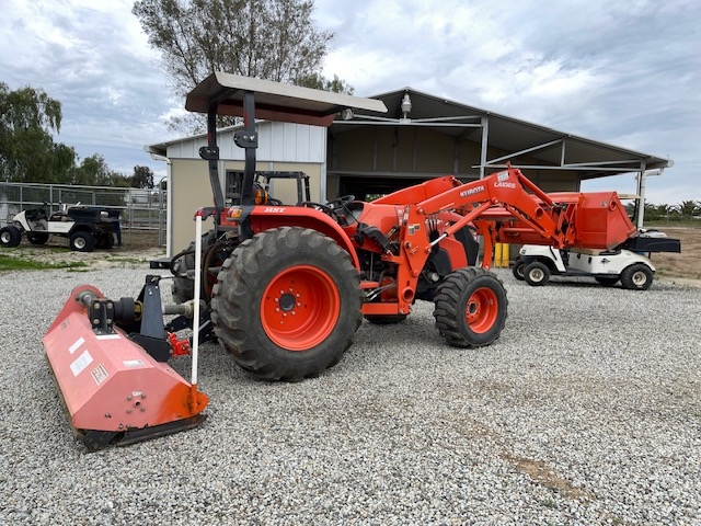

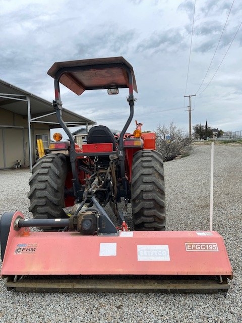

I use a 77" offset flail (Bestco HD) with my 52hp MX Kubota. It's sized just right. 841 pounds. Tractor has filled tires with 3" spacers.
My offset is such that the left front tire rides in the (already) cut grass and the mower cuts a full swath about 1.5 ft outside the right rear.
Great for fence line work. The white pvc pipe gives me an easy to view location marker for the end of the mower without straining my neck when riding a fence line.

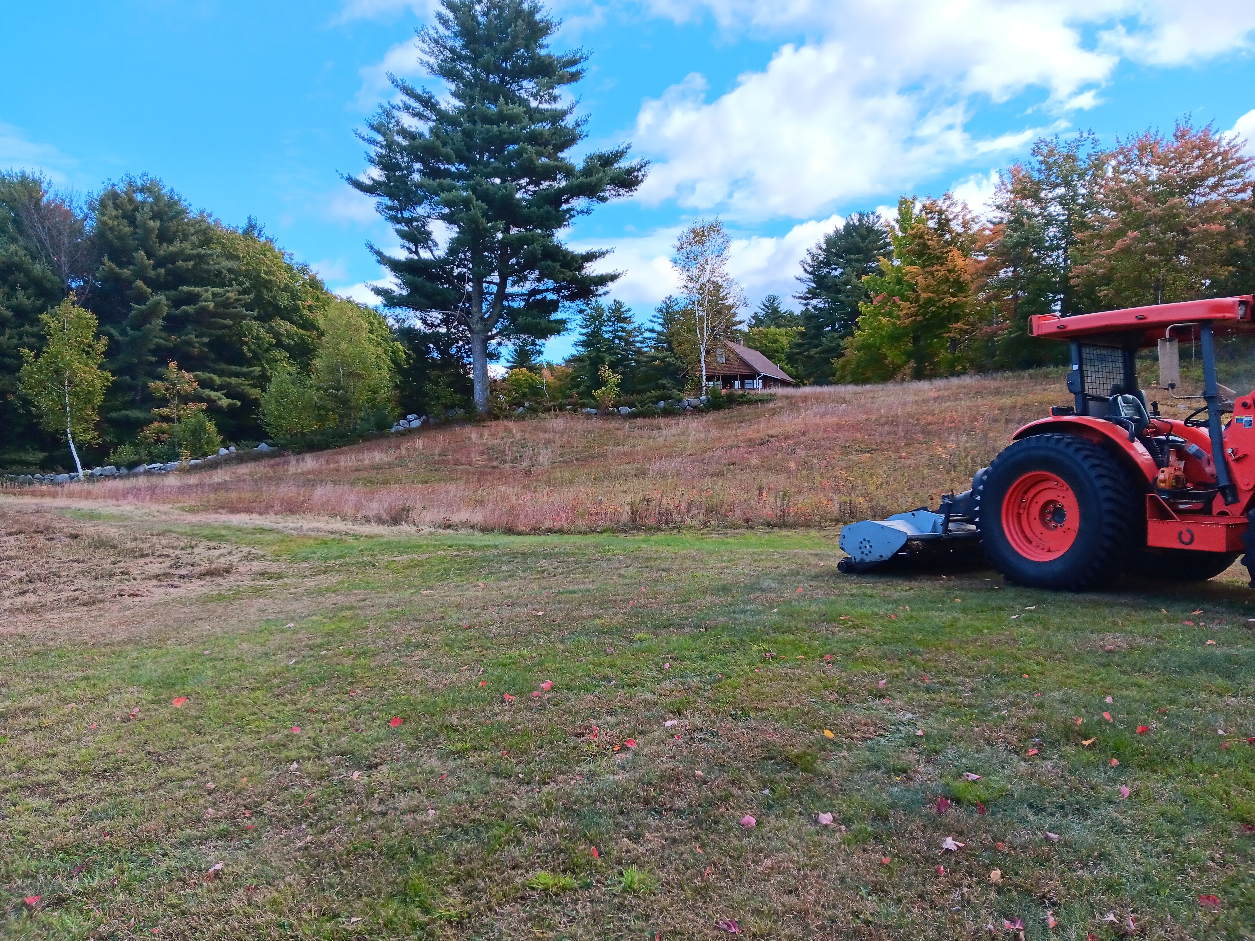

Not a great picture but I found one on my phone.
Might as well show you the view from this guys place.
I cut it once a year for him and he was very generous paying me to use the flail over my rotary.
