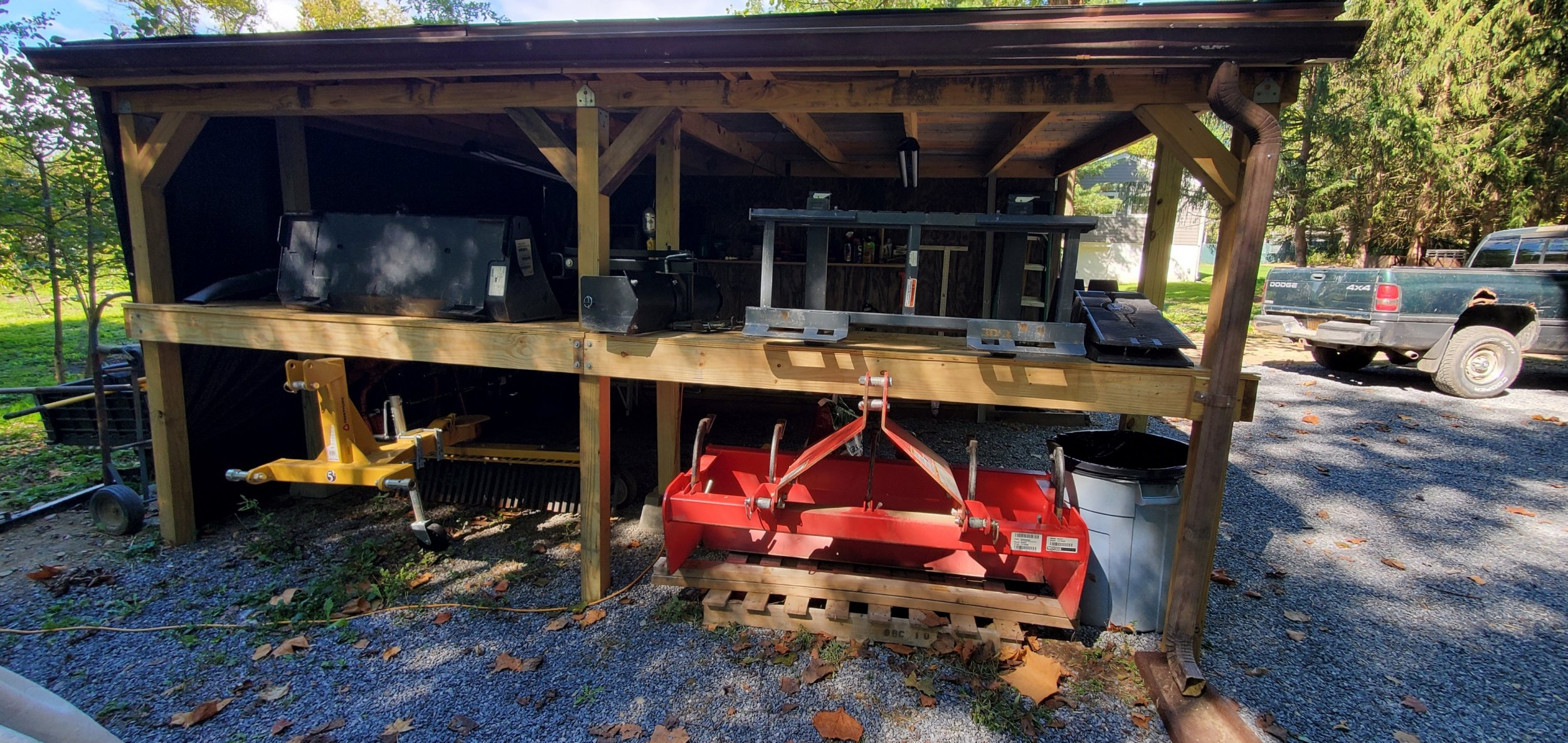

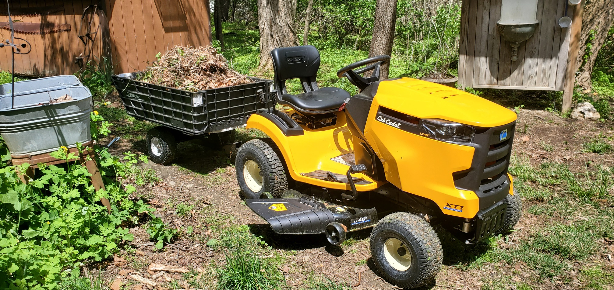

I have 2-1/2 acres, mostly wooded, with a 400 foot long gravel driveway. The little grass I have I mow with a Cub Cadet XT1 with a 46" deck. I bought a Massey GC1723TLB with the backhoe and loader and use it almost every day, to grade areas of my property, dress up the gravel driveway, remove tree stumps, move brush, help my neighbors with projects, to move topsoil and mulch into my garden, spread gravel on the driveway, etc., etc., etc. It's the best investment I have made for maintaining my property. I stay off my grass with the tractor when it's wet. Otherwise I leave tire tracks all over the place. I've had the tractor for 1 year now and in addition to the backhoe and loader I have added a box scraper, pallet forks, a landscape rake, a post hole digger with three augers, a third function kit, a grapple and a quick hitch. My wife said, That's enough already"!!! lol
