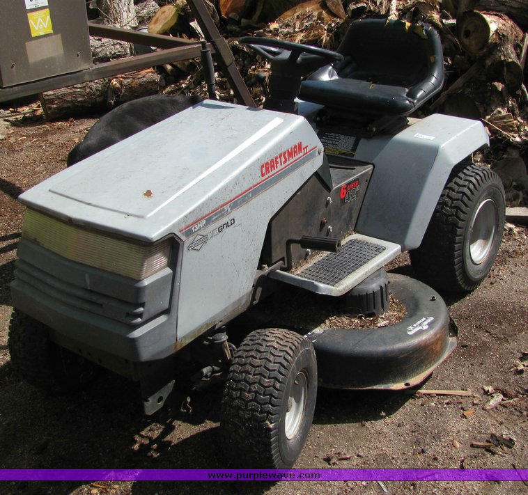

Well, a moment might have come for me. I have a 30-year-old Sears Craftsman garden tractor, I think 13HP, that seems to have given up the ghost. It has served me well, but I can't get it started (it won't even turn over), and since we live in an isolated rural area 80 miles from the nearest Sears, heaven knows who could possibly fix it. I hate to see it, but this tractor has never, never, NEVER let me down. Never even had the belts changed, and it still works perfectly, but now I turn the key and it's just dead, even with a brand new battery.
I'm thinking of just retiring it and getting a new one. I use my big Mahindra tractor for most of our farm work here, but the little tractor is great for things like towing a 40-gallon boom sprayer, that sort of thing. I do NOT need a big, fancy, expensive one with a zillion horsepower. 15HP should be plenty, unless they're measuring HP differently these days.
Problem is, I'm sure they "don't make'em like they used to," and I'm afraid I'll end up with a piece of junk. Are there any common brands out there, or maybe specific models, that have this kind of old-school reliability?

Downslope explained it pretty well. If it cranks when you jump to the starter, the problem is the wiring between the battery, the key and the starter.
If it will crank with a jumper but doesn't try to start, I would try a shot of ether in the intake.

Well, hot diggity dog. I jumped from the battery to the starter, and it started right up. Man, the wonders of the internet... (-; So I can use it now, I just need to figure out exactly where the break is.
I'm ASSUMING the alternator is recharging the battery!
OK, the tractor's running. Now I have some spraying to do. Man, it's good to be alive.... :cool2:

Good to hear, sounds like one of 4 things is causing your problems:
1. A blown fuse
2. A bad keyswitch (bad start position)
3. A bad solenoid
4. A bad connection between the battery, the keyswitch and the solenoid
It is not a bad starter or an engine issue.
I would guess that the parts to fix the problem should run less than a $30.

I concur with what others have said. If the problem is, "won't turn over," it is probably something relatively simple and cheap in the electrical system. If you don't have time to troubleshoot the tractor yourself, it is probably worth taking to a small engine repair shop or putting an ad up on your local Craigslist to hire a handyman to come look at it for you.
Here are some simple troubleshooting steps:
1. Confirm good battery.
2. Turn motor over by hand and confirm it's not locked up.
3. Jump the battery to the hot terminal of the starter motor. Does it crank?
If #3 works out, then you know the problem is electrical between the battery and the starter. Your starter motor and engine are fine. If #3 doesn't work out, the first thing I would do is try a different battery. Maybe jump it off your car (very briefly, because the car's battery puts out more current than your little garden tractor battery).
If #3 doesn't work out, the problem can still be simple. It may be your starter motor is bad.
If the starter cranks when you jump it to the battery, the next place to look might be the solenoid. Jump the solenoid to the battery and you should hear a loud "click" as it actuates. If you don't, then it might be a bad solenoid.
It could also be a bad ignition switch.
The last possibility is that there is a failure in the wiring somewhere between the battery, the solenoid, the ignition, and the starter motor. But all of that is relatively simple to troubleshoot (with a multimeter) and repair, so I would definitely recommend doing some basic troubleshooting and then getting the mower fixed, especially since you like it so much, and it'll be so hard to find something as tough today.
EDIT: Should have read the latest update to the thread before posting. Seems you already confirmed your starter is working.

I hate to sound like an idiot, but can anybody give me an idea what the solenoid looks like or how to find it? I don't have a clue.
My hunch is that it's the ignition switch. A few months ago, the key started getting sticky when I started it, like it was gunked up. You turn the key to "start" and when you release it, it just stays there, you have to deliberately turn it back to the "run" position. Later I will get some metal panels off the tractor and just follow the wiring from the key to the starter and see what I can find. There are areas back in little nooks where there's a 30-year buildup of goo.
Looks like I won't be getting another small tractor, at least. This thing just keeps running and working forever. I need to clean and tune it - it's been 15-20 years since I changed the air filter or plugs or oil - I've never adjusted the belts or anything else on it. I've cut everything from grass to 5-foot pasture ragweed with it, and towed a 50-gallon boom sprayer with it for days at a time. And it still runs and works like it did the day it was new. What can I say.
If it's of any interest, the tractor is a "Craftsman II" 13HP. 42 inch cutters. Model number starts with 917 - it was made by "American Yard Products," whoever the heck that is/was. It was made in 1985-86.
The motor is a B&S I/C Gold, model # 28M707.
The tractor looks exactly like this one, found on Google Images.
