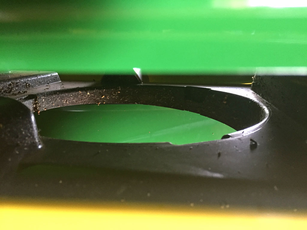

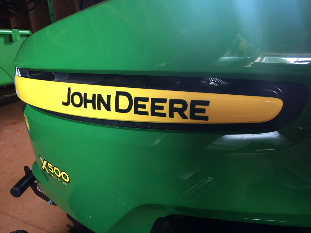

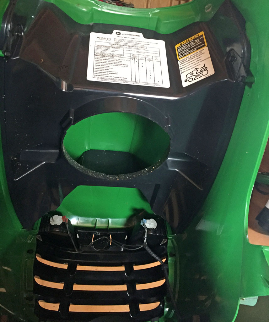

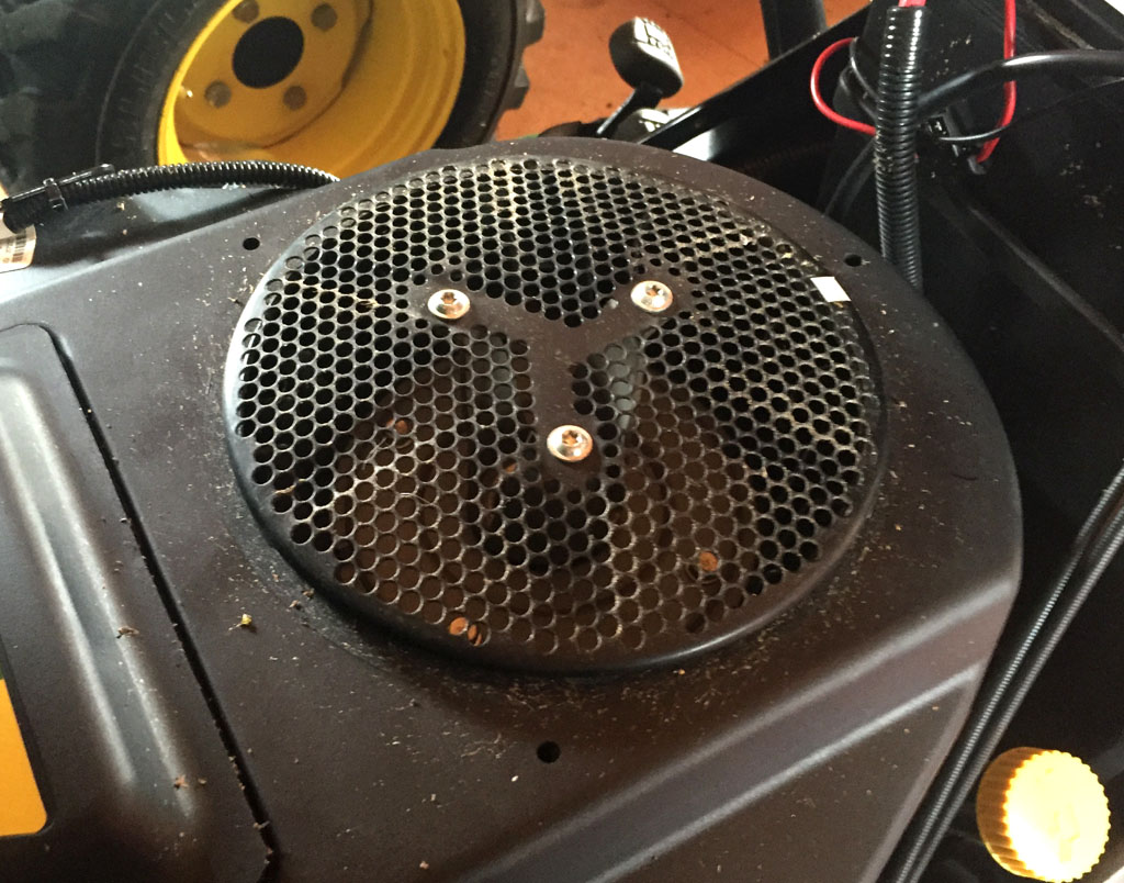

You are correct. The big vents on the side are above the black cowl inside the hood. My point was the little vents on top of the newer hoods are also above the cowl and also only vent the air that comes from the flywheel fan. Below are some photos I took of my X500 this morning. One is showing the view looking in one of the side vents.

That design is to draw clean, cool air for the engine with allows the carb to draw it in for combustion and then sit via the engine tins to cool the engine and force it out the front cooling the muffler also.
Thanks for the photos. I just opened the hood on mine and shined a light up in the air duct. I see what you mean now. I had my heart set on finding a low-hour '14 or '15 because of the "improved" hood, but the only benefit I can see now would be the "newer" look. Again, I thank you.
