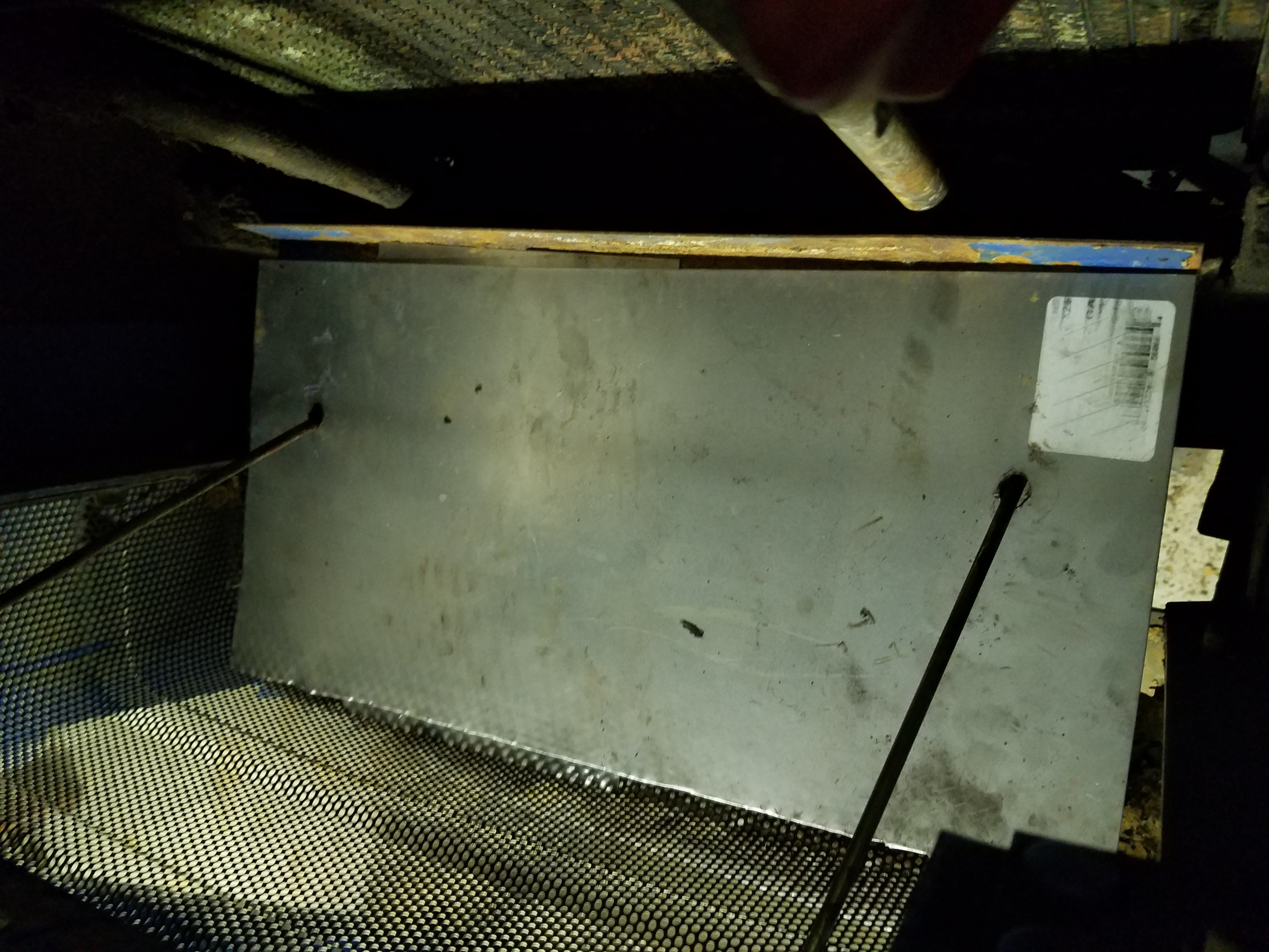

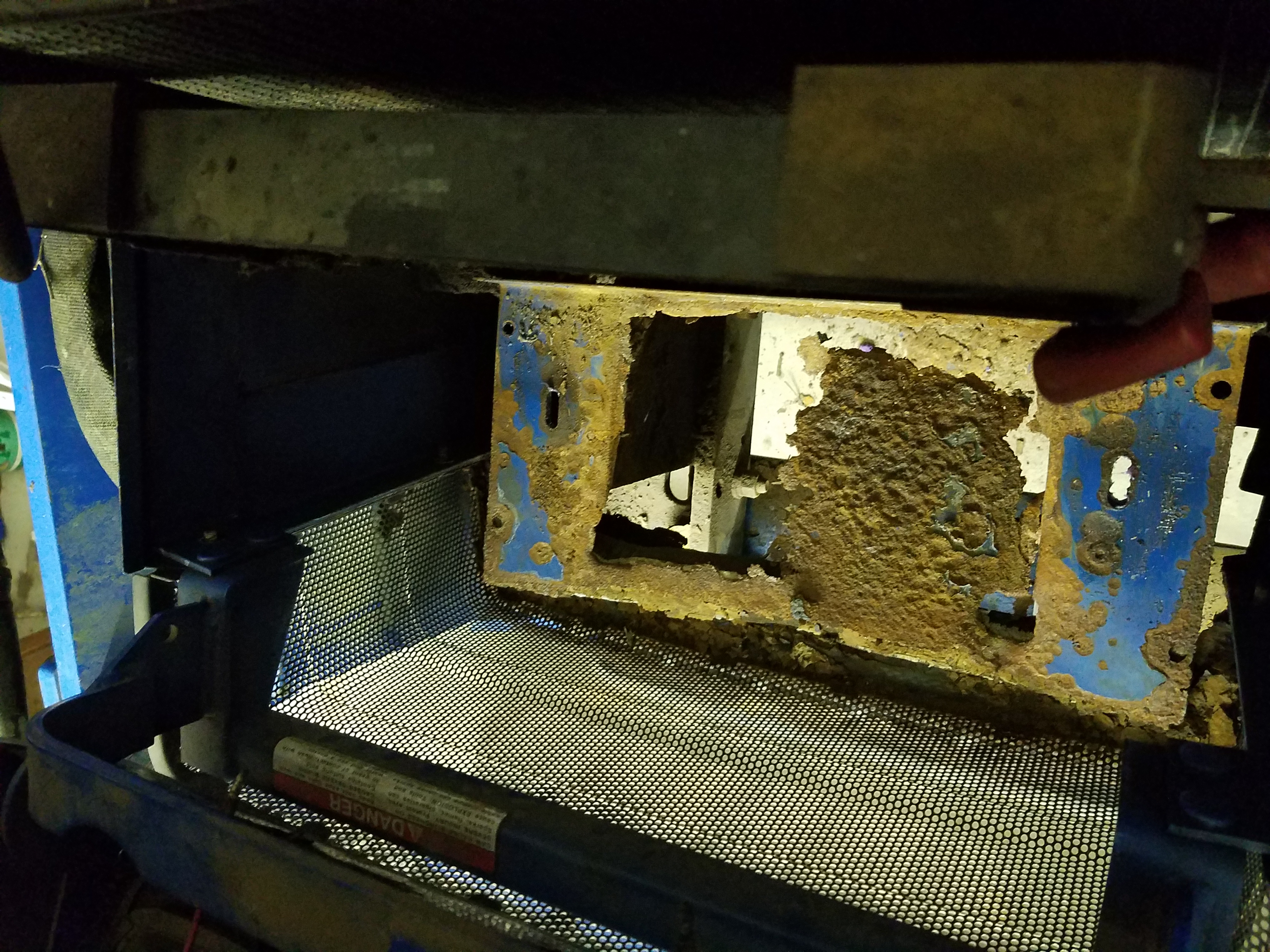

This is what I get for bragging about my 15 year old battery, Saw my front screen was wet, thought it was hydro oil, turns out battery juice, seems it got the best of my battery mount.
   / Do you charge your battery before winter?
#27
That is shocking. It could have blown all over you.
   / Do you charge your battery before winter? #28
A quick fix for that, Will have to yank it out in the spring time..no time now, the winter snows are on the horizon.
   / Do you charge your battery before winter? #29
