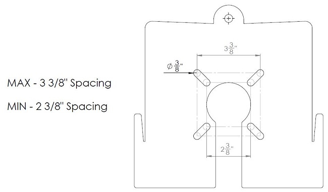

EA...maybe instead of 4 mounting holes have 4 slots. That way any bolt pattern between the 2-3/8 and 2-7/8 would work, even the odd "metric" ones.
We chose to make ours more snug, rather than having the the elongated slots, but we can make one custom, by request.
I've taken a couple orders for 2 5/8" spacing.
Travis
   / Do you hate your rotary cutter gearbox shield? #52
I vote for the elongated holes. Sure would have made my measuring error easier to deal with. ( to get to 2 5/8” by drilling & filing). I made that suggestion today to a nice fellow at EA.
I hear that it is going to be changed to elongated holes, for the ones sent to guys who are upgrading their existing gearbox.
Travis
#58
Travis
I forgot to elaborate on said elongated Xtreme Gearbox Hood holes.
Here ya go.
Travis

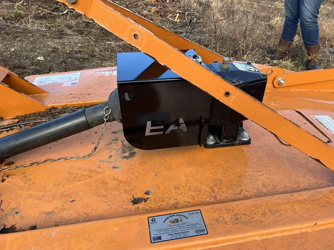

I got the hood for my ruff cut mower painted and bolted on. I will let the paint cure for a while before I put the safety decal on.
It's going to be much easier to maintain the clutch and u-joint now.
Thanks for your modification of the mounting holes E. A.
