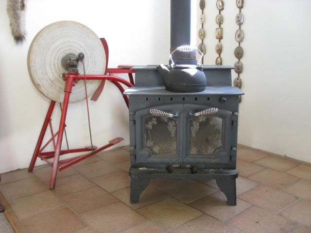

I burn wood in my shop. An old sotz double 55 gallon barrel stove is what I use. Will take big wood, lottsa heat and burn all night. They are hard to find, since sotz went under in the 80's. The cast-iron vogelzang kit is about as close as you can come now. Cheap heat.......
The house is heated with a quadrafire up front....
Lopi in back.....
Even the hunting tent is heated with a sotz round door kit on a cut-down 15 gallon drum......
here it is compared to the 55 drum...
