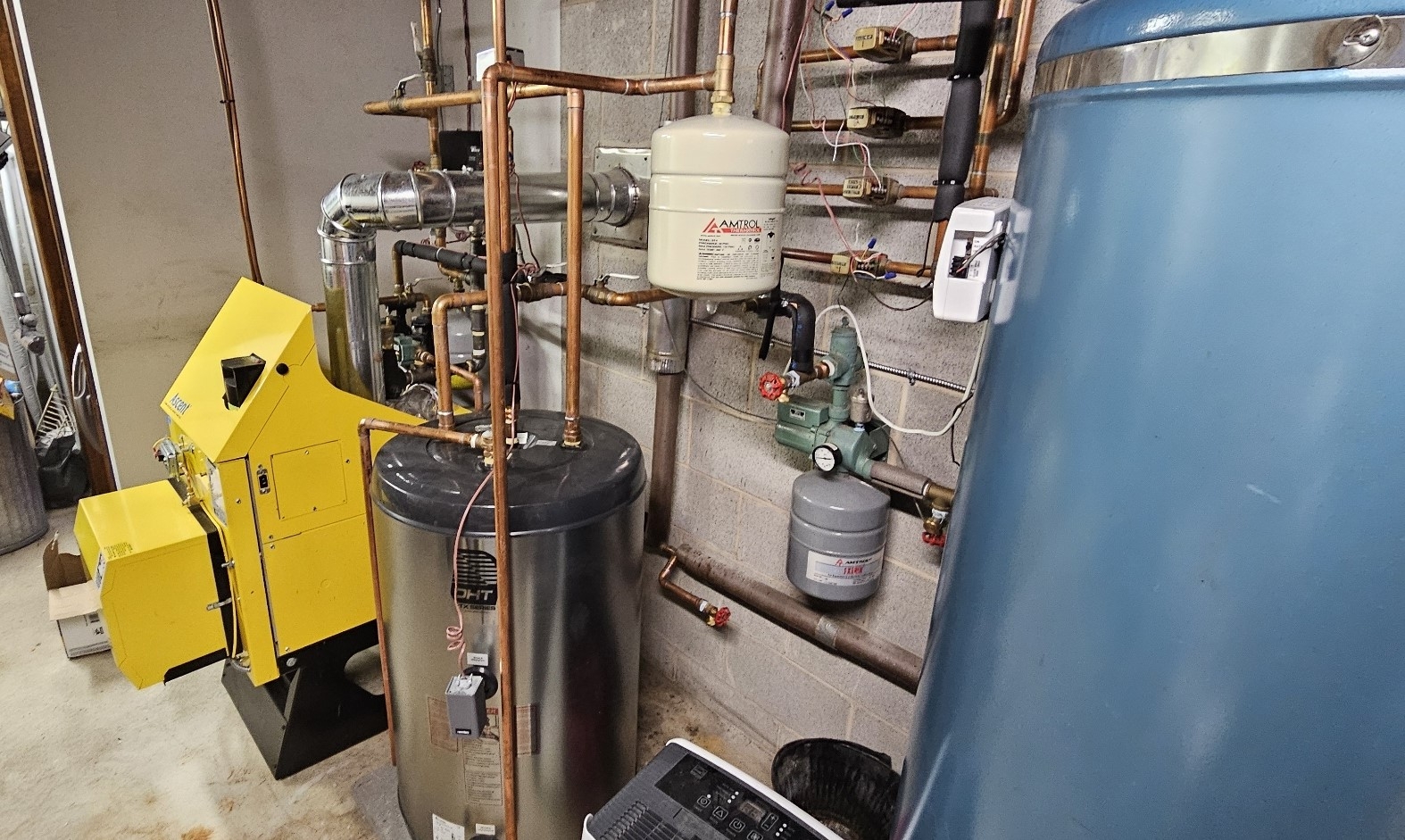

   / Do you have a thermal expansion tank on your water heater? #28
I have three expansion tanks on my system.
One for the Oil burner fill at low pressure, so when the boiler side needs water it overcomes the fill valve. Tucked back behind the burner and grey.
One on the system fill (solar storage and hot water storage) which is 50PSI (light beige)
One on the Solar pump which is a limiter to keep pressure below 20 when it's pumping glycol through the panels. Small grey one
Tried to get all three in the picture. I am on well water and that tank is in another area.
The old solar expansion tank and old fill expansion tank lasted many decades. The one on the old oil burner outlasted the burner itself, so about 30 years!
