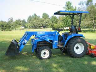

When I posted I merely wanted to help, or suggest. As far as engineering data I am sure 540 is the standard and best at least on paper. However, after 40 years of working on machinery in the automotive industry I have learned that things are sometimes different. For instance I have had several problems with temp guages based on that I have some reservations as to the absolute accuracy of the 540 light on my tractor. The engine is screaming at that point and don't try to tell me that is good. I have rebuilt to many engines to buy into that. Not trying to be a smarty not every piece of machinery will work exactly the same. The picture is a small part of the yard I have to mow here at my place and this seems to be a pretty good cut to me. That is IF it comes through here.
