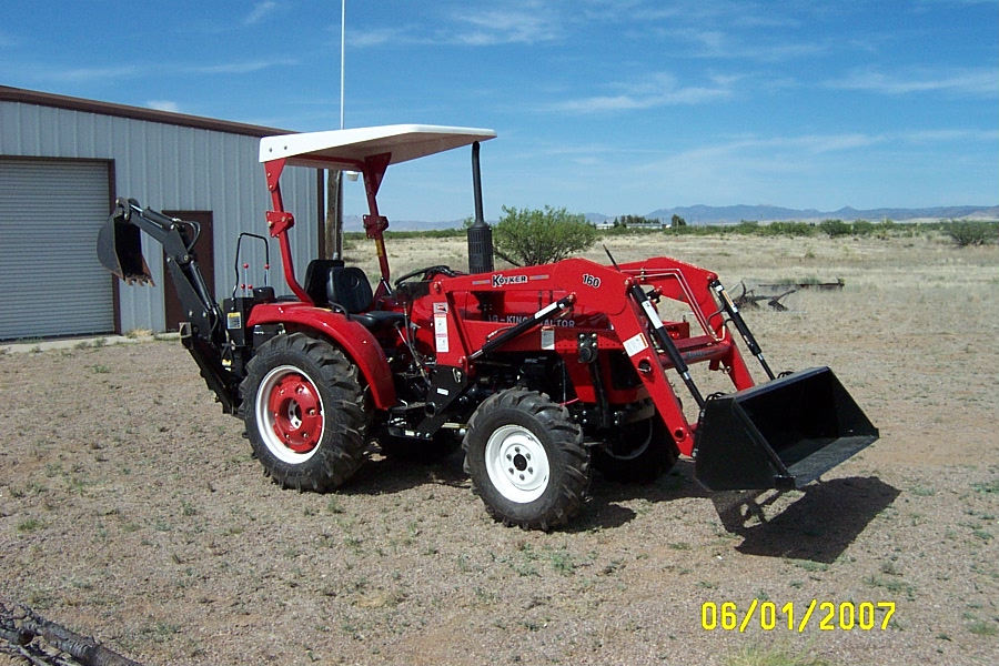

I have the very tractor that you describe with FEL and a genuine 6' Gannon with about 110 hours. The tractor has been excellent with the exception of the rather crude wiring harness. Hard to start in the winter but a lower radiator hose heater and the slightest squirt of starting ether in the air filter air intake always does the trick.
My recommendation is to always buy from a servicing dealer, solves a lot of problems.

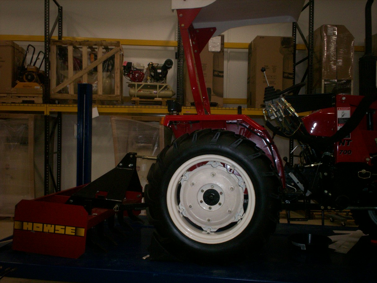

Cacinok said:
thanks wolfman, looks like you picked up a nice package.
yes bti means that the ag king is a jinma, just w/ a different name, much the same way the tractor northern tool sells is named nortrac, but it's made by jinma (at least the smaller ones are).
Here's one from Northern Tool in Dallas.
