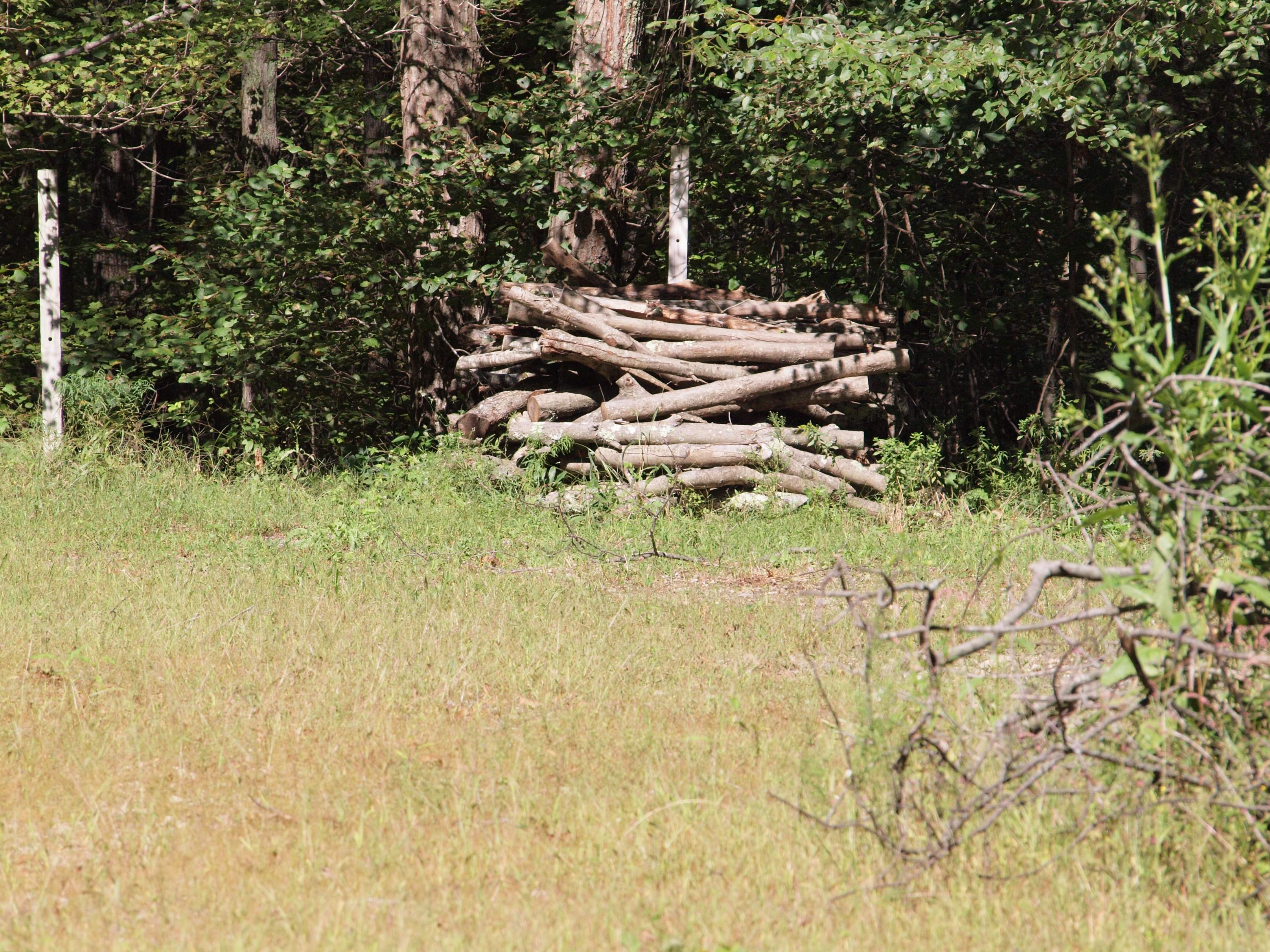

I was going to go the sawbuck route, but I didn't want to bother building, and lifting the wood onto it (no grapple). I have a pile of logs about 20' long. I placed two 6' long logs about 5' apart near the center of the pile and placed a number of small diameter logs (around 6" but smaller than the 6' lengths) perpendicular to the 6' logs to fill the 5' gap. I roll a log onto the log platform and cut from either side until just the 6' center section remains.
The small logs in the middle allow me to cut the remaining length with minimal pinching and prevents cutting into the ground. The worse I have to do is maybe roll a 4' section once to cut from both sides. It's pretty quick and requires minimal messing around. I cut 1-2 logs up and then split and load up the wagon to stack.
I've found this to be the most efficient use of my time. Cut, split and stack small quantities at once. Otherwise it seems I move the same piles of wood 2 or 3 times.

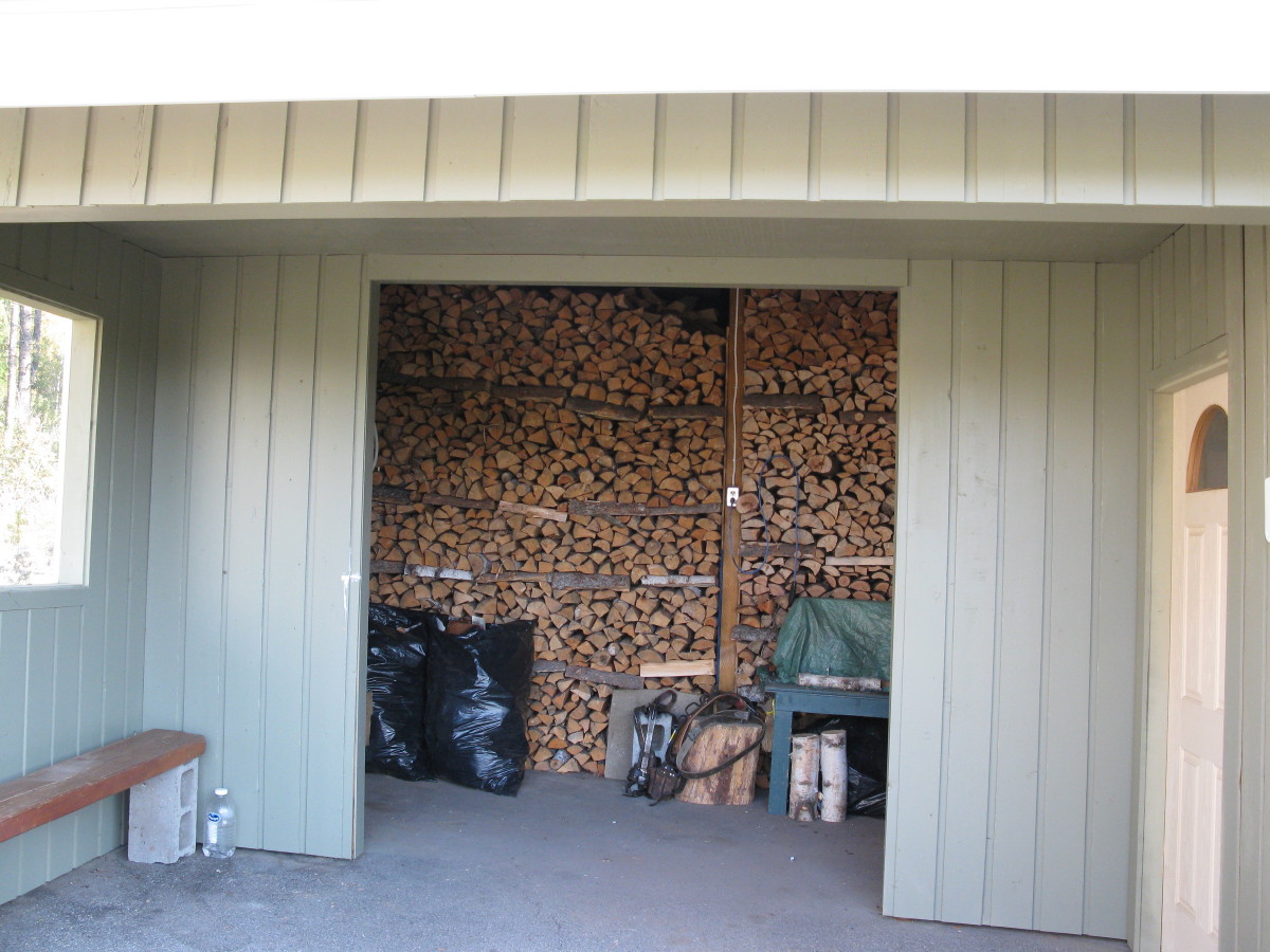

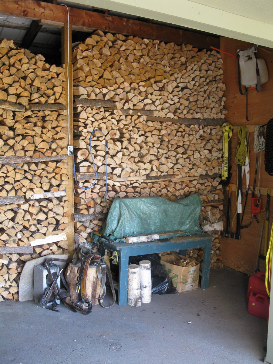

Guilty!:) But it is more a practical matter for me. I have two 8' x 8' x 8 to 10' high bins in my shed (photos attached) that I need to completely fill. I heat with a wood furnace that uses about 4 chords (= 1 bin) per year. As long as I fill the empty bin by fall I always burn wood that is at least one year old.
If I don't keep a consistent 16" length and size the wood pile is unstable.

Another suggestion: the plastic bags in the second photo are full of birch bark which is great fire starter. If you're cutting birch, score the bark by running the saw the whole length. The bark will peel itself.

that is a dandy stack of firewood!
I have to ask: what is a government certified geezer doing with a set of CLIMBING IRONS? (I'm 70, and don't even much like my extension ladder any more. . .)
   / Do you use a cutting area for Bucked logs? #35
:laughing: They are all that save me from wrecking fences, buildings and powerlines with my inconsistent (or consistently random:eek:) falling skills. They are from my 1960's lineman days, and I use them a lot. Mainly just go up 20 or 30' to attach a rope when there is no margin for error in directing the tree. I also occasionally use them to help my local wireless internet provider install radios. He went to great lengths to get internet up my narrow valley. My service runs through two neighbours' places whose internet is through landlines. But they let us put radios on their sites. Great neighbours!

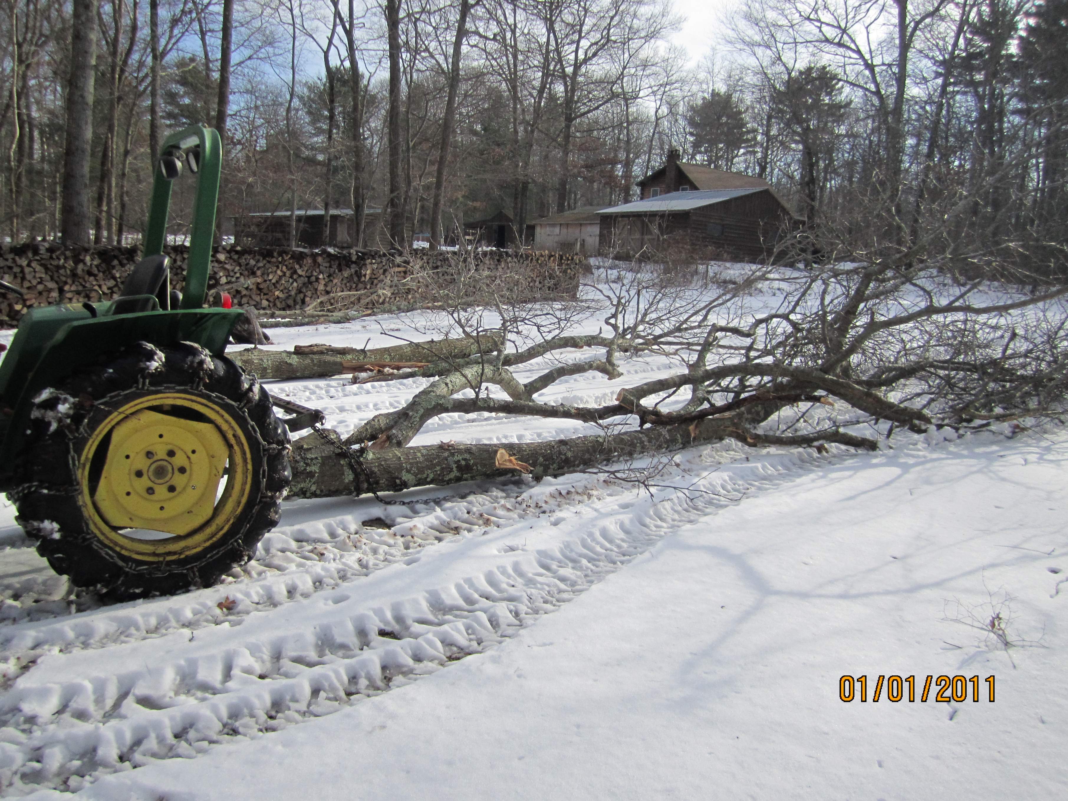

Well Dave you have that beautiful tractor so lets take advantage of it. I'll tell you how I do it which is basically a miniturization of how I used to do it professionally. After the tree is dropped (this is in the woods at this time) I proceed to cut and separate the crown from the stem. Parts of the crown are suspended and these I'll cut with a downward stroke. Other parts may be tensioned so I'll find a space underneath to place the bar and cut upward. I do not mess with the crown much beyond that as there are too many things that can hurt you as the crown is lying against other trees.
Eventually I'll skid as much stem as the tractor will allow to a clearing or landing. I drop the stem and pile it up. Come the next season, I'll pluck the stem from the pile with the tractor and bring it over to the splitter. While it is on the fel, I'll cut it up into rounds. Of course the last piece is on the bucket splines so I'll drop that 6' long piece, make my top cuts halfway or more, turn the log and make my finish cuts. Seldom does my saw hit the ground as it never need to approach the ground. Now I'll go skid over the crowns to the landing as this relieves much of the previousely tensioned "widow makers". I'll cut these pieces from 4 to 6' long most of the time under cutting . I'll stack these up on the bucket splines and dump them in a neat pile. Then , I just cut them up using the rounds as rests for the other pieces cut so I do not have to go near the ground. Many guys use some type of saw horse here or cross buck and cut the smaller 3 and 4" thick pieces with that tool. What is essential in my mind here as tools beyond the chainsaw are wedges, cant hook, chaps and helmet with face screen.
