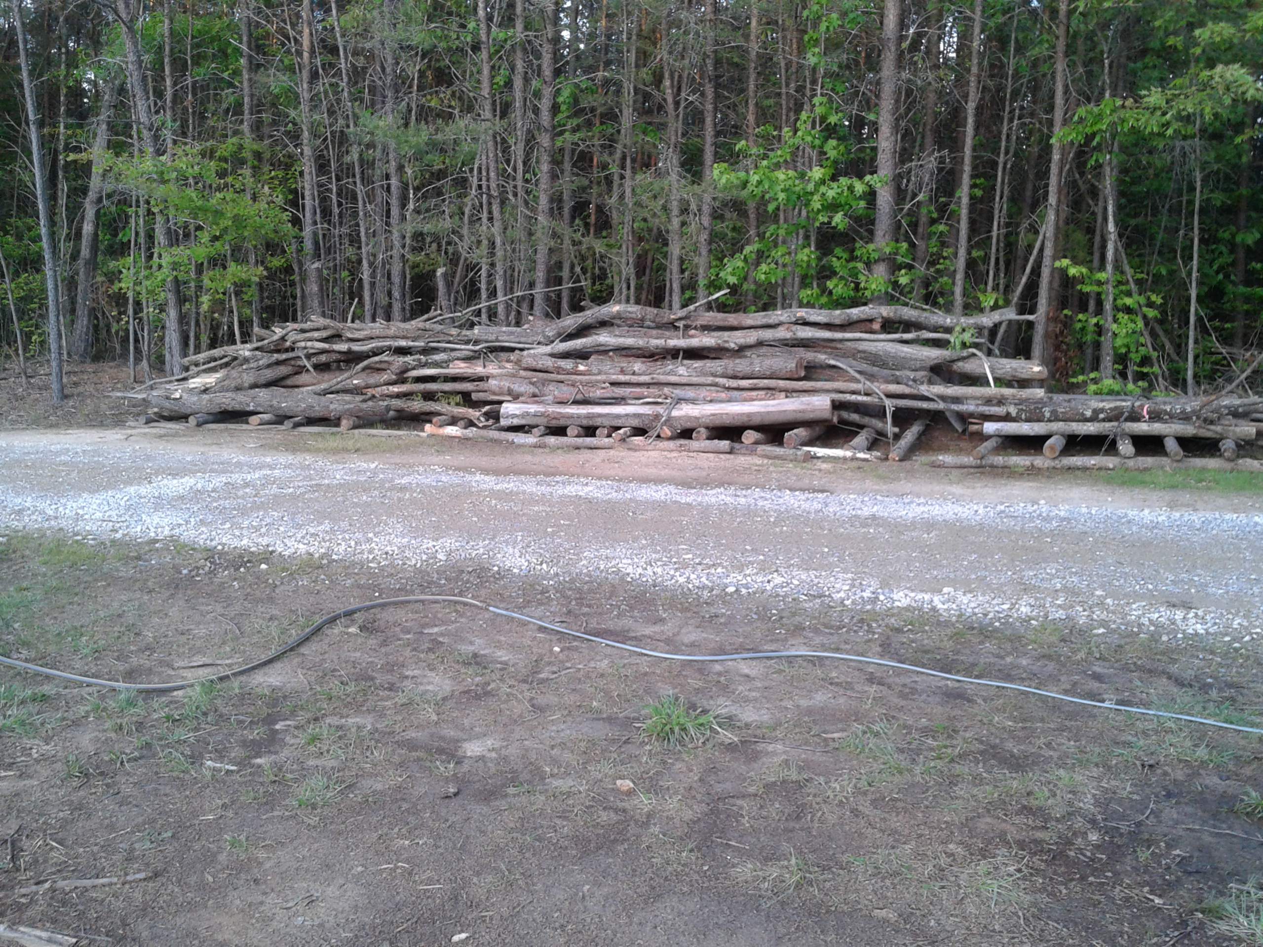

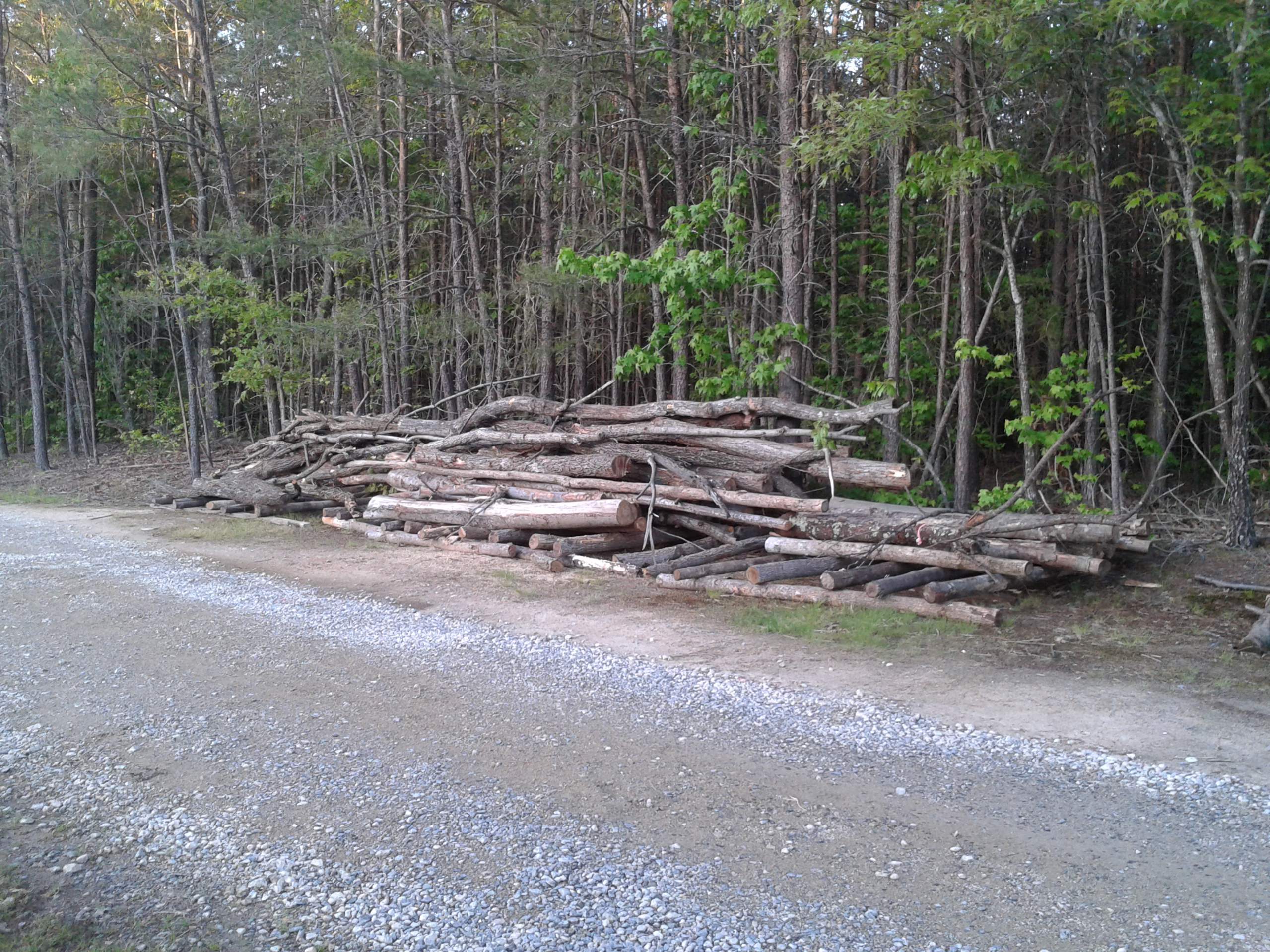

Here is my first atempt at a Bucking area...
I tested it with a handful of logs and it went well, now I'm moving the entire pile of bigger limbs and trunks out of what looks to be my 2nd pasture area and into this area. There are still a few more in the "pasture" and TONS out in the forest I need to haul in...
Any thoughts? I am very open to advice.

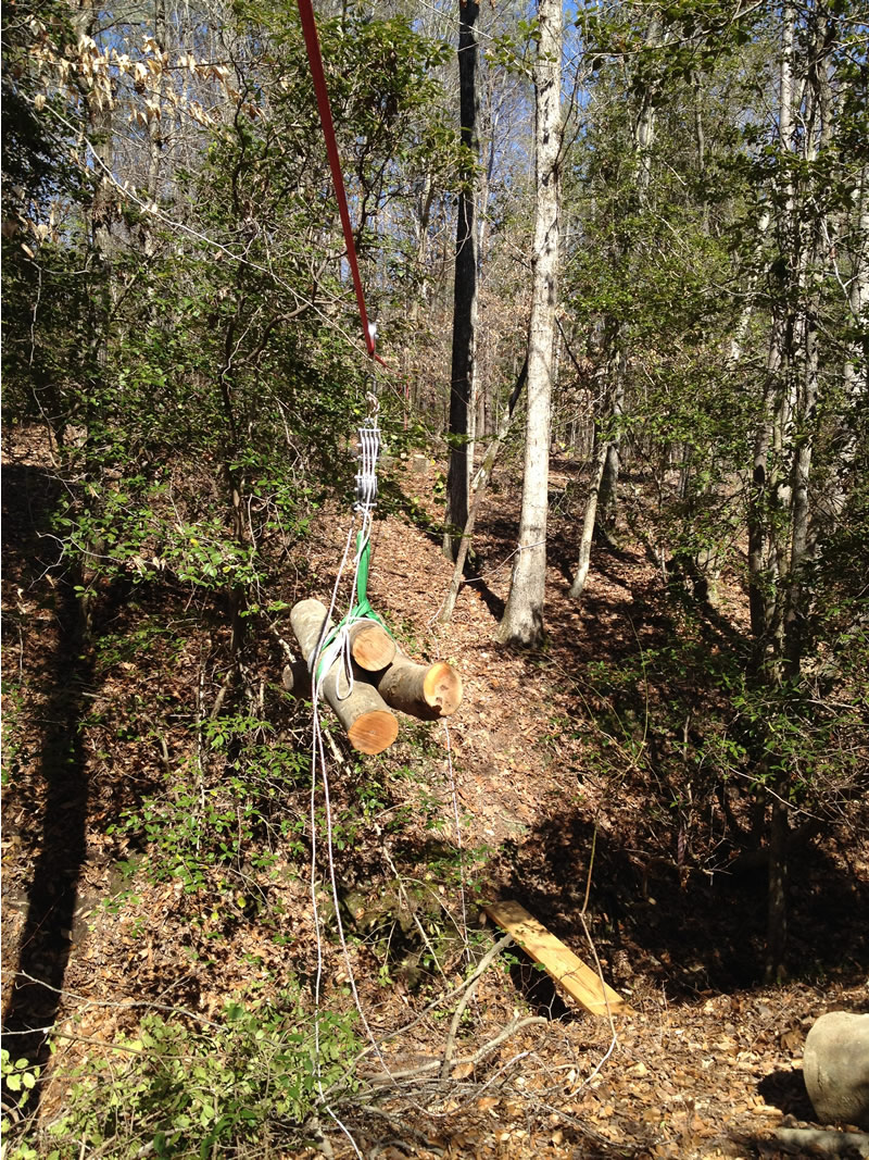

My recent log conquests have been a giant 24" beech that came down in Irene, and a bunch of smaller beeches, maples, gums, and poplars. To get the big beech out, I had to get the logs across a stream bed using an overhead line. I basically strung up my 16,000# 200 ft tree rope across the stream and used a come-along to tension it between two trees on either side of the stream. Then used a snatch block riding upside down on the rope like a trolley, and a hoist hanging from the snatch block to lift the rounds (had to keep them at 4 feet long for easy handling). That was a heck of a project, but it was a lot of good firewood. Beech is among the best you can burn. I got over 1/2 chord out of that one tree.

Holy sh*t... that is some dedication right there! Awesome ingenuity. Or maybe you're just crazy. :laughing:
