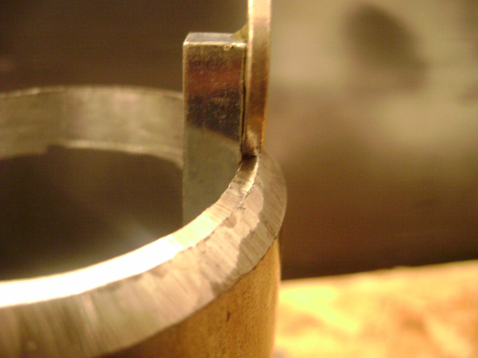

I don't have any pictures of how I like to prep my joints for open root welding. I do for Tig welding, but not stick. Here is a picture of how I like to prep for open root with backing plate, this is vertical up with 1/8 inch 7018. For open root stick welding plate or pipe, I like 37-degree bevel, with 1/16 inch gap using 1/8 inch rod. Now the land, (root face) depends on which brand of rod I'm using, it can vary from 1/16 to 3/32 inch.

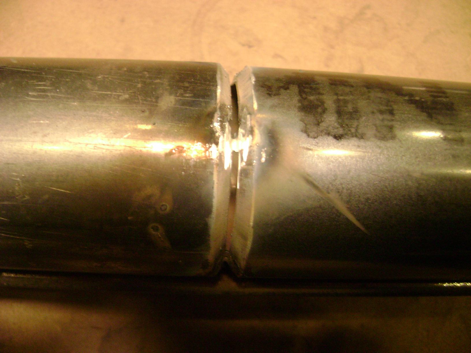

I did find these.
