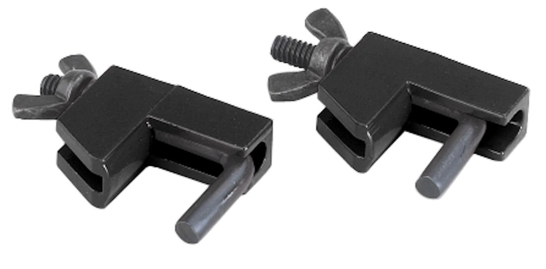

Probably already mentioned several times in this thread... these can help with the fuel mess when changing filters. Work a little better than my small vice-grips.
https://www.amazon.com/gp/product/B002YKHRUK/ref=ppx_yo_dt_b_search_asin_title?ie=UTF8&psc=1
Simple solution on fuel filter change for stopping flow of fuel.. Install a valve ahead of first filter like I did. Secondary plus is use it if tractor is unattended to prevent theft.
Ron
