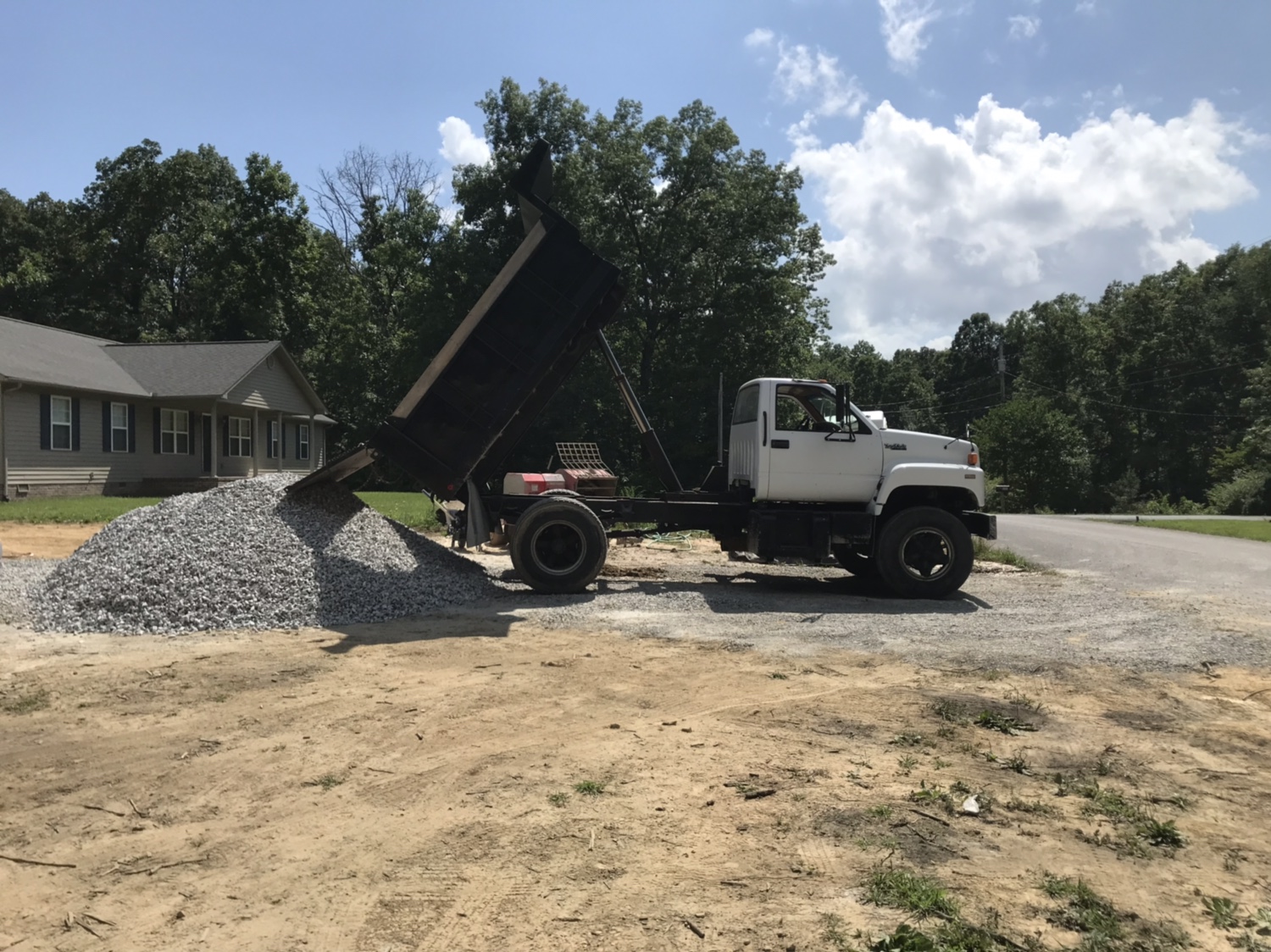

Have you done the math on the hauling it yourself vs paying it done? A tri axel dump is going to haul at minimum 4 times what your truck is. Maybe more if you’re only hauling 2 yards although it’ll handle more. My topkick dump truck will haul about half what a big truck will and I’m only saving about $30-40 a load after fuel is bought. It’s not worth that to me to deal with it myself. I only hauled these loads because the other trucks were tied up longer than I wanted to wait. IMG_6987.JPG
