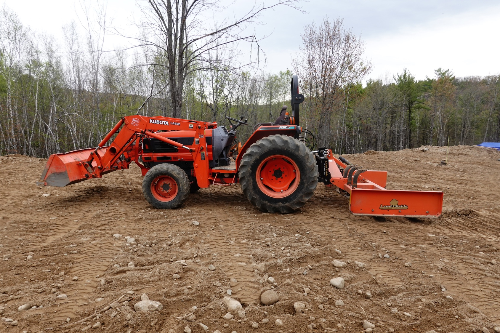

I will need scarifiers for my particular driveway, I think. Right now I'm using a beat-up old Gannon roll-over box blade...
Doesn't the Gannon have scarifiers? My Rhino Ag roll-over box blade has 3 positions, pull, push or use scarifiers & pull.

I've had both, you want adjustable cutting edges. I currently have an EA and it's lack of adjustability is a point of frustration for me. They work much better when you can adjust the cutting depth. Also the cross tube part of the frame isn't high enough above the leading cutting edge so it plugs up easily.
Everyone is going to tell you to just buy a hydraulic top link, that does not solve the problem.

My Woods land plane has adjustable skids. They're useful for enabling the outside edge to dig more to help set a crown, and to control the overall amount of cut. My tractor has a hydraulic top link, but with well-adjusted skids, it's so much easier to drop it to the ground, and have it work perfectly, without fussing with the topping lift every time I go over a crest or dip in the driveway.
