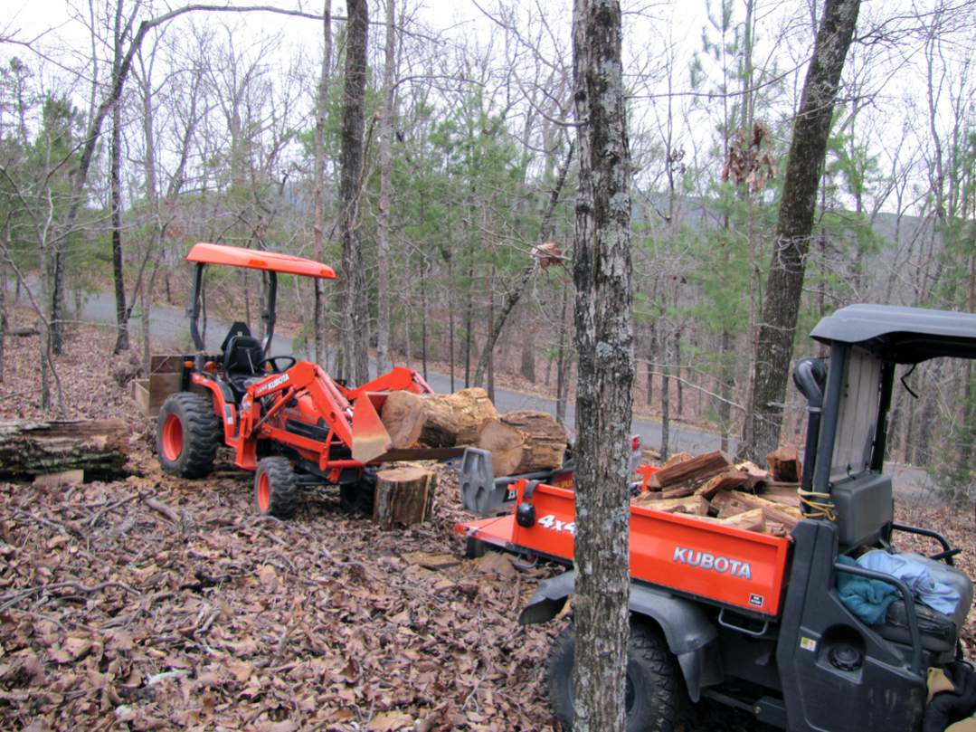

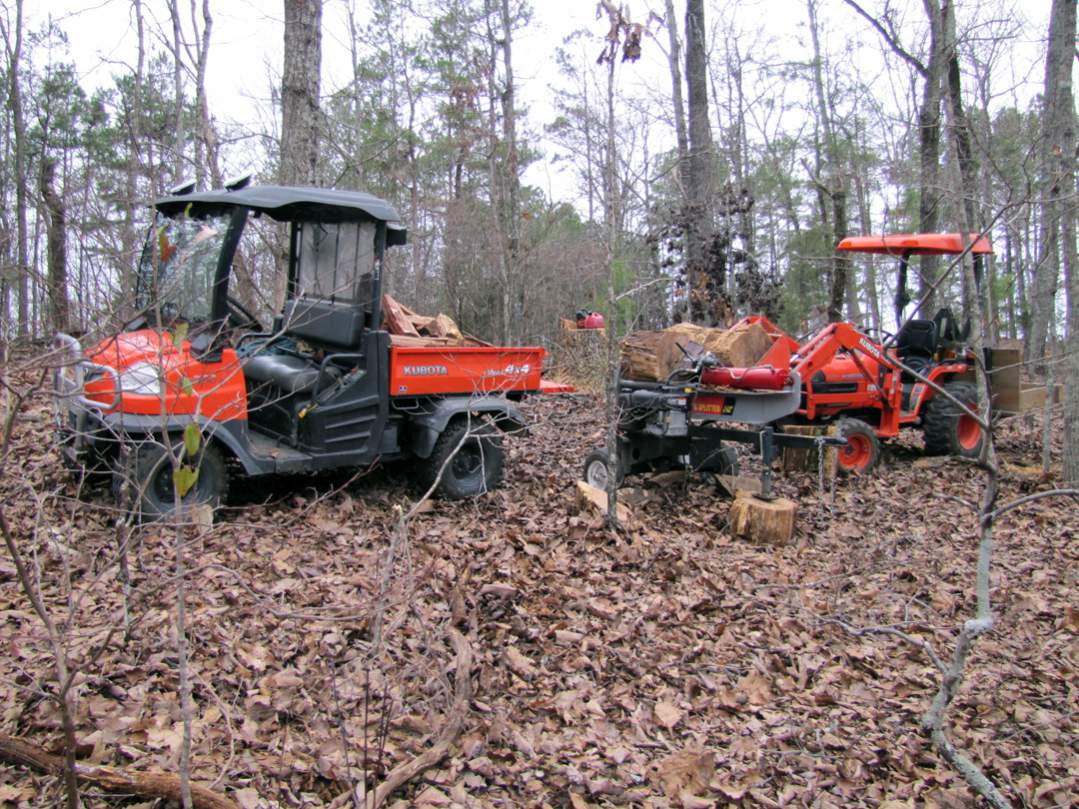

IMG_2309.jpgIMG_2307.jpgJust dropped a red oak that has been standing dead for a couple of years now. 38" dia at the base where I cut at 4' or so. Split on the spot with my splitter and it produced perhaps a bit more than a rick, 4X4X4'. The outer inch or so was rot in several places; but due to the capillary action all of the heart and sapwood were totally soaking...........Will probably burn it next year or maybe the next. Right now I am burning 2 year old stuff and often, depending upon the species and tree, some burns really fast and other types slowwwww.
For me, I just make sure that I am able to close up the stove damper and give it enough air, a Harman TL300, so that it burns properly and the pipe gets hot enough NOT to creosote. I still use a dose of the Rutland creosote remover stuff EVERY Monday.
The pic is splitting up the above mentioned tree. I use my tractor bucket to hold up the rounds while I work on them........God bless........Dennis

Nice toys!
