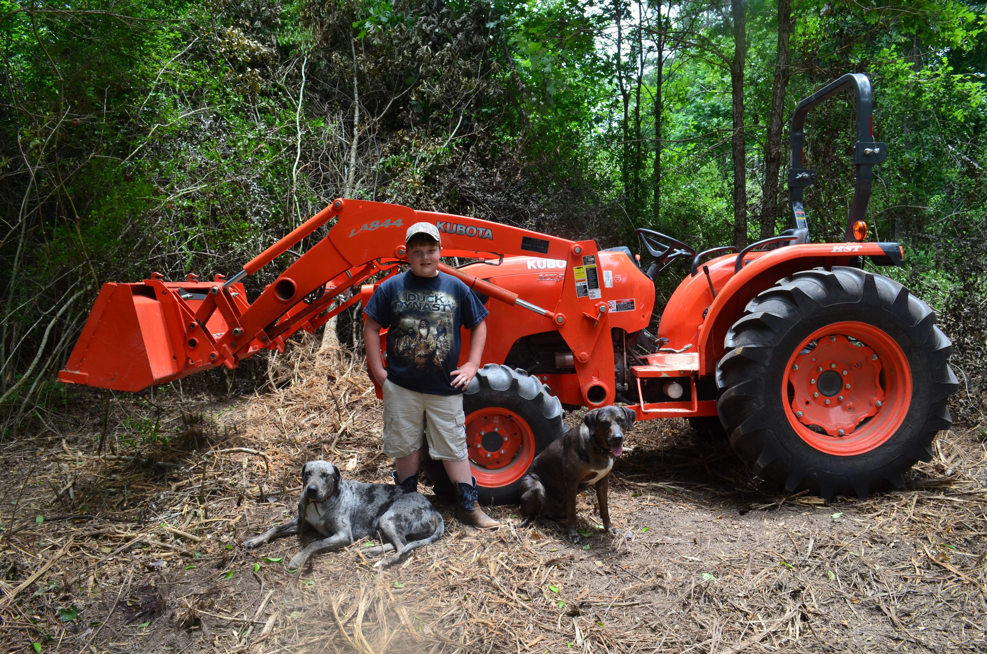

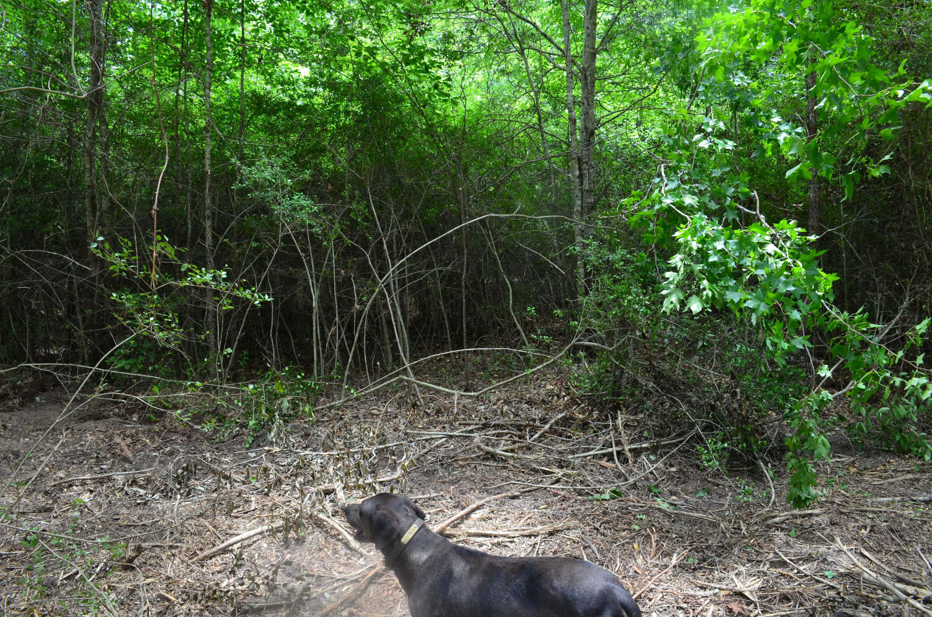

   / Does anyone have a 4 in 1 bucket?
Here is a pic of me and my rig and a pic of what I am trying to clear. wolc 123 that is exactly how i want to use it. Have beeen studying up on buckets and i am leaning towards the Bradco 72 Compact Tractor 4-in-1 Bucket.Is there a better atachment or way to clar this ?

The problem with a 4-in-1 bucket on a CUT like the MX you have is that you're not gonna be able to close the bucket on them and pull them up if they are of any size at all unless they have a very shallow weak root structure. Notice that wolc123 said he did that with a payloader, which is a bird of a different feather.
And the problem with using a brush hog to do it is that you're going to leave all those little trunks sticking up about 2 - 4" above the ground. While a brush hog with dull blades will pulverize them enough that they don't become punji sticks that will stick through a tire, you'll be tripping over them every time you walk through the area.
If it was me, I'd rent an excavator or I'd hire a dozer to clear it.
