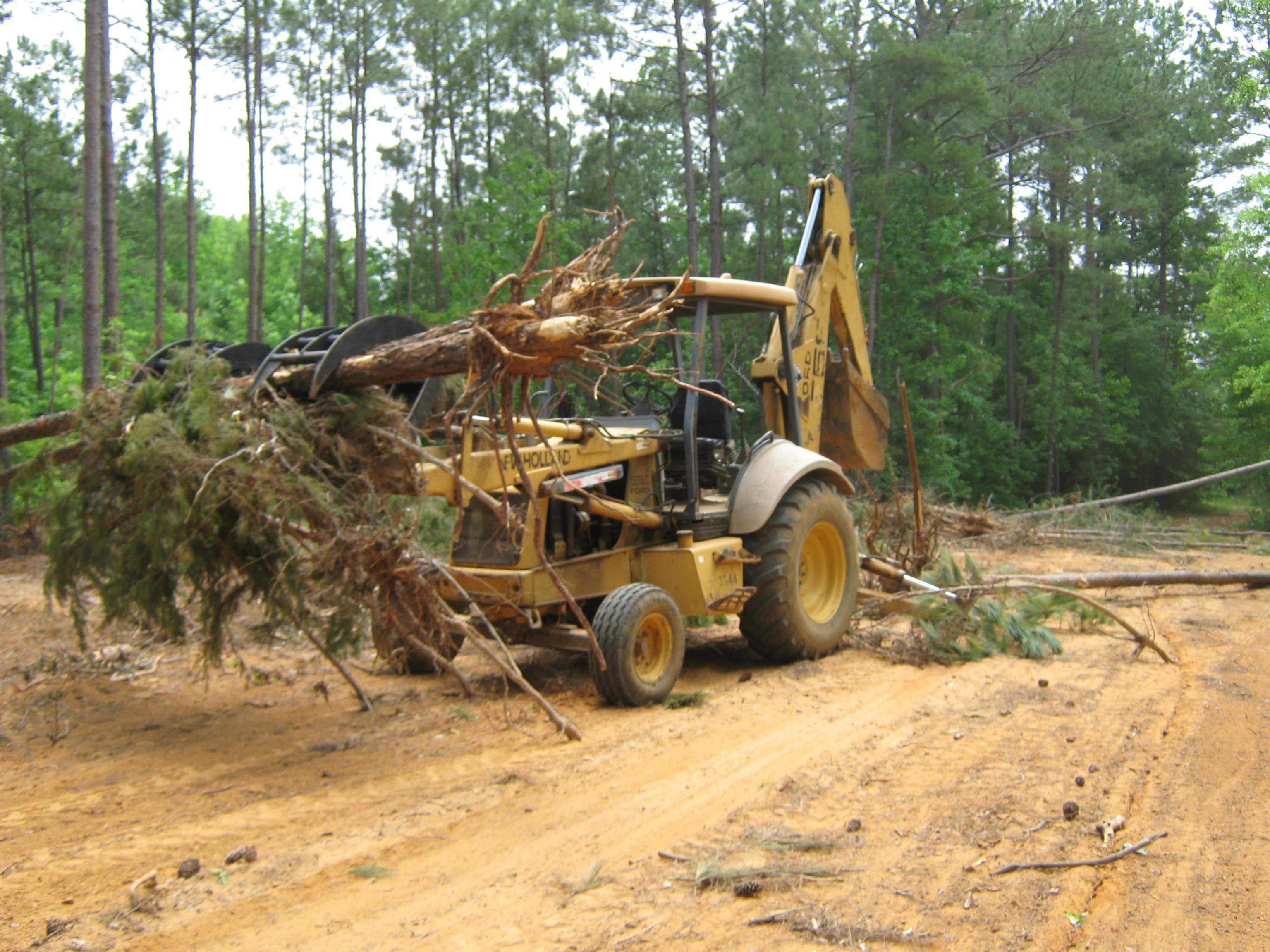

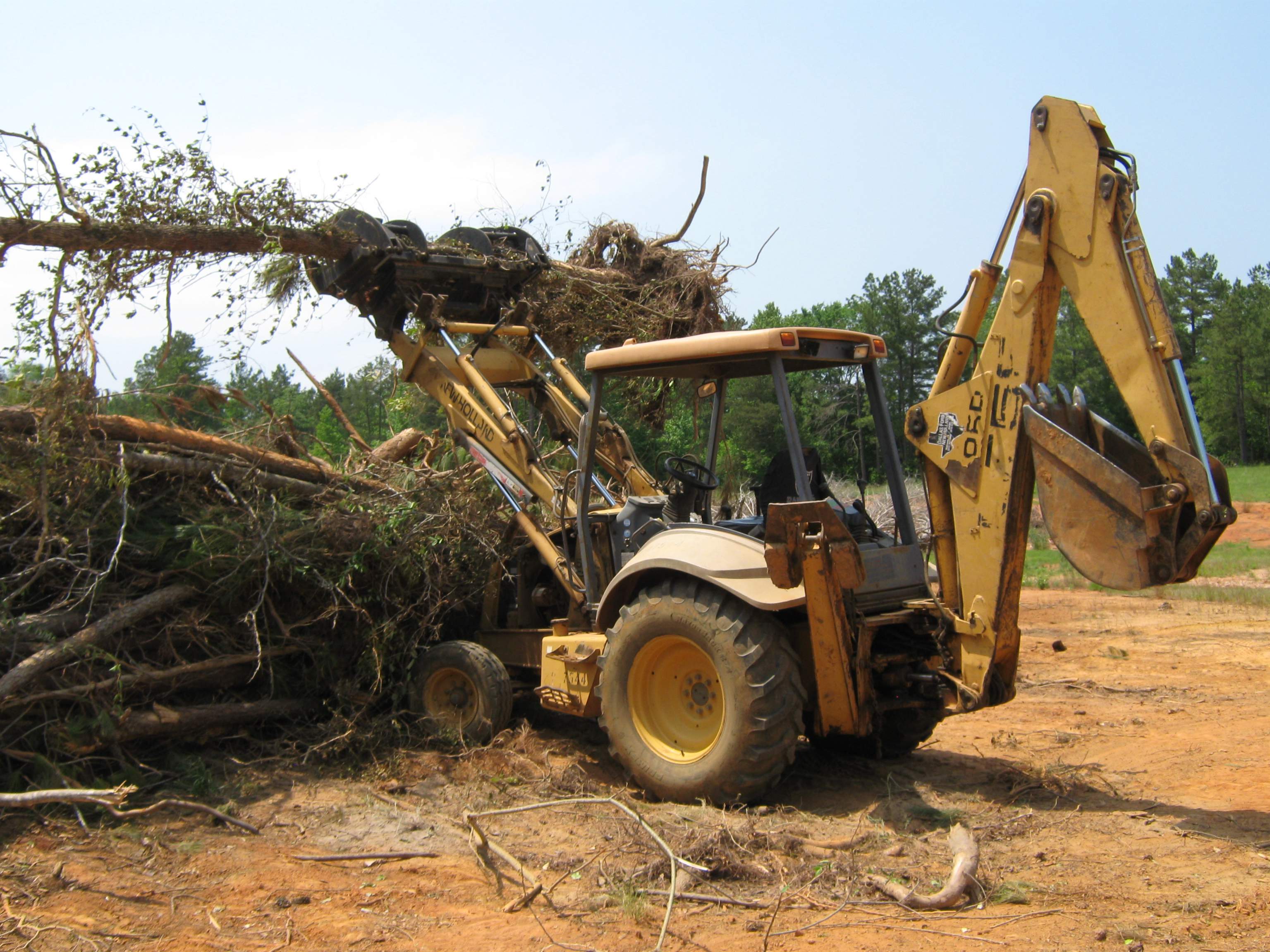

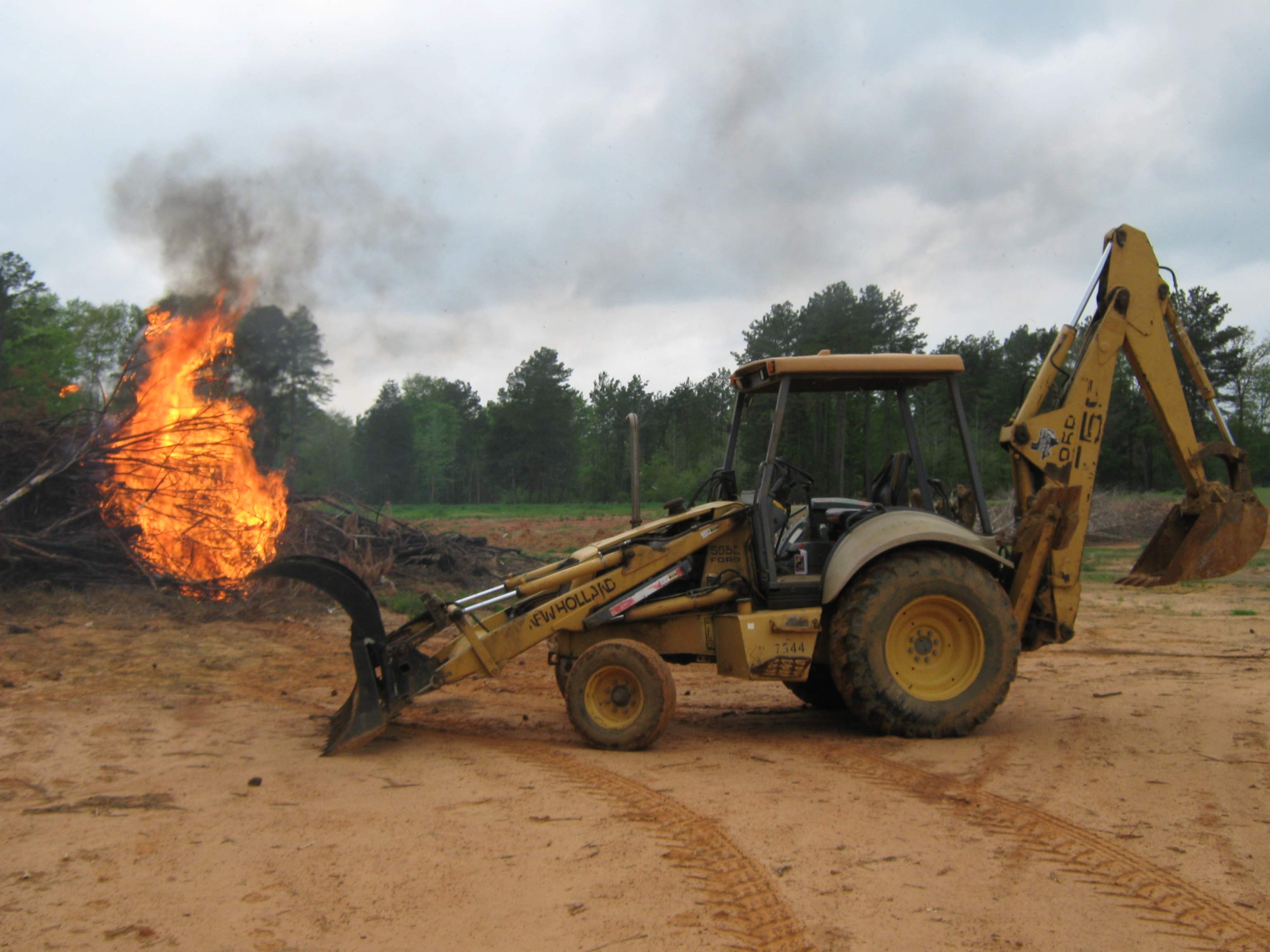

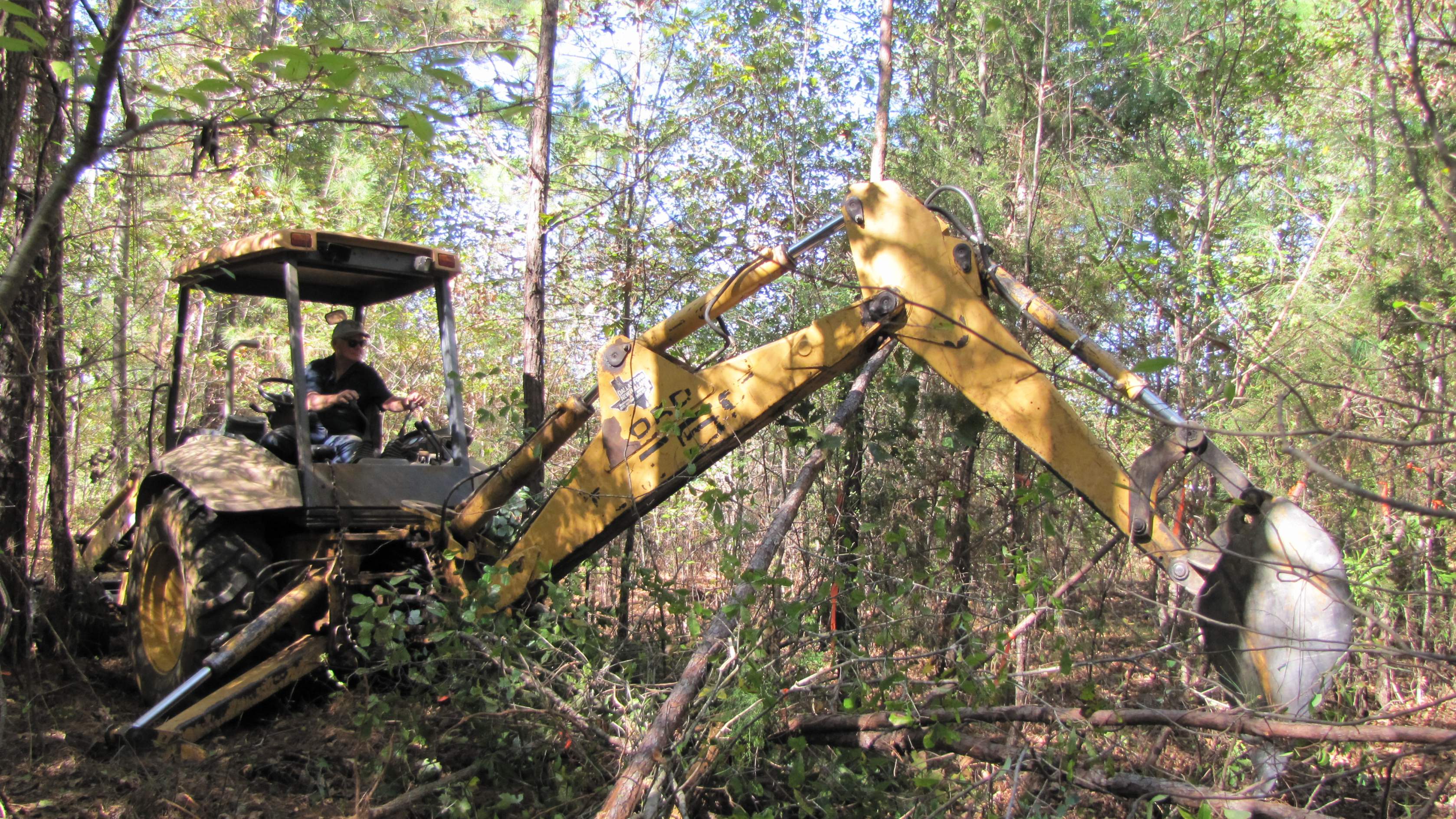

I own a 170 hp dozer that I learned the hard way is the wrong tool for clearing land. It's a lot of fun pushing trees over and going through everything, but even with a rake, it's very time consuming cleaning up the mess it creates. If you use a dozer, you really need something else to come in and pick up the debris and carry it to the burn pile. I put a grapple on my full sized backhoe to do this and the speed and end results are night and day to just using the dozer. My burn piles are not full of dirt and they burn everything including stumps completely. Once I get it going, the coals get so hot that I can put an entire tree on the pile and it's completely gone by the next day!!! I've also found that I can take out bigger trees faster with the backhoe by digging down on either side of the tree, through the roots, then pushing it over faster then I can with the dozer. For smaller trees and saplings, it's just a lot cleaner to push them over with the hoe bucket, then slide them towards the backhoe and pull them out of the ground, roots and all. Doing it this way does not disturb the ground and there is no need to smooth it out afterwards. Then I puck them up with the grapple and carry them to the burn pile. Fast, clean and easy.
The ultimate land clearing tool is an excavator. Unfortunately it's terrible at getting the debris to the burn pile, so you need another tool to do that. Which is the same problem that you get from using a dozer, but you tear up less land with the excavator then you do the dozer. The dozer just tears everything up!!!! The best single, all purpose tool is the backhoe. At 80 hp, it has enough power to take out any sized tree and enough lift to pick up most of the trees out there. Sometimes we have to cut up a really big tree into thirds, or even a few more pieces to get it to the burn pile. Sometimes we just wrap a chain around it and pull it to the burn pile, then push it up onto the pile to get it to burn cleanly. If I hadthe money, I would buy a cabbed 4x4 backhoe with a 4in1 bucket to clear land instead of my 2 wheel drive, open cabbed backhoe. But for under $20,000 you can get what I have and do it at your own pace, then sell it when you are done, or realize you can't live without it and keep it.

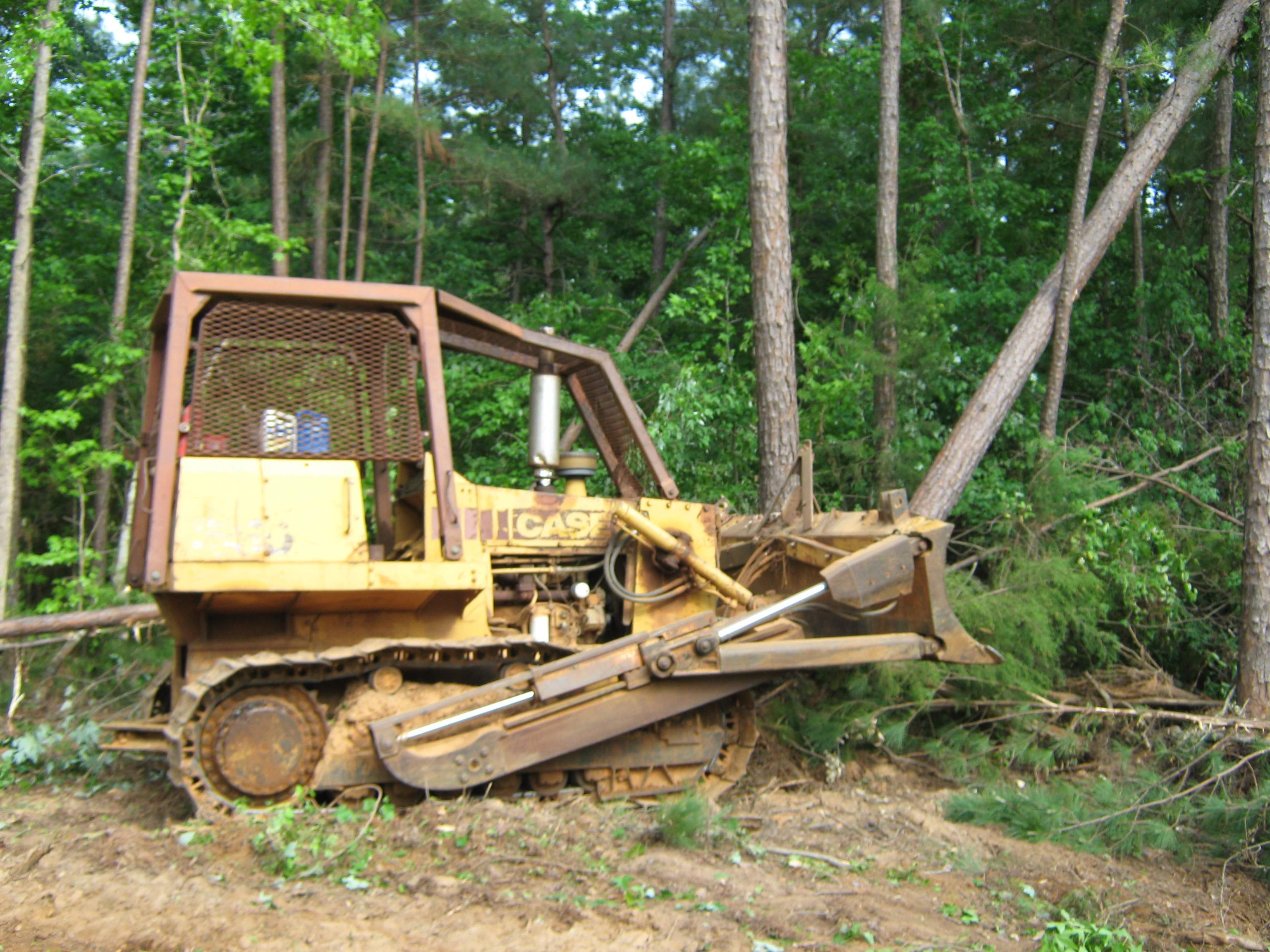

Eddie
You have a big Dozer. 1150 right? In my opinion those are great for moving a lot of dirt or pushing a kg plow. That wouldn't be my choice for clearing his type of property. A JD 450j or case 550 or 850 with a 6 way blade make short work of this. Once you get all the youpon out, I roll it and get the dirt out. I cleared my place that way and all that's left is a mound where all the ashes are. It's hard to beat a Dozer underbrushing then have the track hoe or backhoe come and dig the bigger trees that are left. Ive tried clearing out youpon in a few small areas with my grapple and I'm sure it's mostly my inexperience with it but it's a pain. Hard to get under the roots with out cutting them and leaving speers
I have another experience with clearing trees with a dozer. I guess not all dozers are created equal. I think the 6 way blade is the key. The guy would stick a corner of the blade under the tree, lift it up and then push severing the roots with the blade leaving most of the root ball in the ground. Then back dragging smoothed the ground. When he had several trees out he pushed them on a pile. When he was done I had about 30 acres of more or less smooth ground with some roots sticking from the ground. It took me about a week to chop them off or pull them out with my tractor so I could prepare the land for planting.
That's how we'd do it. Use the the corner of the blade and roll it. For a real finished product the Dozer can go over it again with a rake and clean it up more
