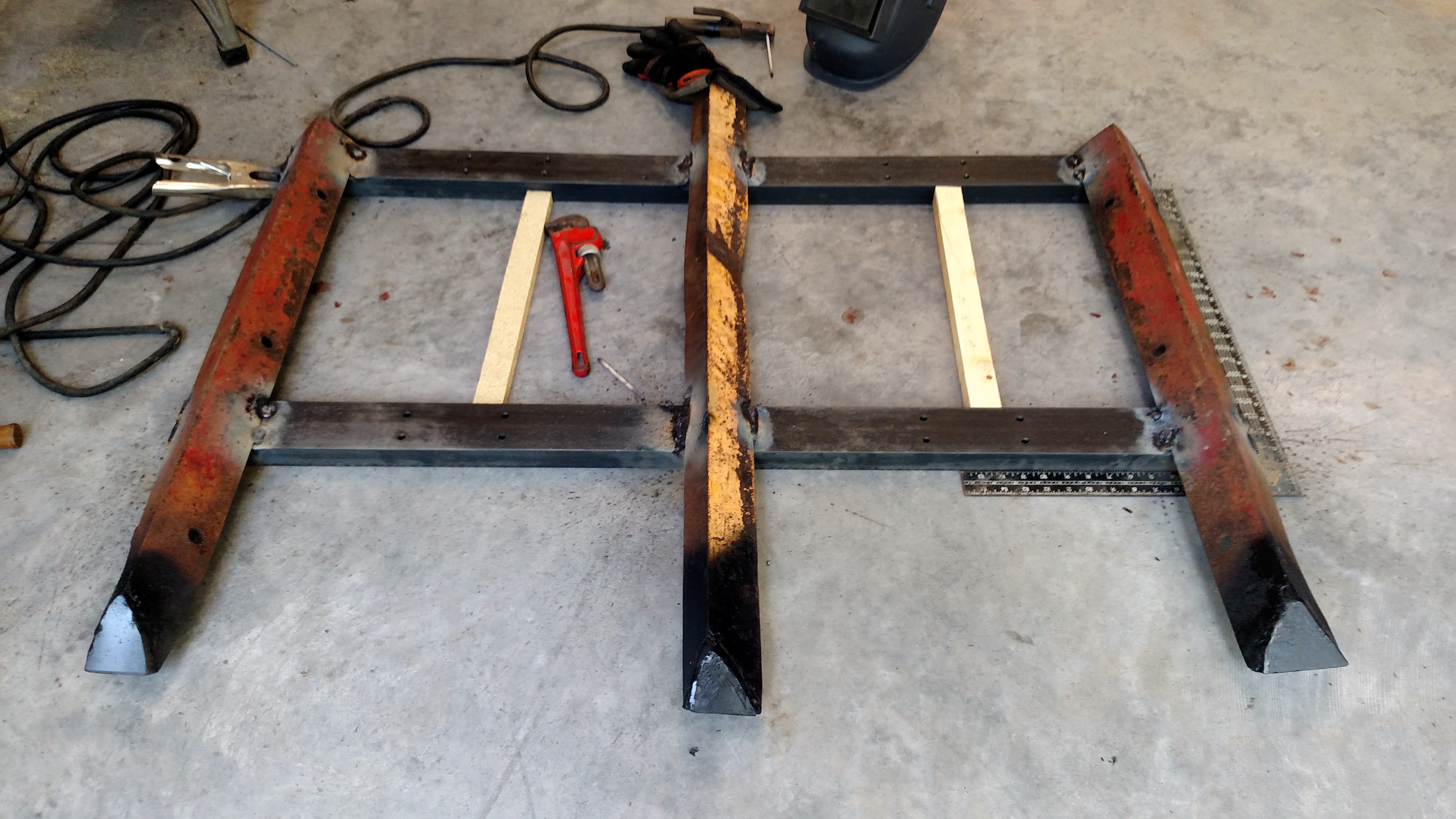

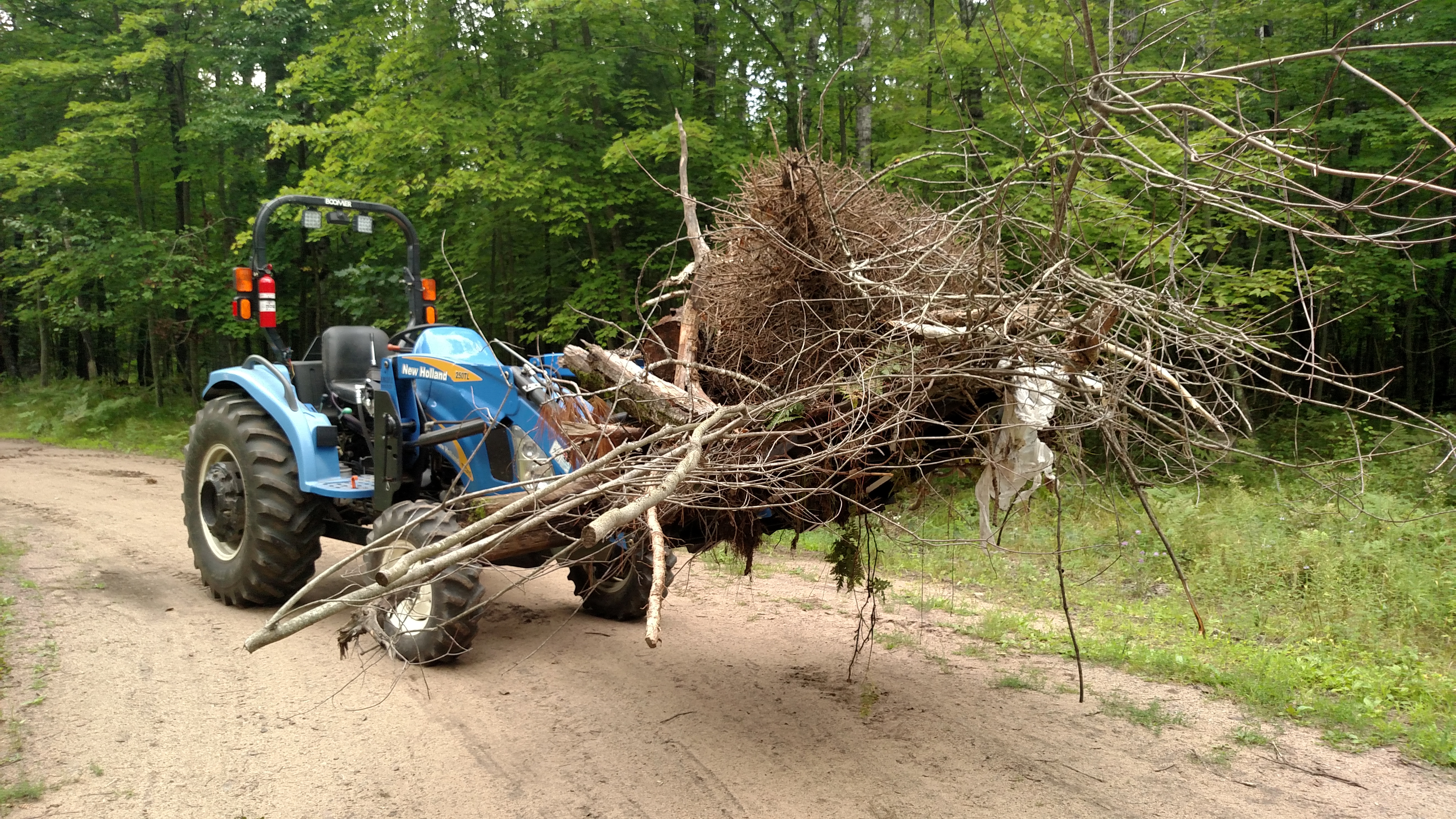

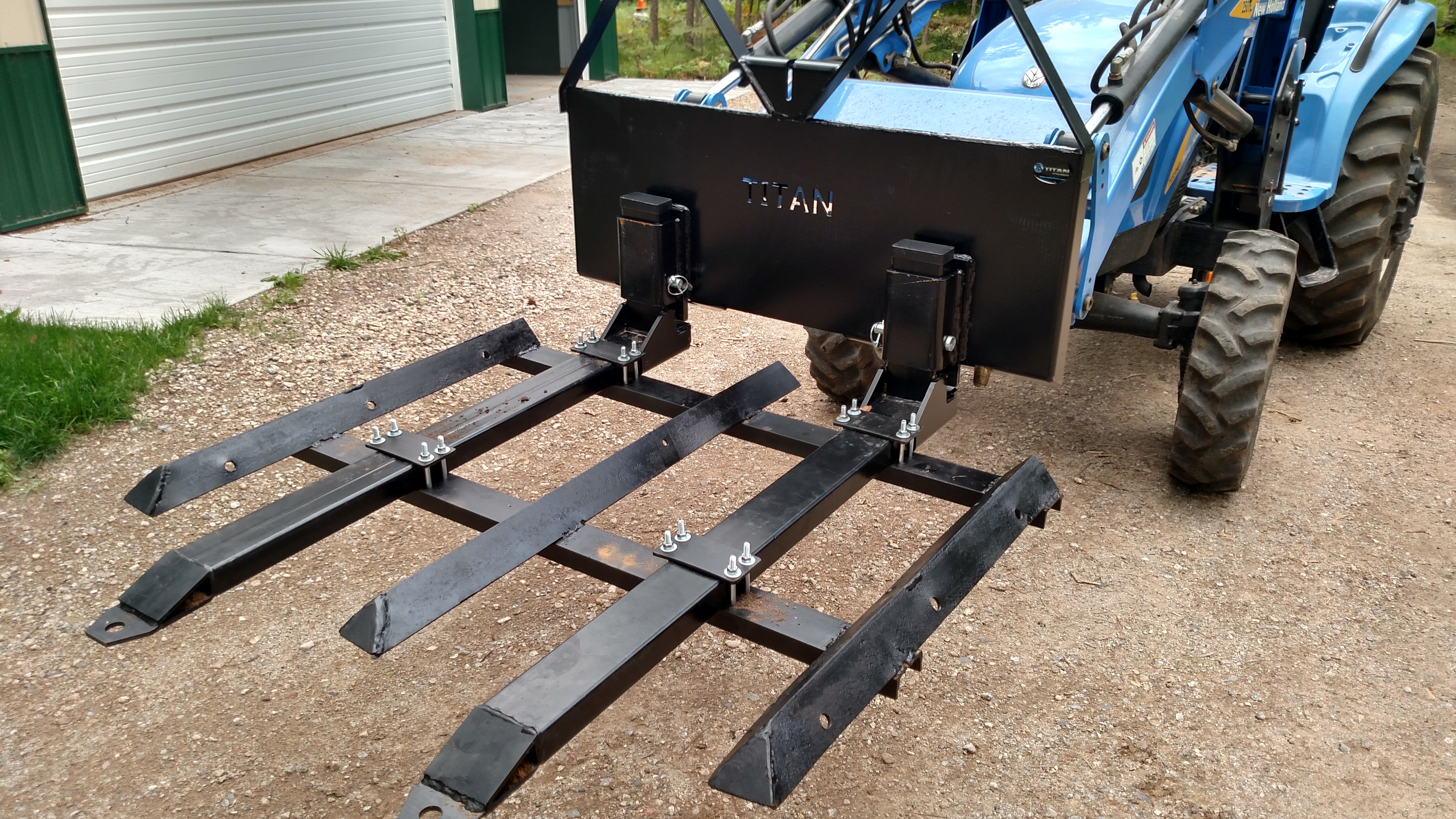

Here's how I made a bolt on attachment to my forks to convert them to a debris fork.
