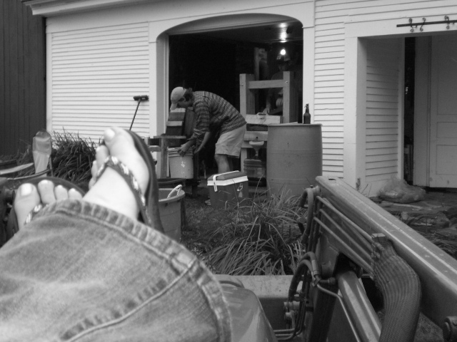

   / Does anyone make apple cider? #37
I'll post some pics of our rack and clothe press. We make about 150 gallons of hard cider every year. The trick is clean apples and monitoring the sulfur content and increasing to kill existing bugs and yeast. Than after a day use a nice cultured yeast. Any brew store will have good yeasts to use most often the Redstar yellow is used. We like the Lalvin K1-V1116 or Killer 1 as well. Remember that oxygen is the enemy so keep it air-locked and pour into in CO2 flooded containers if possible. The best apples for hard cider are not good apples for eating. Bitter, sour, dry and ugly make the best. Some people say that the "hard" in hard cider does not refer to the alcohol but rather the hardness of the little apples used to make it. If you want a sweet product eliminating all yeast in the racking process is necessary so that added sugar does not ferment. If you like a dry product that is fizzy then ferment until there is no sugar and at bottling add about 2/3 cup of sugar for every 5 gallons. Careful though, it will pop about like champagne. Wow so much to write... Annie Proulx wrote a great book about cider making a long time ago. Even though she has since written some horrible garbage, the "Cider and Cider Making" book is well worth it.
   / Does anyone make apple cider? #38
Wife's toes on the 4310 looking at the cider operation...
