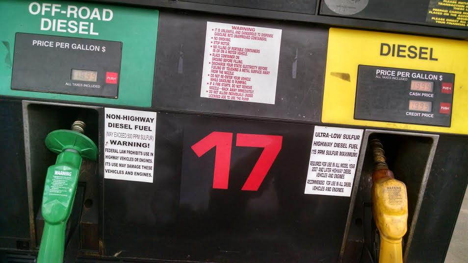

In our location the off-road diesel pumps are marked as having higher sulfur content than the regular diesel...
I went to our local station this morning just to verify what I thought I remembered from earlier fill-ups. Attached is a photograph of the two diesel pumps: the highway diesel states a "15 ppm sulfur maximum" whereas the off-road diesel has a note that it "may exceed 500 ppm of sulfur". Not to start an argument but highway diesel and off-road diesel differ than more than the addition of dye... at least in my area.
YA, this is the way I always thought it was, in logging areas. Quite a few people say it is not true, but a picture is worth a thousand words.
466967d1462120123t-does-anyone-use-fuel-additives-diesel-pumps-jpg
The nationwide standard changed to 15ppm after 2014. EPA Diesel Fuel Standards
After 2014, all nonroad, locomotive, and marine (NRLM) diesel fuel must be ULSD, and all NRLM engines and equipment must use this fuel
He just left the old decals on his pumps. Or possibly he hasn't received fresh fuel for over a year.
that's what I understood too.. Everything is low sulfur,( on road & off road) but I couldn't argue with his pic
It has that sticker because it "may" contain up to that amount by law. In reality it probably doesn't cause they do not produce two fuel runs. But there was certain smaller refineries and old stock that lasted until recent with the old fuel and could sell it as offroad. I bet if you had the fuel analyzed it both would be the on road spec.
I could be wrong but I highly suspect that's the case here.
I am a forester. My main job is running loggers on timber sales. The next town from me is a small logging town in Ga. I think there is something like 17 logging crews that run out of the area and there two stations they buy all on and off road fuel from (town of like 3000). Everything is ULSD on and off.
